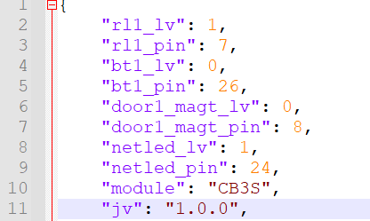

Sample Tuya configuration JSON with various parameters.
Automatic Tuya JSON extraction allows you to automatically configure the GPIO template of your smart device. Unlike in Tasmota, where all GPIO probing has to be done manually, OpenBeken flasher BK7231GUIFlashTool is able to extract the Tuya GPIO roles, so it can automatically tell which pin is used for relay, which pins are used for PWMs, which baud is used for TuyaMCU, etc.
The usage of this feature has been presented already in our video:
Today I am going to show you few more details about the Tuya JSON inner working.
Let's start by considering a sample JSON:
This is a description of a simple 6014HA device, featuring a single relay, WiFi LED and a button.
The most important keys here start with "rl1_", "netled_", and "bt1_".
The "rlX_" prefix stands for relay. There can be multiple relays, so X stands for the relay number.
There are multiple keys for relays:
Code: C / C++
The "lv" key stands for active level. Value 1 means that relay is active-high, so relay is closed when the given GPIO has high level.
This is a standard for all Tuya products so we are not even parsing that.
The more important key is rl1_pin, which is a GPIO index of Relay pin. 14 there means that relay is on P14 (not on the 14th pin of QFN case).
The same logic applies to buttons. There can be also multiple buttons, for example, bt1_pin is a GPIO of a first button, and bt2_pin is a GPIO of second button. Futhermore, there can be also LEDs following relay states, so led1_pin, led2_pin, etc is possible.
Of course, most of IO roles are not numbered, for example, status_led_pin. Here is more detailed list of Tuya JSON keys:

To extract Tuya Config JSON from a live device or from 2MB flash backup, use our flasher:
To decode Tuya JSON, you can use our online utility:
https://openbekeniot.github.io/webapp/templateImporter.html
For some sample Tuya flash dumps, check out flash dumps library:
https://github.com/openshwprojects/FlashDumps
As you can see, Tuya JSON decoding can make "cloudless" conversion of your Tuya device much faster and easy than it was in case of ESP8266/Tasmota devices. Most of the related GPIO roles are included in JSON, so you don't have to guess anymore. Futhermore, OpenBeken can automatically convert Tuya JSON to a template, so all you have to do is just to copy and paste the extracted text.
