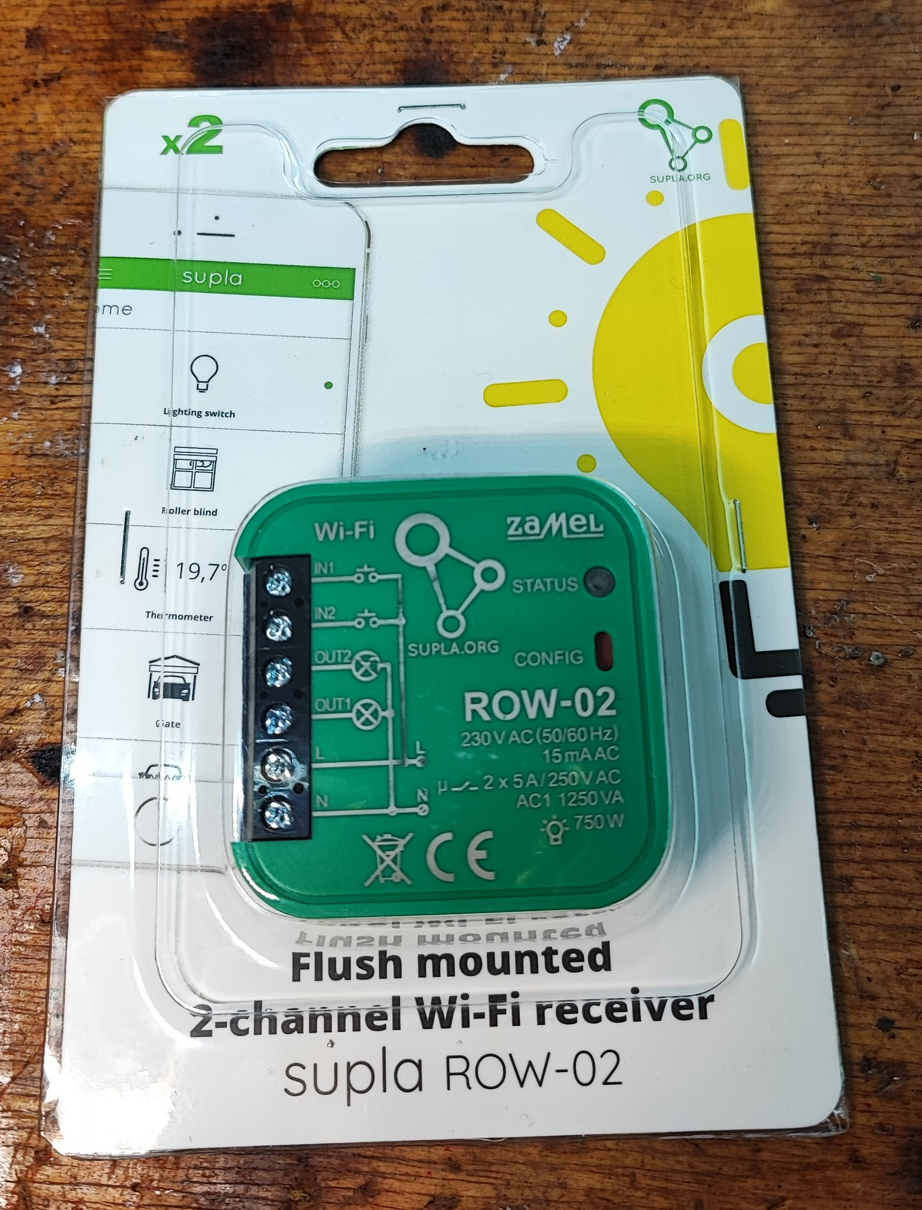

Today we will take a look inside another IoT gadget, but this time working with the Polish Supla system. We will see how it is built, how the power path is realised, what WiFi module is inside and, in addition, we will try to pair it with the Supla cloud and maybe back up its firmware too. We'll see.
To start with, the product seems to be quite expensive:
So what do we get for a whole PLN150?
Including a Polish-language manual:
Here is the gadget itself:

This particular module (ROW-02) offers two channels and can control two lights.
Of course, you can choose their icons, names, etc.
