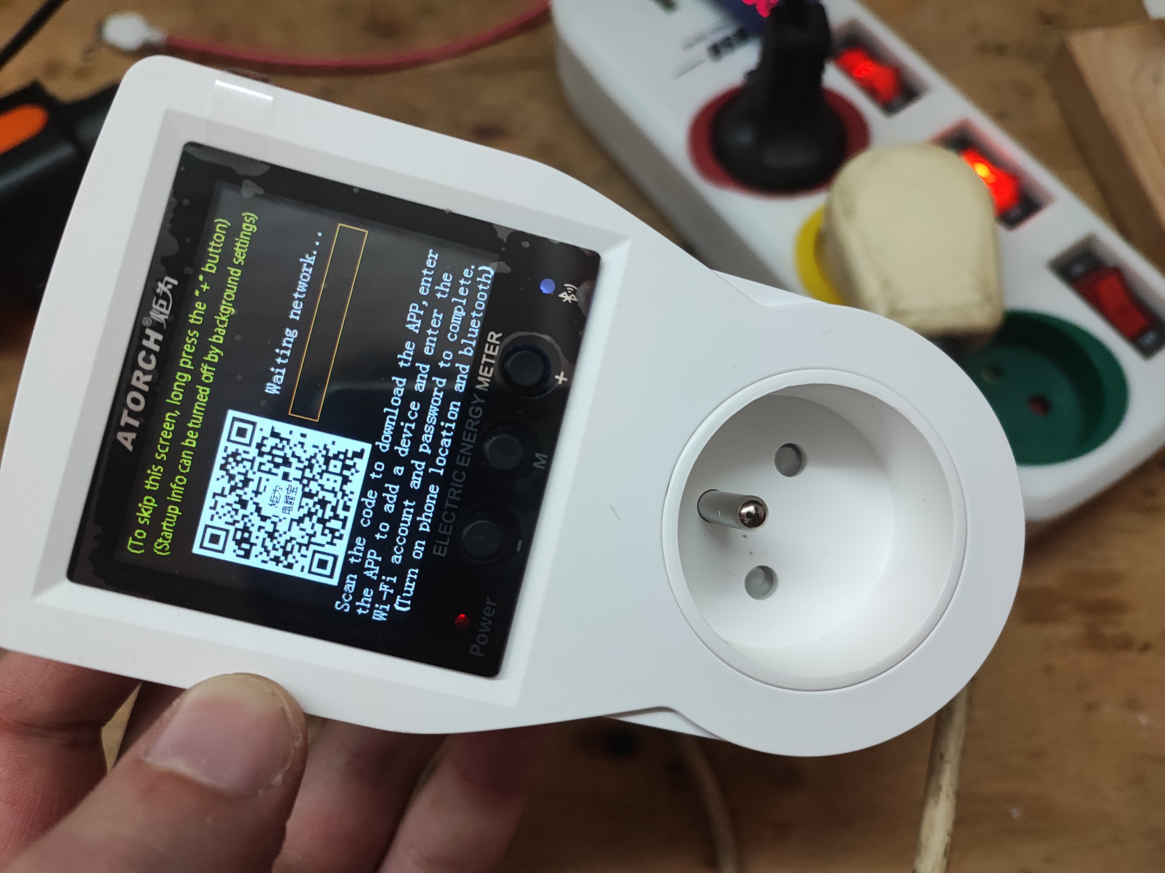

ATORCH electric energy meter with an LCD screen, waiting for network connection. .
Here I will show step by step how an advanced energy meter/thermostat with LCD screen can be converted so that it can operate 100% locally, without the cloud and without the manufacturer's servers. I'll be converting the S1TW-FR discussed earlier here, to do this I'll upload OpenBeken to the WiFi module and configure it accordingly to communicate with the TuyaMCU on board.
It is worth reading the previous section here, where I showed pairing this meter with Tuya:
Energy meter/thermostat with LCD - S1TW-FR - first impression, Tuya application .
By the way, let me once again remind you of the collective topic about TuyaMCU:
TuyaMCU flashing, installation and configuration guide - configure dpID for Home Assistant .
This topic assumes the reader's knowledge of TuyaMCU.
Plan of action
To free this device from the cloud the following steps must be taken:
1. disassemble the device
2. intercept the UART communication (TuyaMCU) separately for each operation in the mobile app. This step can be replaced when using Tuya API .
3. soldering the WiFi module to upload OpenBeken via UART
4. configuration of OpenBeken based on the acquired TuyaMCU dpID data
I will try to describe each of the steps here.
