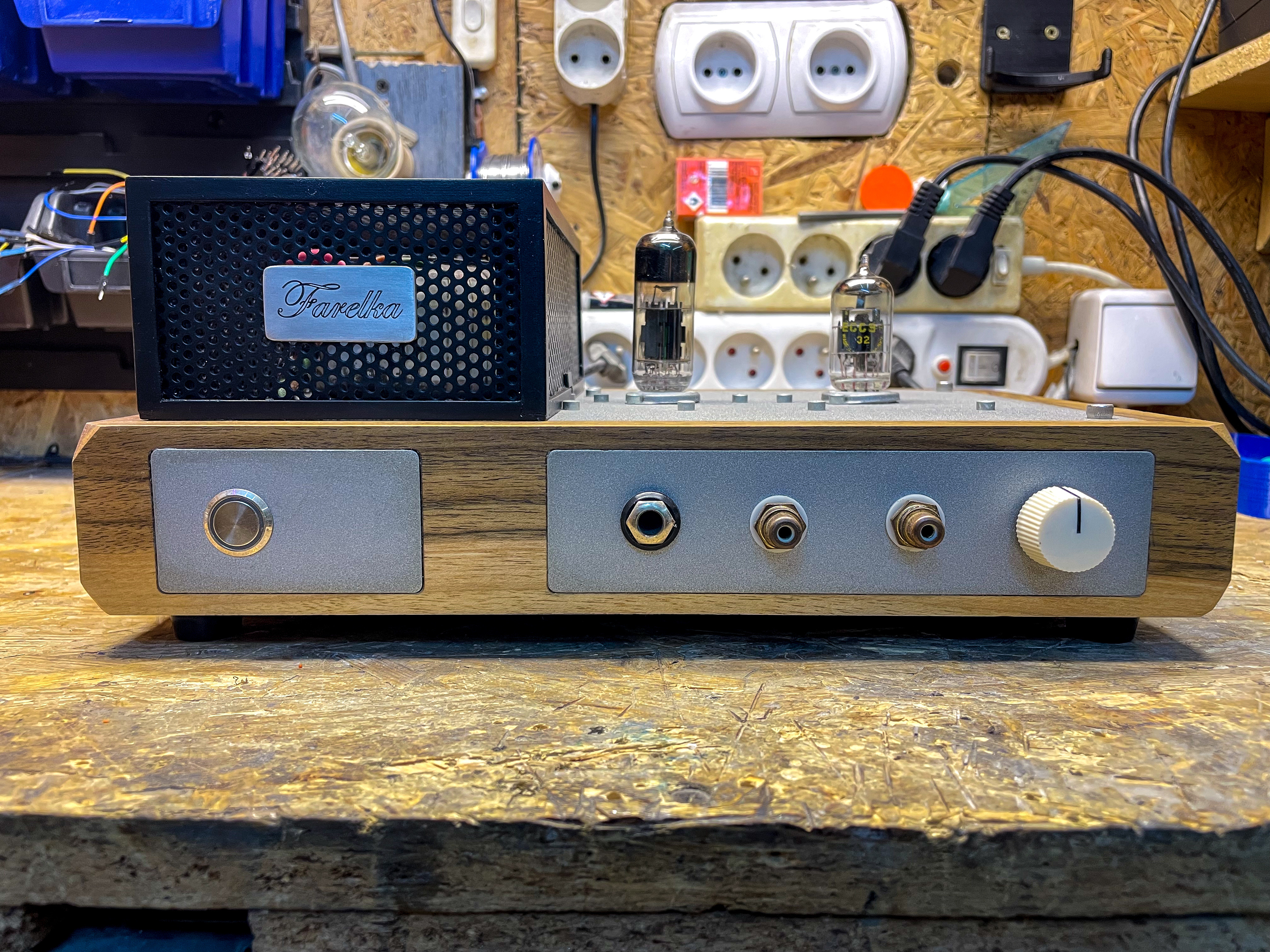

Hello to all enthusiasts of home tube designs! I come today with a headphone amplifier project using ECC88 and 6N6P tubes. This amplifier was created to drive the Beyerdynamic DT990 Pro headphones, which, as befits studio headphones, have a sizable impedance (250 Ω). It was one of the longer projects, due to the fact that I am still a beginner when it comes to electronics, and also because I was implementing solutions that were completely new to me at the time. It is not a perfect design, and unfortunately it is not universal either, because the impedance that this amplifier can handle should not be lower than 250 Ω (due to the design of the output stage), but for my applications it is ideal.
I built the amplifier using components I had in store, i.e. transformer, tubes (although initially there was going to be a second 6N6P or 6N1P in the control stage, but I got a couple of ECC88s from a friend). As the power transformer had limited capabilities (200 V AC and 100 mA), it fell to a 'simple' cathode secondary for the output. Had I had a transformer with higher maximum currents and voltages, I probably would have opted for a White's secondary, but alas :) .
There was a lot of news in the power supply, as I decided to implement active filtering with a gyrator (which in the end was not particularly necessary) and a capacitance multiplier. The control stage on the ECC88 is a typical circuit, without any miracles, except that it has a balance potentiometer in the cathodes of both tubes (not the best solution, but it works). Much more (in my opinion) happens in the final stage. The 6N6P tube acts as a cathode secondary, however it is not a typical secondary as the cathode resistor has been replaced by a current source on an NPN MJE340 transistor (now I would do it on a MOSFET). The current sources are powered by a separate power supply with a built-in base voltage turn-on delay (set to 15 seconds from what I remember). Each source has a precision potentiometer in the emitter to set the current, so that the current of both halves of the tube can be set perfectly. Because the voltage at the 6N6P cathodes exceeds the maximum heater-cathode voltage, I used an elevation voltage that is 40 V. I took a lot of information and inspiration from Mr Merlin Blencowe's books. I attached the MJE340s to the chassis because they heat up a lot, and that's why the name "FARELKA" came about, because the amplifier can get ;) (but of course within the norm).
I made the enclosure from walnut wood and aluminium, which I cut out using CNC. The screw mounts, the transformer 'cage' and some other parts were printed on a 3D printer. I placed the amplifier parts on a turret board, as I am a fan of this technique. I have tried to keep the interior as neat as possible, but that is for you to judge. I like it.
As for the sound - in my opinion it sounds brilliant. You can't hear any noises (when I first fired it up during testing and heard nothing in the headphones, I was sure it wasn't working. All I had to do was turn up the volume control). I'm not an audiophile or anything like that, but the amplifier continues to impress me, as well as my friends who have had the opportunity to test it.
What do you guys think? ;D

TechEkspert 24 Jan 2025 00:15
The design looks interesting, the wooden parts came out very professional. Perhaps a metal knob would be useful? Why do studio headphones have a higher impedance? You've described the listening experience... [Read more]
Olkus 24 Jan 2025 15:37
Pretty neat. It's nice that something audio and tube-based has appeared in the DIY section :) Wooden parts brilliantly done, the fit of the whole is also flawless. In my opinion, this black cage is a... [Read more]
Pltin74 24 Jan 2025 16:52
. I just like this knob for what it is, but maybe I'll think of something! I asked chatgpt because I didn't know myself, here is the answer: 1. precision and sound quality - Better driver control:... [Read more]
Olkus 24 Jan 2025 17:03
If you like it then OK. After all, it is you where this amplifier will stand and play, the most important thing is that you like it :) . . Anode voltages (if constant) are less of a problem than... [Read more]

tytka 26 Jan 2025 17:12
The interior aesthetics are undoubtedly an asset to this project. And I have to admit it, even though I am not a fan of the old style of mounting tube equipment. On the electronic side, it's hard to... [Read more]
Tremolo 26 Jan 2025 20:11
250ohm a 50ohm mentioned by kol titka is also OK. Maybe even 32ohm would do. The power will be reduced a little. As for size..the dedicated designs for the Sennheisers are huge. Too bad you can't see... [Read more]
Pltin74 16 Feb 2025 18:20
. The amp was designed to drive 250ohm headphones (which I have) to the maximum. You could plug 50ohm headphones into it, the music would "play", but the power would be drastically reduced (and it would... [Read more]
tytka 16 Feb 2025 21:24
. Well that opinion was probably a bit over the top though. Besides, note that in the 1960s of the previous century, it was even the Japanese who had inferior technical conditions to those to which... [Read more]
