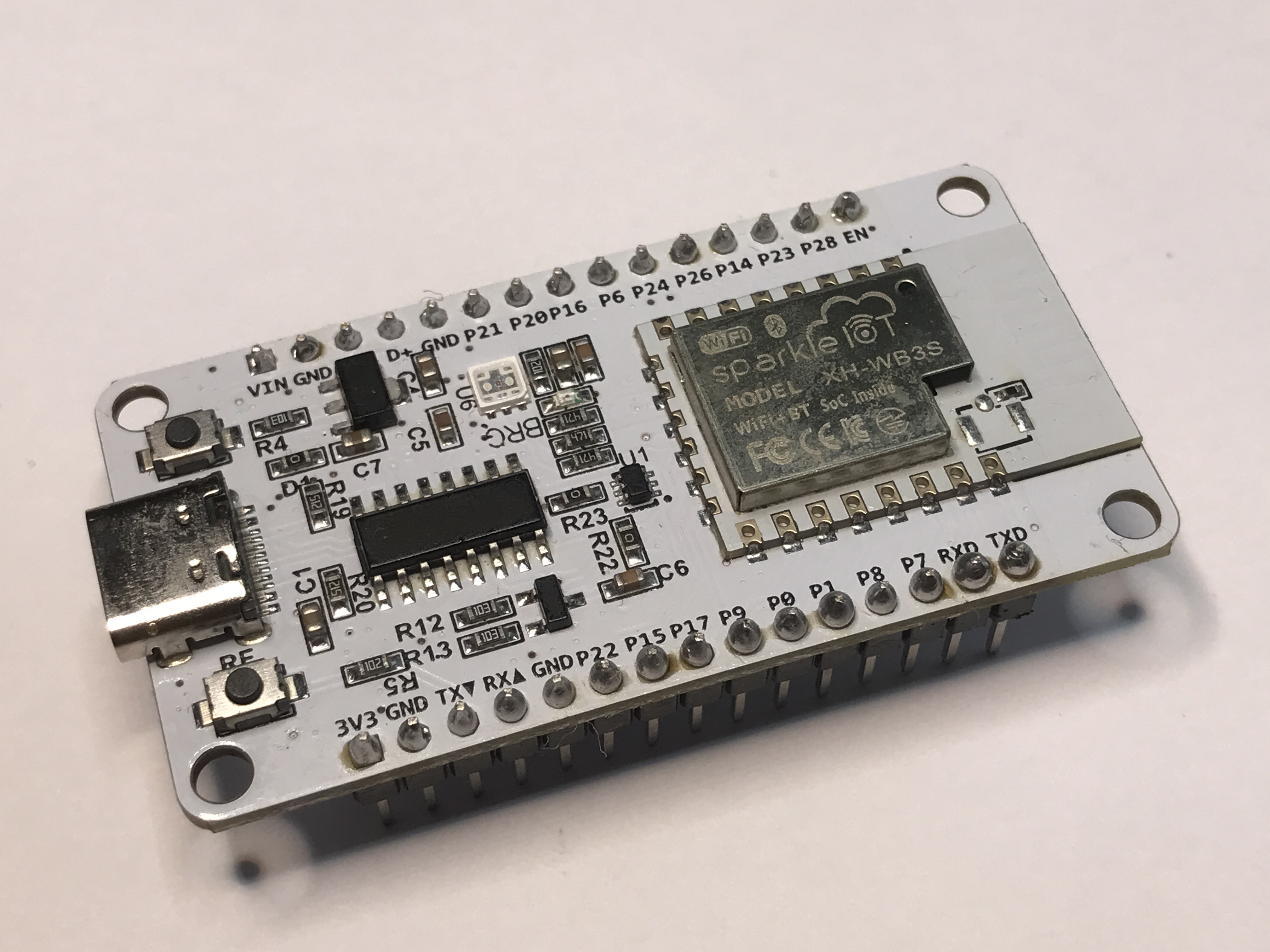

  • NiceMCU XH-WB3S is a very cheap WiFi+Bluetooth development board based on BK7238, aimed at OpenBeken firmware, MQTT, sensors, Home Assistant, and Tasmota Device Groups.
  • Flashing uses BK7231GUIFlashTool in BK7238 mode, starts with a 2MB backup, then moves through WiFi setup, GPIO doctor pin probing, driver commands, and optional scripting.
  • The module uses a 120MHz 32-bit CPU and 2MB of Flash, and the board can cost a few dollars or even $1.
  • The onboard LED is on P6, P24, and P26 with inverted logic, and DHT11, AHT20, MQTT, and Home Assistant discovery all worked.
NiceMCU XH-WB3S module with microcontroller and USB-C port.
NiceMCU WB3S is a cheap WiFi+Bluetooth development board featuring 120MHz 32-bit CPU and 2MB of Flash. It can be easily flashed with open source firmware and paired with Home Assistant. Futhermore, you can script it to suit your needs and compile custom firmware versions/drivers online, without having to setup toolchain on your PC.
The board can be usually bought for few $ and sometimes for as low as 1$:
NiceMCU WB3S development board with Bluetooth module and bk7238 chip.
Board module is called WB3S, but it's not using BK7231T, but it's using BK7238, which binary code is different.

New firmware
BK7238 is now supported by OpenBeken:
This means that you should be able to use OBK on NiceMCU, along with OBK features, which includes:

  • NiceMCU XH-WB3S is presented as a WiFi + Bluetooth development board with a 120MHz 32-bit CPU and 2MB flash, and the author says it often costs a few dollars and sometimes as low as $1. [#21440428]
  • OpenBeken support in this tutorial includes firmware flashing, GPIO mapping, LED control, scripting, DHT11, AHT20, MQTT, Home Assistant discovery, NTP, OTA updates, and Tasmota Device Groups on BK7238. [#21440428]
  • The onboard RGB LED was identified on P6, P24, and P26, and the thread notes the board uses inverted logic, so PWM_n or Relay_n roles are required. [#21440428]
  • The AHT2X example uses 4 command arguments after the driver name: two GPIO pins and two channel indexes; the shown working example is startDriver AHT2X 8 7 6 7. [#21440428]
  • A confirmed BK7238 MAC/RF recovery path is to restore the original TLV sector from 0x1E3000 in stock firmware to 0x1E0000 for OpenBeken, which fixed duplicate-MAC behavior for affected devices. [#21764552]
