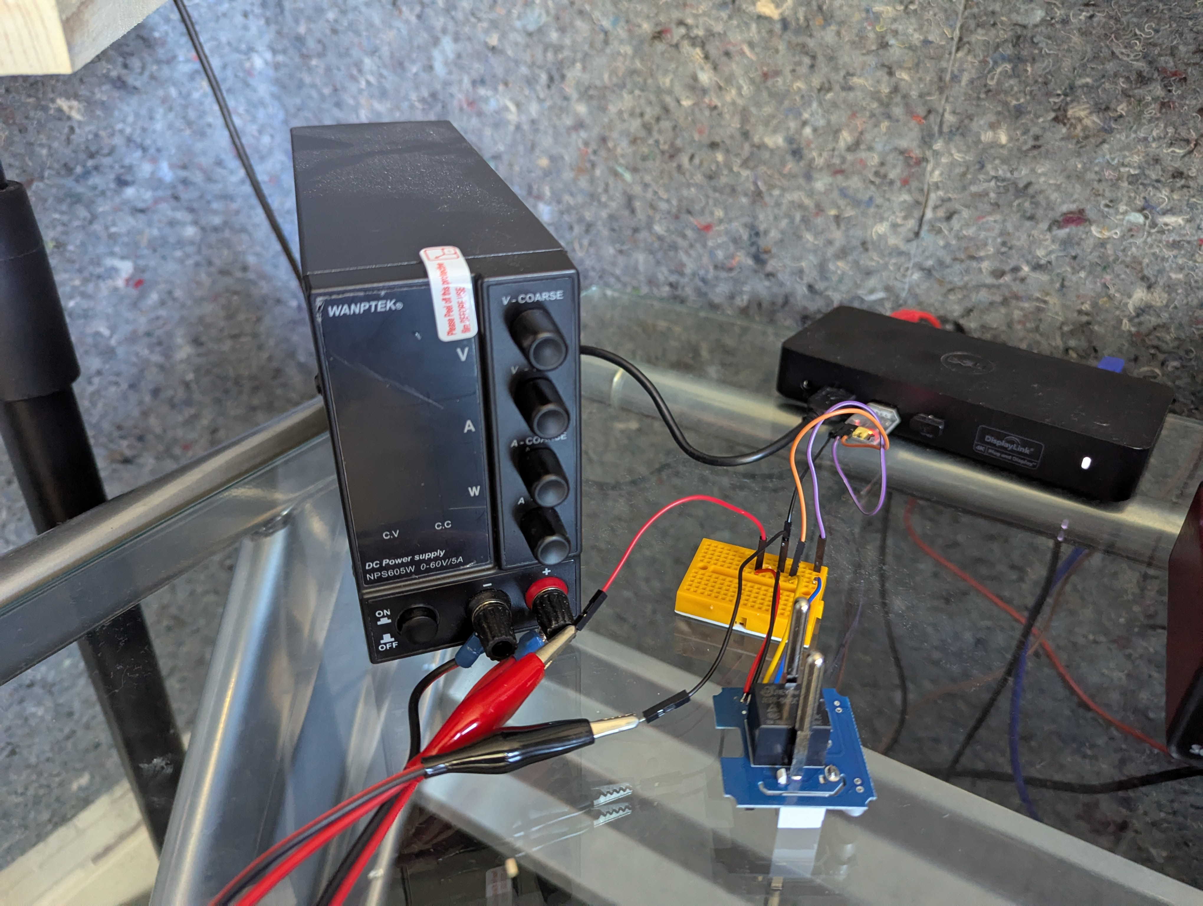

Hi all! Let me share my teardown of TNCE TUYA Smart Plug WiFi I recently bought on AliExpress for 5 euros. The original Tuya firmware was pretty unstable and I decided to covert it to OpenBeken. Luckily, OpenBeken supports ECR6600 platform so it was possible to flash it via UART. I'll show the flashing process here step by step.

We can see that the socket is built on the basis of ECR6600, which OpenBeken recently supported. To measure the voltage/current they use BL0937CF.
On the back of the PCB, there are convenient pads to solder the USB-UART adapter
Electronic circuit with JIEYING relay and connected wires.
Then we need an external 3.3V power source, I used an adjustable lab one
Laboratory power supply and prototype board on a glass desk.
I used this guide https://www.elektroda.com/rtvforum/topic4111822.html to flash the firmware, in a nutshell you need to:
1) Download ESWIN_ECR6600_RDTool_v1.0.21.zip from here https://github.com/openshwprojects/FlashTools/tree/main/TransaSemi-ESWIN and use RDTool.exe
2) In RDTool you double click "develop tool" tab, select the COM port, and on "all-in-one file path" select the firmware from latest release https://github.com/openshwprojects/OpenBK7231T_App/releases/ (ECR6600 UART Flash) - I used OpenECR6600_1.18.62.bin
3) Then you need to click start and enable the power source of a device. You might not get in sync from the first attempt (there is some very specific timing, smth like 0.5 sec to power device after start clicked) - that's okay, you will succeed eventually.
4) After the program finishes the flashing - you all set, the device runs free firmware now.
Now you can unsolder the wires, put PCB back in a case and try to put it in the socket. WiFi hotspot should be running now.

p.kaczmarek2 19 Mar 2025 11:14
Thank you for sharing! It's good to see that ECR6600 support is being useful for our users. Did you see that, @divadiow @insmod ? You did good job with research and porting. Did you try some other drivers... [Read more]

Hi guys, I have the same smart plug but I was not able to either backup old firmware not flash a new one. I keep getting RECV_RSP: recv timeout: recv length is: 1 (sometimes it's 3). https://obrazki.elektroda.pl/6596780400_1755966906_thumb.jpg... [Read more]
p.kaczmarek2 23 Aug 2025 18:48
So, how do you connect UART to your plug? Can you share some photos? [Read more]
kennyyzm 23 Aug 2025 19:02
Here's the photo, I broke both TX and RX pads and resorted to use the copper trace for both. https://obrazki.elektroda.pl/9111449500_1755968410_thumb.jpg [Read more]
p.kaczmarek2 23 Aug 2025 19:11
Well, first of all, you need to have a common ground between power supply and the UART... if you use external power supply, GND must connect to both external power supply GND and USB to UART converter... [Read more]
kennyyzm 23 Aug 2025 19:31
@pkaczmarek2 Wow, it works right away. Thanks for your help. I thought it's not possible to flash it anymore since I broke the pads, hehe, Thanks again! [Read more]
