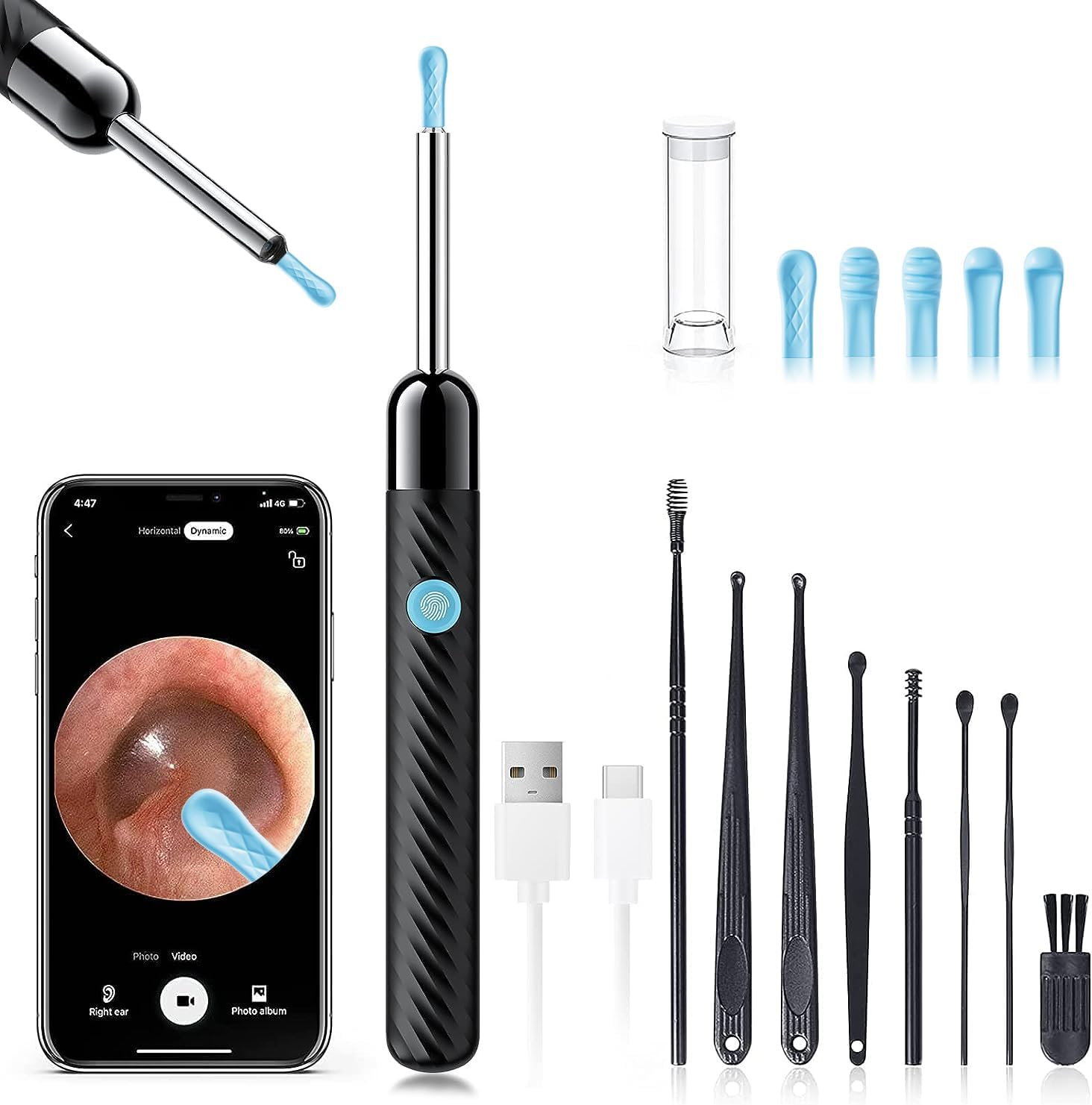

Recently it seems there has been a lot of cheap earwax remover otoscope devices popping up on amazon/aliexpress/tiktok shop similar to this:
When powered on, the button will start flashing slowly, as well as the light for the camera will turn on. After a few seconds it will start its wifi network usually with an ssid like "Soulear-ae45b" where it seems to be very generically "Company-uniq" as another device seems to show up as "Suear-4670". My device was broadcasting under the MAC of "88:17:89:0d:0e:b0" and had dhcp assigning IPs starting at 192.168.1.10 with itself at 192.168.1.1.
Once connected on a phone, its app which seems to vary based on the device you pick up, but all of which are essentially identical, allows you to take video, pictures, switch ears from left/right, enable/disable the led, as well as switch between either wide/focused lenses or switch between "horizontal" and "mirror(?)". Some also seem to have a lock icon which I'm not sure what does.
They're very difficult to get into, and from what I can tell can't be gotten into without breaking the plastic in some way. If you're opting to take it apart and keep it looking nice, I think my approach would be cutting the seam or maybe heat or something to remove the glue holding it in. Once in, you're greeted by a 21(?) pin connector for the leds + camera, 2.7V 170mAh battery, and the main pcb. PCB has a few pads exposed, of which I may have torn off CE and CLK 😬:
