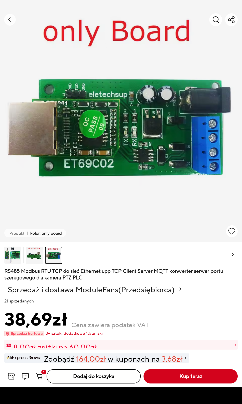

LAN/RS-485 converter ET69C02
ET69C02 converter board with Ethernet port and RS-485 terminal connectors
DHCP in this converter is disabled it can be enabled the factory set IP is 192.168.3.7

Configuration
Screenshot of LAN/RS-485 converter configuration at IP 192.168.50.65
