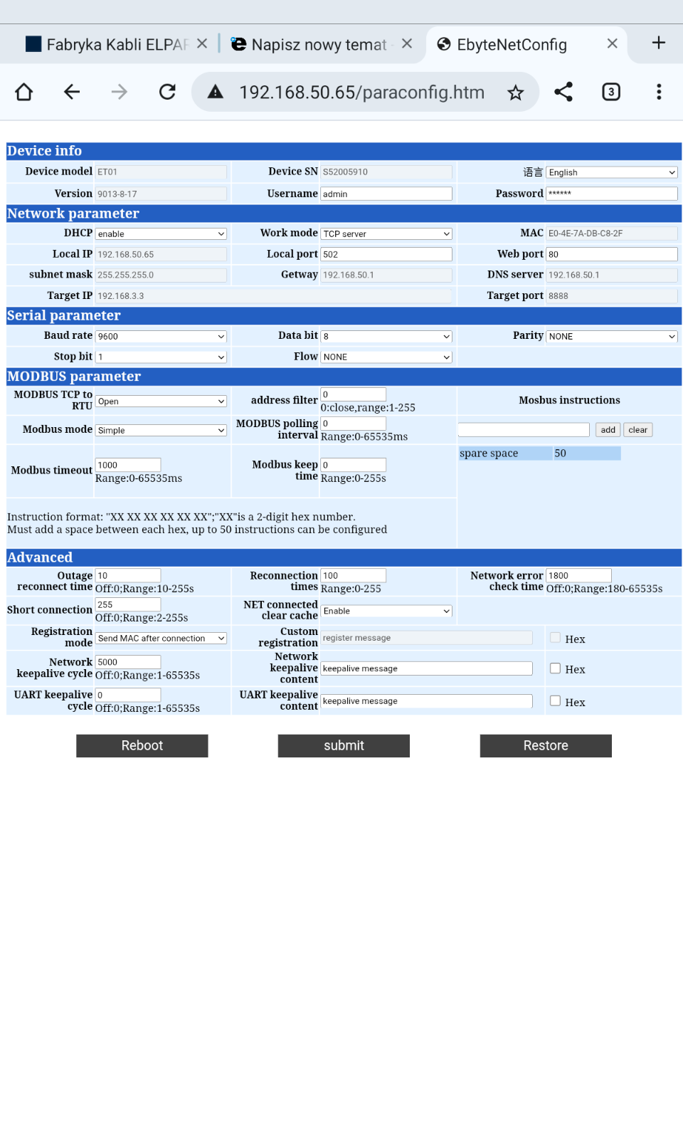

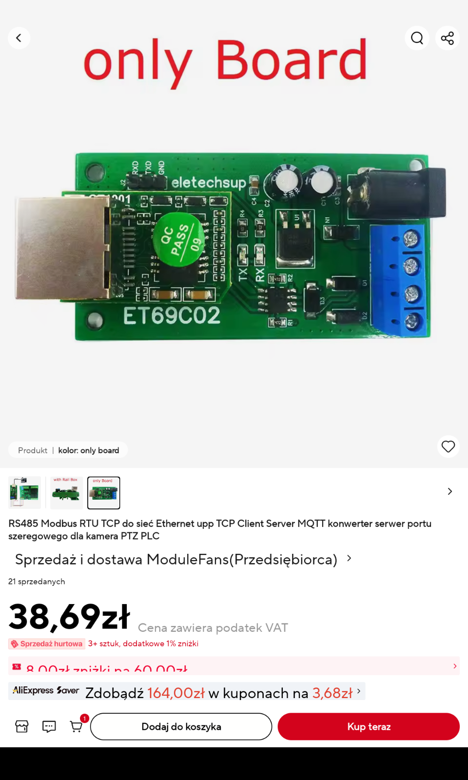

  • LAN/RS-485 converter ET69C02
    ET69C02 converter board with Ethernet port and RS-485 terminal connectors
    DHCP in this converter is disabled it can be enabled the factory set IP is 192.168.3.7
    https://youtu.be/QN_S2Ff1y04?si=EZ2IKUe2BmcGF-h4
    Configuration
    Screenshot of LAN/RS-485 converter configuration at IP 192.168.50.65

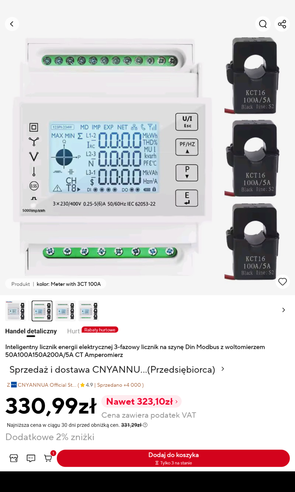

    TAC4300-CT bidirectional three-phase meter
    Three-phase energy meter with LCD display and three KCT16 100A/5A current transformers.
    https://github.com/esphome/feature-requests/issues/2727
    https://yizhantongimage.oss-accelerate.aliyuncs.com/UploadFiles/20221202134151415143.pdf
    You need to set the communication address according to instruction(2. Setting the modbus communication address) 255 in the configuration.yaml slave file: 255

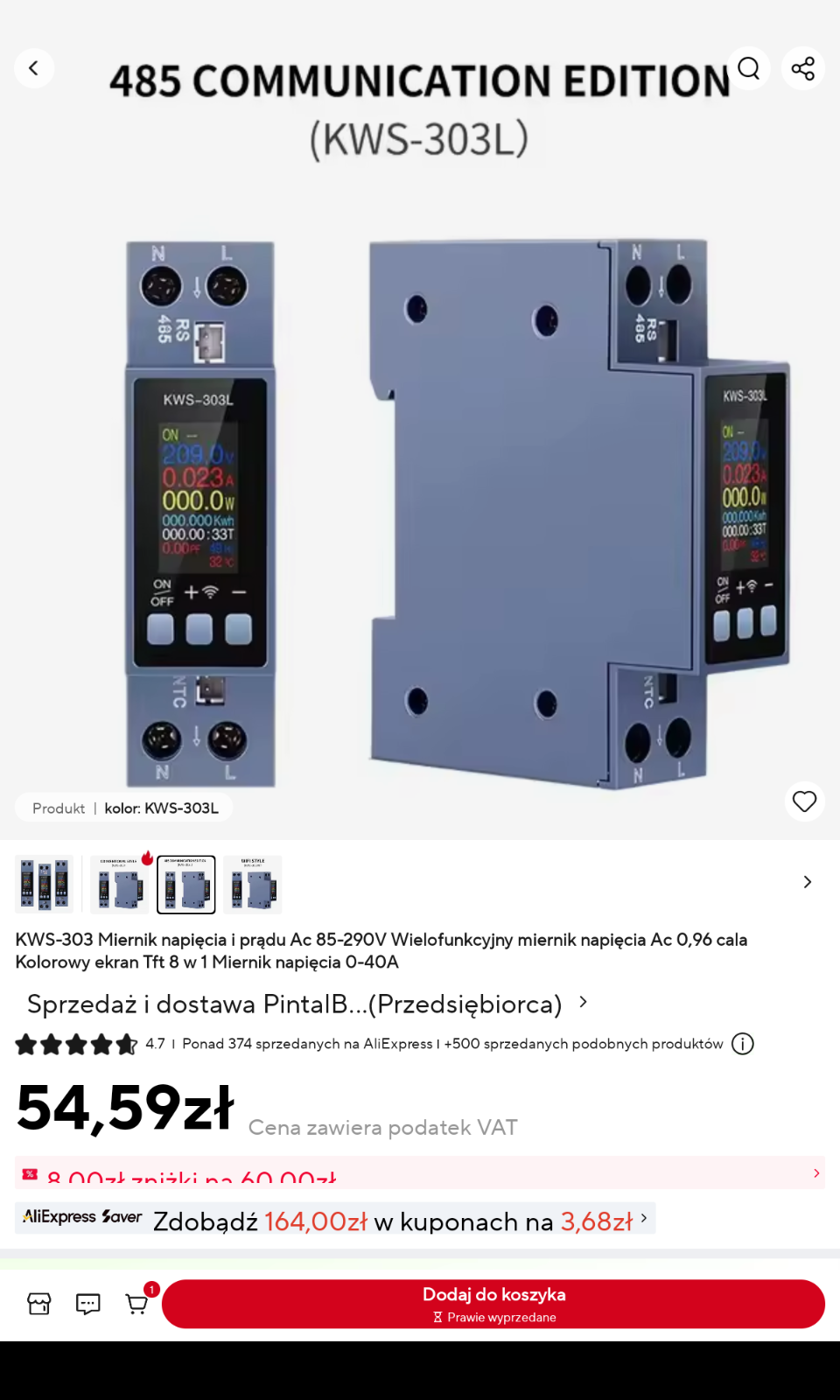

    Counter KWS-303L
    KWS-303L meter with TFT screen and RS-485 port, front and side view
    https://github.com/baldale/kws-303l
    https://www.nikom.biz/pic_info/A578019/KWS-30...CeZheOBComuL-5NjpN3FJNHneP4HM9k-fqnb3LWdVLkDk
    change language from Chinese to English there are some bushes with EN ending
    Set modbus address the same as in configuration.yaml slave: 101

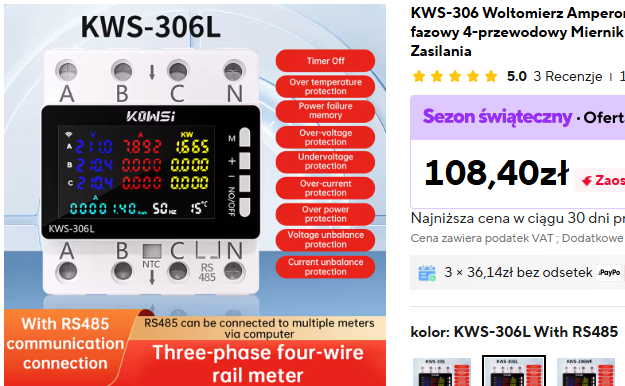

    KWS-306L With RS485
    KWS-306L meter screen showing current, voltage, and power with RS485 port
    Configuration of this and the above mentioned energy meters
