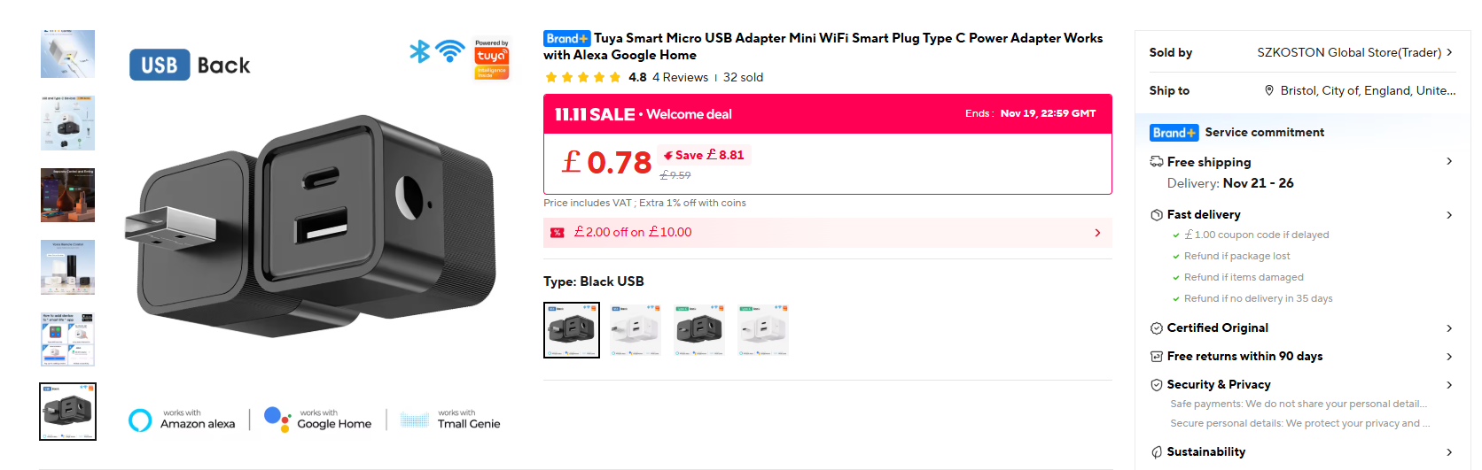

Tuya / SZKOSTON MG-SPQ100 USB-C + USB-A 5v-12v WiFi Smart Switch - BK7231N
divadiow  1 855 Cool? (+1)
Here's a dinky little thing. A cousin of the 1 and 3 port USB-A type. A Shenzhen Koston Technology Co Ltd (aka SZKOSTON) device.
Black USB Type-C smart adapter with USB ports and side button
https://www.aliexpress.com/item/1005008035710469.html
A type-C + type-A wifi smart USB switch. 1 button to toggle both USB ports on/off and one red LED that flashes when wifi is connecting or in pairing mode (when running Tuya factory firmware). Each USB port is independently controllable from within the app once paired.
