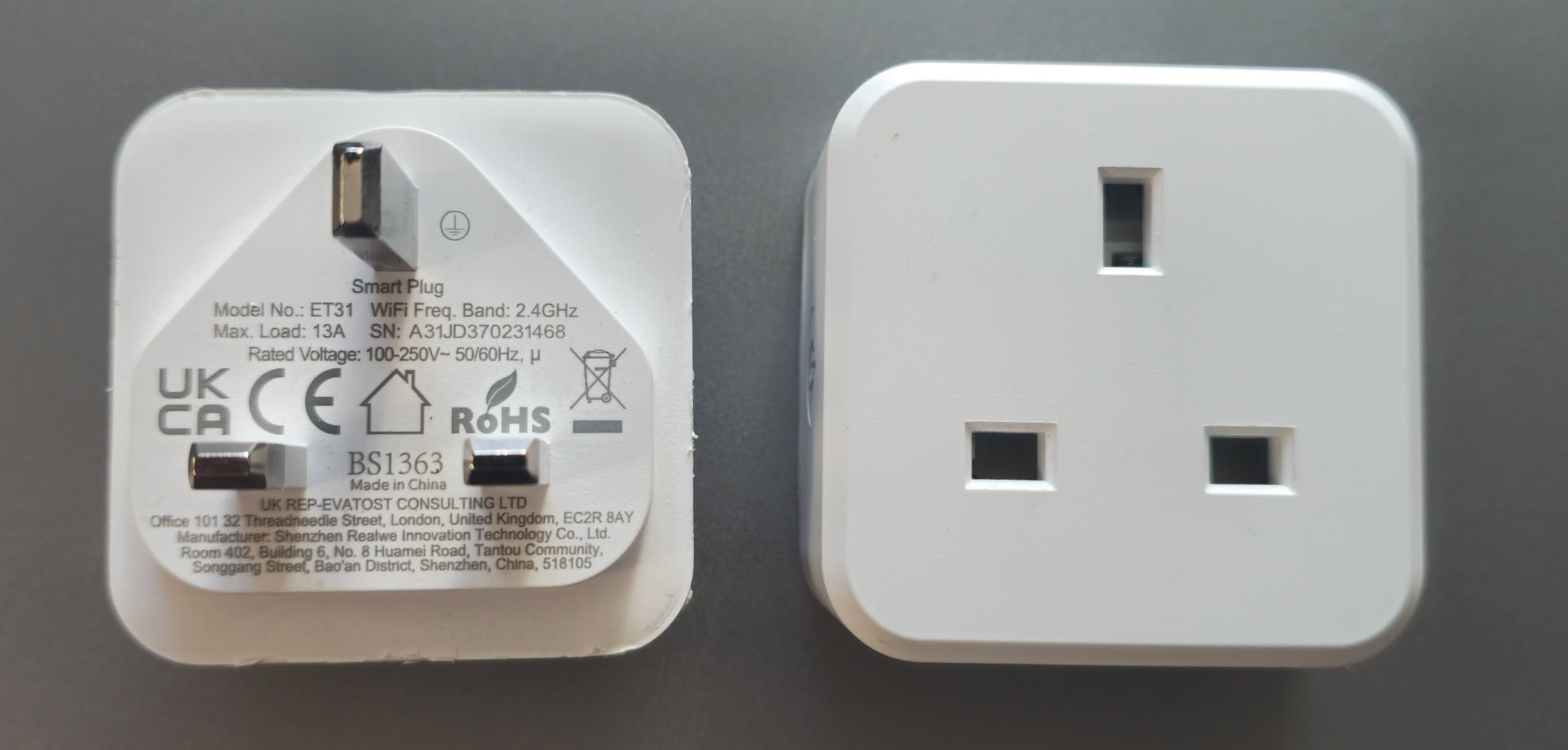

Description
It plugs into a mains UK socket using the pins to the left in the picture below, then allows plugging in another device into the opposite end, to the right of the picture above.
You may then switch power off to the tethered device using the relay switch to the left side of the plug, as seen after plugging in. Also, after registering the device in the SmartLife app ("SmartLife - Smart Living" by Volcano Technologies Limited on PlayStore), you may connect the device to your account to trigger it remotely on demand, or on a timer or other events and to monitor power usage. You may then, also, connect the SmartLife account to your HomeAssistant instance for further integration - it works alright, just don't enjoy having to register them through another app. I knew this before purchasing, but have purchased it in hopes of being compatible with OBK, which I've found it was, only after cracking it open.

"Disassembly"
It appears to be solvent-weld shut, so I could not open it without marring it (exploring less destructive ways of flashing).
A combination of flat screw drivers, stanley blade, precision crafts knife, clamps and heat was used to spread the seam around the protruding prongs.
After making a mess of it and ruining a few blades and my fingers, the assembly separated into the empty shell on the right below, and the electronics attached to the prongs, pictured left below.

I believe the size of the slot pictured below (to the right of the earth prong).should do as I can see all the pins looking straight down in.
Hoping the picture below with a scale next to it will help align the cut better, should anyone decide to try this.
Measuring a non-mangled unit gives 58.1 mm height and width, whereas, the one I've messed with measures an extra 0.3mm (below).
Other measurements
These might not be needed now, but could help later:
Face: 57.1mm x 57.1mm (where you plug in the monitored device)
Rear: 58.1mm x 58.1mm
Depth from face to rear: 32.3mm
Dept from face to rear including the prongs island:39mm
Depth from face to tip of earth prong: 61.8mm
Distance from bottom edge of main body to bottom of the prongs island: 8.3mm
Distance from top edge of main body to tip of the prongs island: 6mm
Distance from left/right edge of main body to side of the prongs island: 5mm both left and right.
Width of the mini-PCB sticking out the bottom of the main PCB: 11.7mm
Thickness of the mini-PCB: 0.6mm
Spacing between pins: 1mm
Width of pins: 1mm
Thanks for sharing. So we're really seeing more and more of T1 (BK7238) chips these days. I guess 2026 will be the year of BK7238 :D I did it once for few plugs, but I can't say it went nicely for... [Read more]
Hi vargabp, great teardown, thank you. I had a few of these Eightree model ET31s too. Just to note for anyone following, although completely similar externally, the internals of the switch I chose to... [Read more]
That's certainly interesting, it would be useful to know if your revision distinguishes itself from the ones I bought without having to crack it open. Are the external markings any different? Is the shape... [Read more]
So the external form of the plug is the same with some different screen printing on the base (photo attached). It still identifies itself as an 'ET 31' and 'Etavost consulting' appear to have made the... [Read more]
