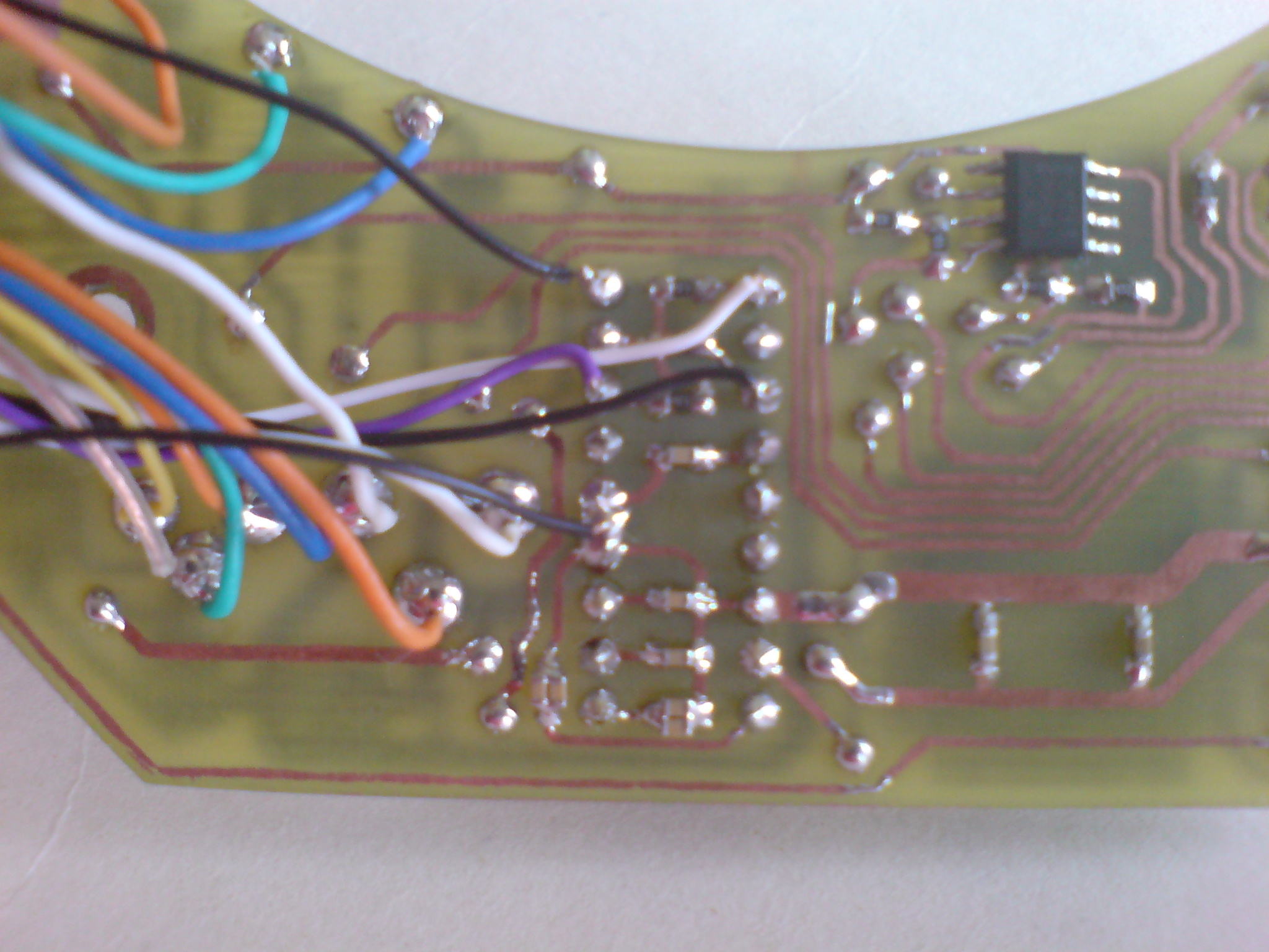

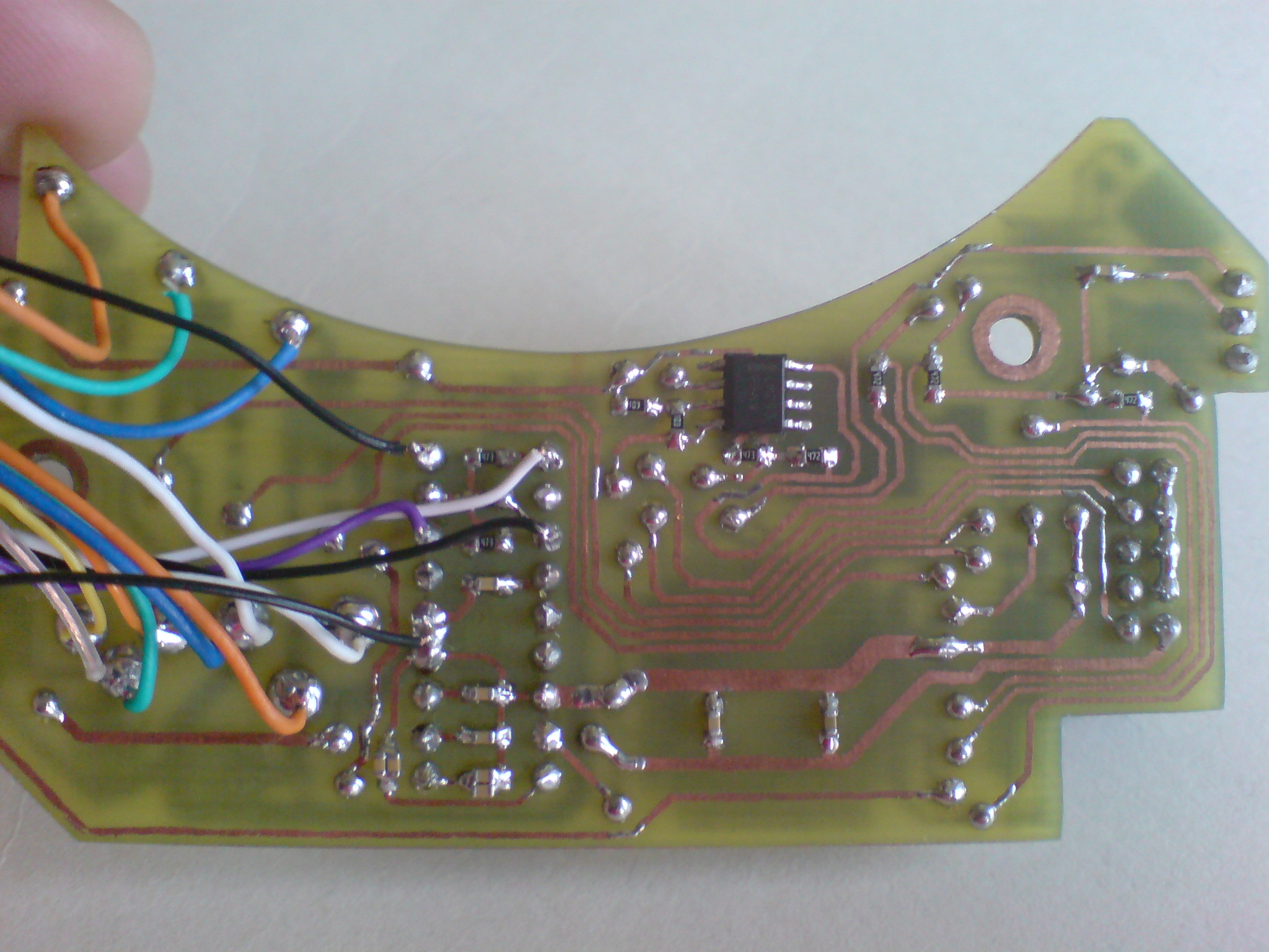

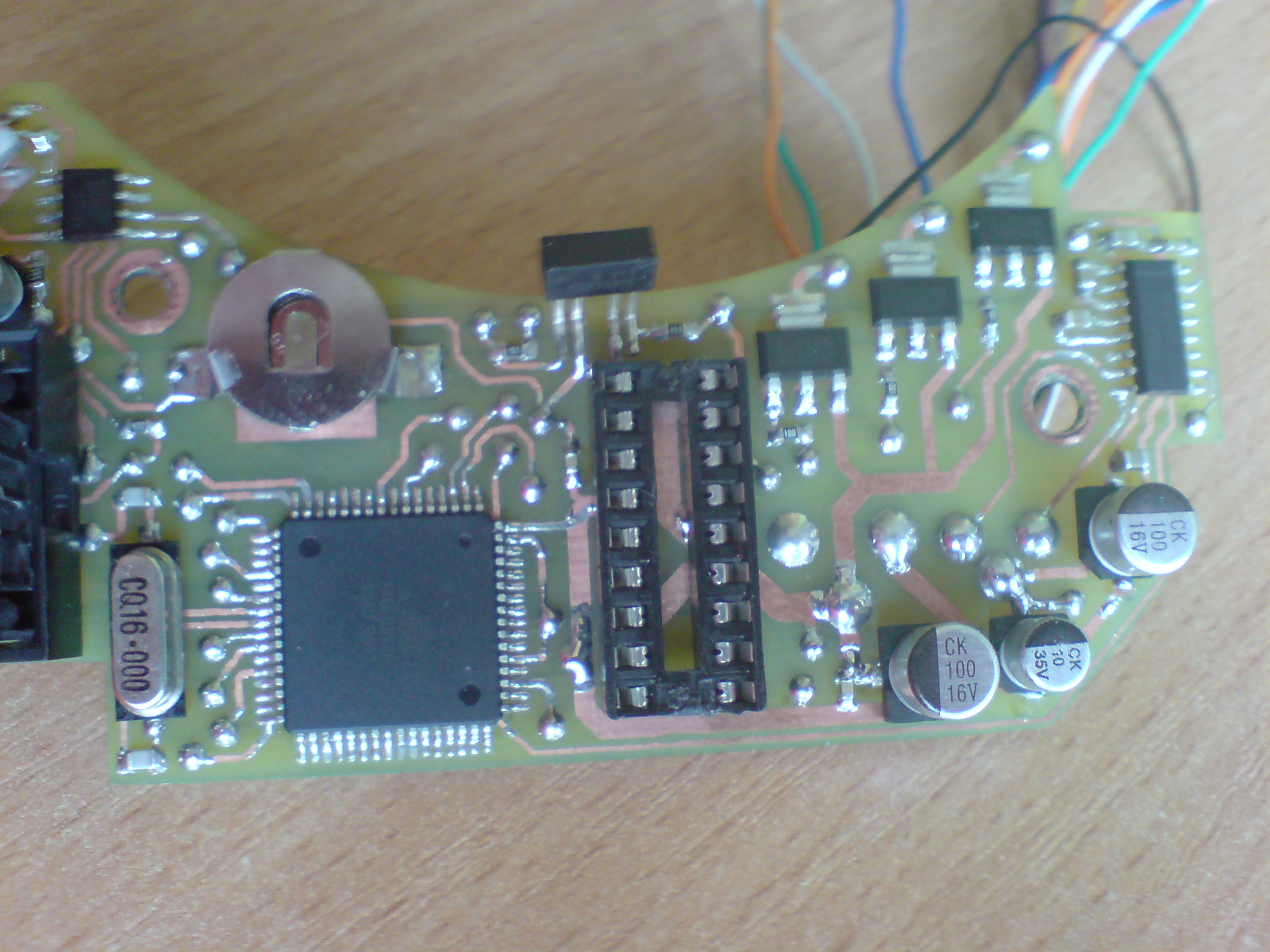

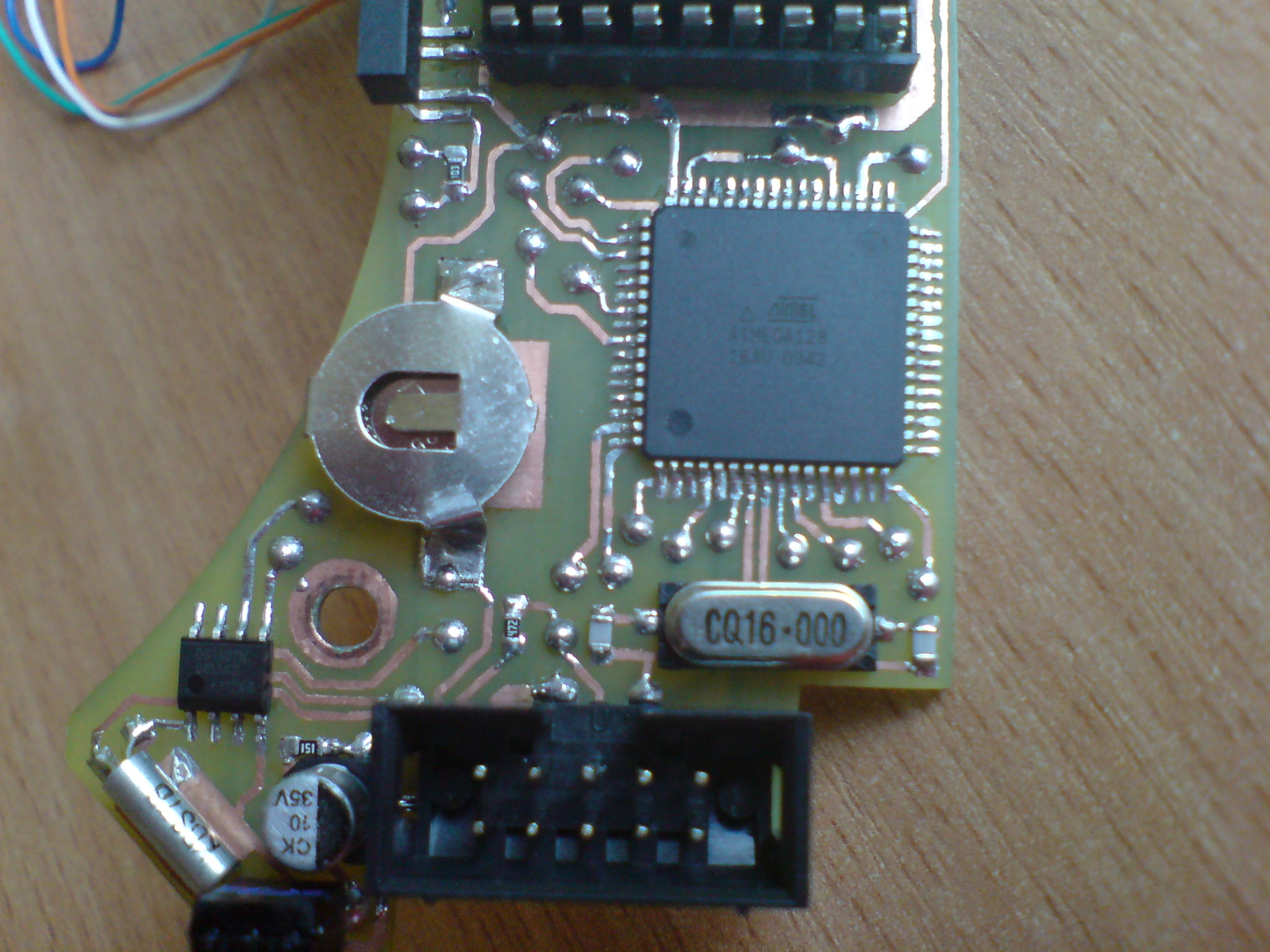

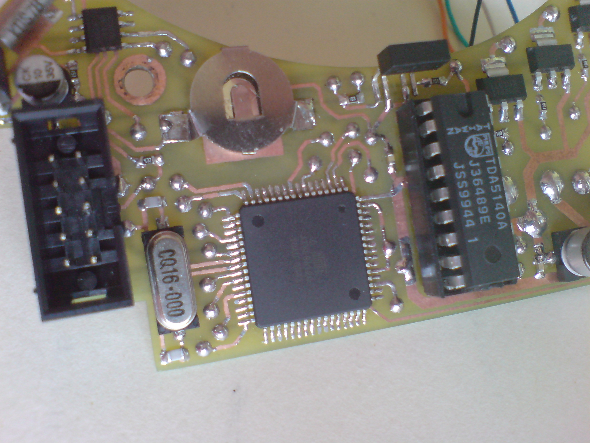

    I checked the signals on all the legs and this is what I received:
    (7) RCINT 4.89V (at a signal from the pilot 4.07V)
    (9) INT7 0.11V (with approx. 4,89V reflecting surface)
    (11) SCK 0.02V
    (15) RED 0.02V
    (16) GREEN 0.02V
    (17) BLUE 0.02V
    (20) RESET 5.09V
    (21) VCC 5,11V
    (22) GND approx
    (25) SCL 5.09V
    (26) SDA 5.09V
    (27) RDX 5.09V
    (28) TDX 4.70V
    (32) SQW 0.05V
    (51) MOTOR 0,02V
    (52) VCC 5,11V
    (53) GND approx
    (63) GND approx
    (64) VCC 5,11V
    I checked the connections between the IDC10 socket and the processor and everything is OK.
    on the quartz legs I observed the voltage of 0.07 on the MILI scale because in volts there was no reaction which I saw on the quartz of the DS1307 chip. Should it be like that?
    Here are the pictures of the layout.
    HDDClock - clock from hard drive HDDClock - clock from hard drive HDDClock - clock from hard drive HDDClock - clock from hard drive HDDClock - clock from hard drive
  • #125 7955259
    mlassota
    Posts: 372
    Help: 11
    Rate: 85

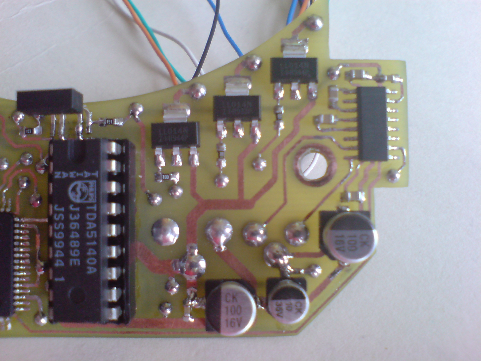

    Hello Colleague
    I look at the tiles and intrigue me as you soldered from the TOP side - top stand under TDA because you have a simple stand and it can not be soldered on both sides of the plate and this is ABSOLUTELY necessary
    Take a photo of the side of the TDA stand and the IDC10 socket housing raised - it must be in February.
    greetings
    M

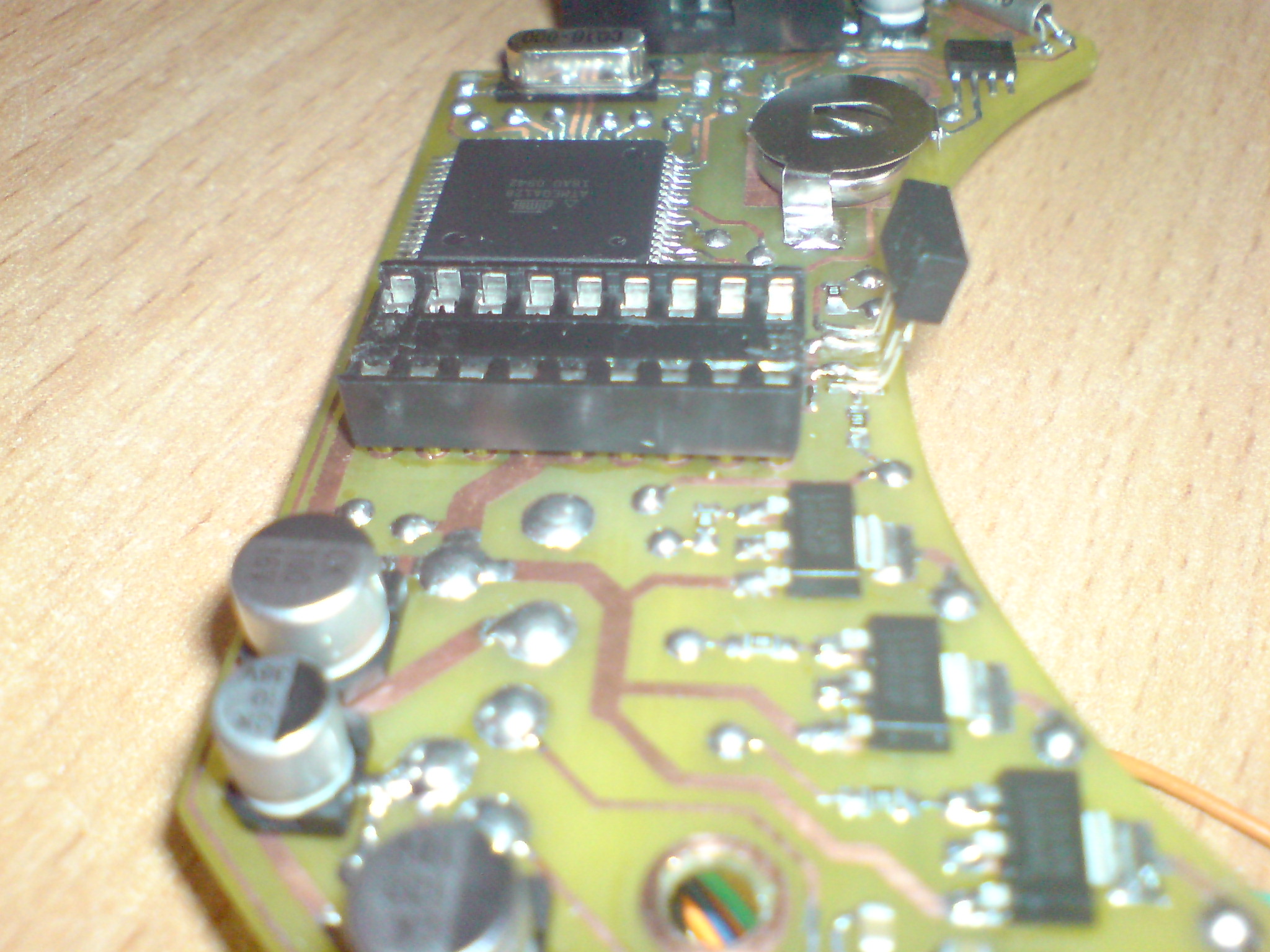

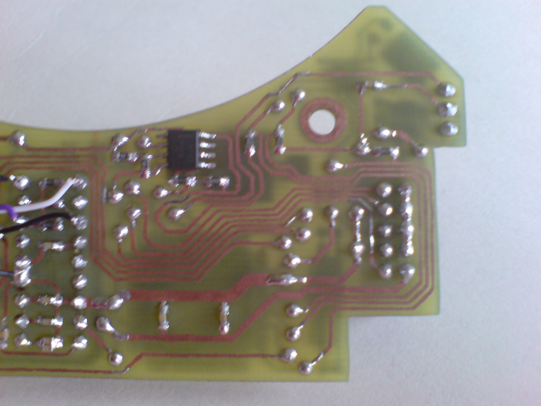

  • #126 7955316
    Matt_x89
    Posts: 50
    Rate: 196
    Yes, I agree that you can not solder and I knew it immediately. I decided to circumvent this problem in such a way that before soldering the socket for the scalak I made guides from several wires in places where it is necessary and checked the meter if the circuit is closed. After that I soldered the stand and checked everything again. Besides yesterday, as you advised I gave the 8 TDA 5V outstretched and the engine moved without a problem. In the picture from above it should be seen that I solder guides under the stand in places where it is necessary.
  • #127 7955413
    mlassota
    Posts: 372
    Help: 11
    Rate: 85
    My friend
    If you are sure about the correctness of soldering, do so
    Put the primitive program into the processor's memory:
    $regfile = "m128def.dat"
    $crystal = 16000000
    Config Pina.0 = Output
    Config Pinb.5 = Output
    Config Pinb.6 = Output
    Config Pinb.7 = Output
    porta.0=0
    portb.5=0
    portb.6=0
    portb.7=0
    Do
    Set    Portb.5
    Wait 1
    Set Portb.6
    Wait 1
    Set Portb.7
    Wait 1
    Set Porta.0
    Wait 3
    Reset Porta.0
    Wait 1
    Reset Portb.5
    Wait 1
    Reset Portb.6
    Wait 1
    Reset Portb.7
    Loop
    Below compiled hex
    He has to turn on the diodes and turn off the engine and then perform the reverse sequence. Let me know what the effect is.
    To upload Hex, use the ISPPROG program available here
    Remember to configure your programmer.
    • noname1.zip (479 Bytes) You must be logged in to download this attachment.
  • #128 7955527
    Matt_x89
    Posts: 50
    Rate: 196
    Thank you for the testing program.
    After uploading it to the processor, the LEDs are always red. It looks like the processor does not make a loop, it just stays in place, it concludes that the remaining colors do not turn on and the motor does not react. Could it show damaged quartz and lack of synchronization for prock?
    Once again, thank you for the test program :)

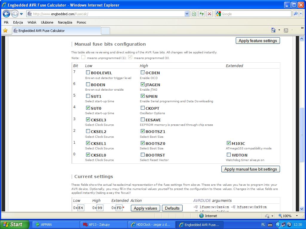

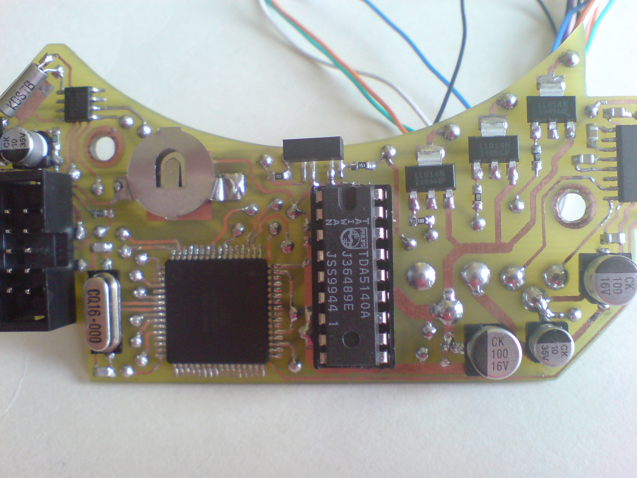

  • #129 7955598
    mlassota
    Posts: 372
    Help: 11
    Rate: 85
    Try to change the fusebits on the internal 8Mhz oscillator (bits w / g image)
    Below the same program the same but at 8Mhz ... maybe now it will start :)
    • 8mhz.zip (474 Bytes) You must be logged in to download this attachment.
  • #130 7955649
    Matt_x89
    Posts: 50
    Rate: 196
    I came up with the idea of checking if everything works, but unfortunately the environment has gone crazy for me to program. Could a friend give me this program first on 16Mhz only in 3 versions, let's say it starts with a green color. The next program would start with the blue color and the last one would start with the engine being switched on.
    If this is not a problem, I would ask for such versions of this program. Then it would be known that the percentages start the system and the wine can be on the quartz side
  • #131 7955725
    mlassota
    Posts: 372
    Help: 11
    Rate: 85
    In the appendix programs starting from different pins - the program name is the name of the port from which the program starts - I hope I did not crash any error in the program :) - in the end is so complicated :)
    • wersje.zip (1.77 KB) You must be logged in to download this attachment.
  • #132 7955769
    Matt_x89
    Posts: 50
    Rate: 196
    Thank you very much for the programs. After uploading b5, the diodes are red, b6 green, b7 blue, and the engine turns only (after about 40 seconds of turning for a while it slows down as if it was turned off and continues to spin). Now the question remains why the loop does not work and the ports are not activated in turn. Is this momentary turning off the motor and the lack of port switching indicates the damaged quartz?
  • #133 7955832
    mlassota
    Posts: 372
    Help: 11
    Rate: 85
    Try to really switch the processor to an internal oscillator at 8 mhz and then upload the programs from the file below. Exclude quartz failures.
    Solder out capacitors with quartz - maybe one has a puncture and pulls to the mass
    The upside is that we are sure that the ports are operational and did not burn during the soldering
    • Wersje 8Mhz.zip (1.77 KB) You must be logged in to download this attachment.
  • #134 7955949
    Matt_x89
    Posts: 50
    Rate: 196
    I changed the source signal to the internal 8MHz and uploaded the program on this version. Earlier I was soldering the quartz and the system was behaving unchanged. then I switched to external 16Mhz clock and the system refuses to cooperate here:
  • #135 7956030
    mlassota
    Posts: 372
    Help: 11
    Rate: 85
    And porcek has connected quartz?
    If not, he has the right to behave like that
  • #136 7956548
    Matt_x89
    Posts: 50
    Rate: 196
    I re-soldered the quartz to the system before I changed the bits and uploaded the program to 8MHz. The system can not be recognized by any program at all.
    Added after 1 [hours] 53 [ minutes]:
     I decided to desolder the slingshot and ordered a new system and quartz. Thank you again for the test programs. I wanted to ask if you guessed what could be the cause of the damage to the prock, or what could I do wrong? Could the temperature of the soldering tip damage the processor?
  • #137 7958155
    mlassota
    Posts: 372
    Help: 11
    Rate: 85
    Hello, Kolegów
    I undressed my watch and uploaded the test programs.
    On a properly folded (working) watch they work the most.
    The LEDs light up one by one and the engine starts up ...
    So the problem lies in something else.
    Perhaps you've overheated the chip during soldering and maybe the quartz is guilty, capacitors ...
    I thought that when I was at work and writing test programs, I screwed something up, but I'm sure it does not work on my ass.
    Before desoldering the processor, if you did not do it try to insert a different quartz - new - not even in the smd enclosure - maybe it overheated ... There is also the possibility that the processor fell from ESD ... although I solded a few and did not spoil in this way.
    What are you programming - what programmer? If under LPT, check if the computer is connected to ground.

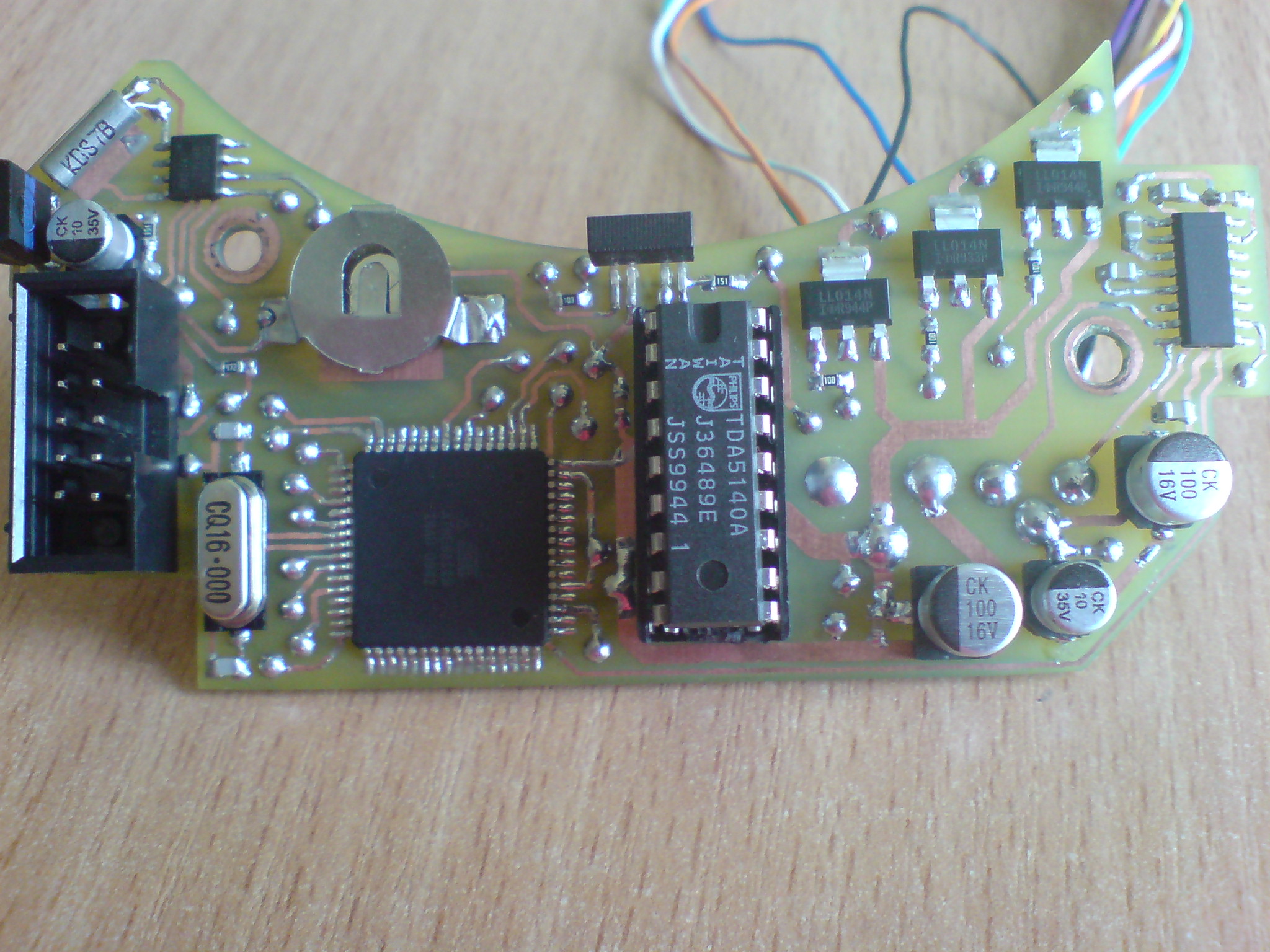

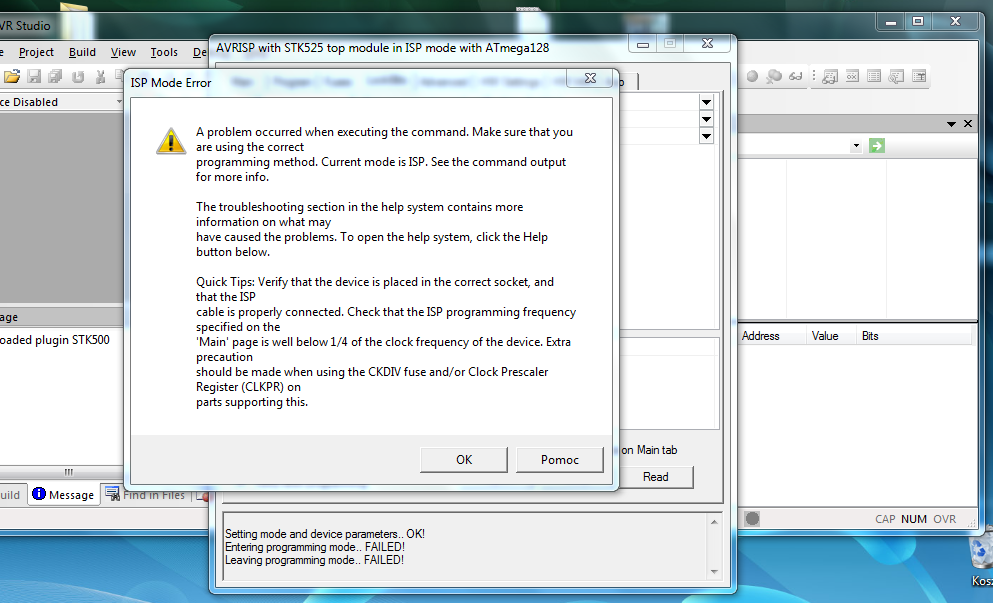

  • #138 7958261
    Matt_x89
    Posts: 50
    Rate: 196
    I've desoldered the slingshot now. The processor was soldered to a soldering station with a 0.5mm tip and each soldered separately, I was also thinking about inserting a 1mm tip and applying one stop at one stroke.
     I have installed AVR Studio 4 on my computer and loaded the hex file from this program and set fuse. Could the other systems damage the slingshot, walk on the signals that I put in the morning it looks like everything is correct? Which download program do you recommend to install? I would like to avoid damage to the next prock so I'm open to any suggestions ;)
