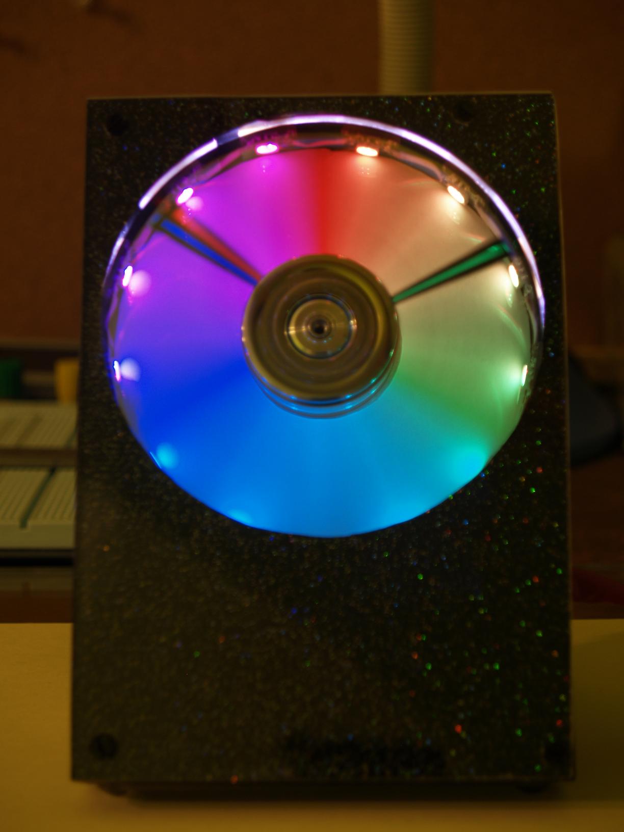

    Hello, Kolegów
    Today I finished the HDDCLOCK enclosure so I can present the pictures.
    Thanks to the author's help, the watch was able to run - not without small problems.
    The problem that turned out to be the garbage offered by the reflection sensor.
    After again "centering" the plate - as in my disk it is a bit higher up to 1.5mm than the top edge of the disk rotor - everything started working properly.
    I finished the clock before Christmas and from then on I was 4-5 seconds late, ie from 2-04-2010, so it's accurate
    After covering the front you can hear it minimally
    The colors in the pictures are somewhat misrepresented - lighting with fluorescent lamps in my room - workshop and night time :( but what's a bit visible Once again, thanks to the author of the project!
    greetings
    M
    HDDClock - clock from hard drive HDDClock - clock from hard drive HDDClock - clock from hard drive HDDClock - clock from hard drive HDDClock - clock from hard drive
