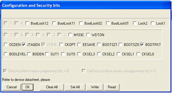

    alien2
    Posts: 46
    The project is almost finished. I still have a question about programming, i.e. you have to set up fusebits?
  • #89 7229822
    mb1988
    Posts: 93
    Rate: 258
    Yes, you have to change the fuse bit. Generally, this boils down to disabling the compatibility mode with atmega103, activating the bootloader and changing the source of the signal.
    Screen from PonyProga:
    HDDClock - clock from hard drive
    For commandliners, just call avrdude with the following options: -U lfuse: in: 0xff: m -U hfuse: in: 0x9e: m -U efuse: in: 0xff: m
