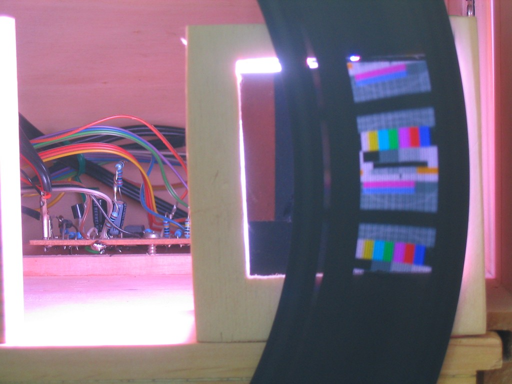

  • #154 8849071
    mb1988
    Posts: 93
    Rate: 258
    Diode control is carried out as follows:
    - the rotation of the plate is divided into 240 steps (time slots)
    - in each time slot, fast, 5-bit, three-channel PWM is fired
    - the fill factor is loaded into the channels for red, green and blue respectively
    - in this way, any 'time' color is generated in each time slot.
    The original electronics could not be used for two main reasons. First of all, the engine simply did not start. This was probably caused by the fact that the electronics first checked whether the disc contained everything that was needed, and then it started with the revolutions. It seems logical, especially if the head of the disk were damaged. Then the rotation of the engine could cause serious damage on the plate's surface. But even if the engine was to start, the original electronics would have accelerated it to such a speed that the vibrations would be unacceptable. My plate rotates at a frequency of about 50Hz and this is a sufficient value (almost imperceptible vibrations and the image quality will be better and it will not be any better). I omit the fact that with original electronics it would be harder for me to design outputs for power and communication sockets.
    When it comes to connecting diodes in a ribbon, all diodes (or rather colors) are controlled in parallel by n-mosical keys.

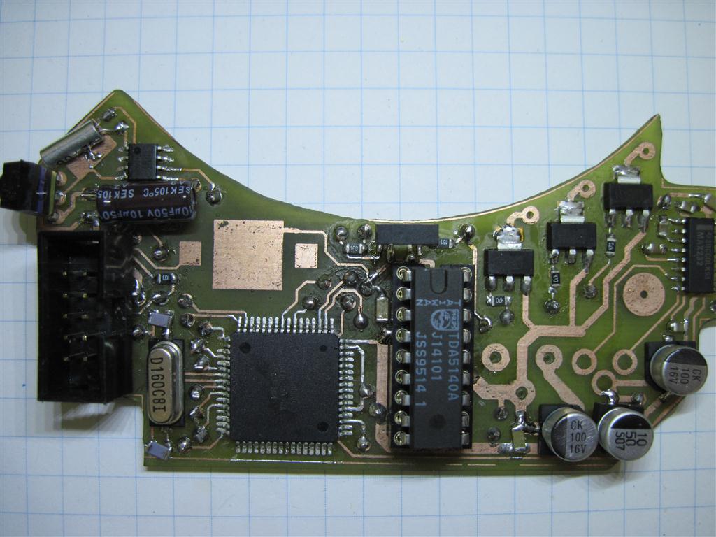

  • #156 8850353
    mb1988
    Posts: 93
    Rate: 258
    PWM is hardware, i.e. I use one of the microcontroller peripheral modules.
  • #157 8855528
    sniff
    Posts: 15
    I'm sorry to bombard you with a hail of questions, but I would not want to commit a stupid mistake on the project.
    I hope I will not unduly strain your patience if I take a second?
    I connected my molex plug-in plug from my PC's power supply with the slot already cut out ... the conclusions brought me into the abyss of despair.
    Although the drive takes off, it vibrates like a very strong vibrator in the phone. The watch would wander around the table.
    After about a minute, the disk electronics stop the plate.
    So I will not run away from the disk engine driver.
    This dedicated driver you used was TDA5140A (please, pay attention to the order of numbers: 5 1 4 0)? You write about such an assembler on the first page of the thread. The schema.pdf file is TDA5410A, only google spams some datasheet, I suspect that there is a typo on the schematic?
    Your engine had 3 wires on the disk, right?
    Scalaczek is terribly difficult to access, but after checking the electrodes, diodes and others for a day, I come to the conclusion that the self-built, simple BLDC motor controllers are the first to take up too much space. Second: they give unstable turns. They will stop every now and then, start to spin again, etc.
    I understand that thanks to the control of the TDA5140A chip, the disk rotates constantly at the same frequency, without stops, brakes, etc.?
    How do you set the frequency of 50Hz?
    Greetings,
    sniff
  • #158 8855846
    mb1988
    Posts: 93
    Rate: 258
    So it's like I said: an engine with original electronics may not work, and even if it works, the vibrations are huge.
    The driver is TDA5140A (there were a few problems with this typo :P ). This driver is friendly to use, works very steadily. Sometimes when a too-powerful engine (eg from some RC model) connects to it, it heats up quickly and turns on the thermal protection, but in the case of motors with a hard drive, this is not likely to happen. I did not set 50Hz frequencies. Simply put, I used the app shown in the catalog sheet and it worked. The rotational speed does not have to be constant - the program has been written in such a way that the image adapts itself to the current rotation frequency (it must only be between 35Hz and probably 60Hz). My engine has 3 pins, but four motors are also suitable.

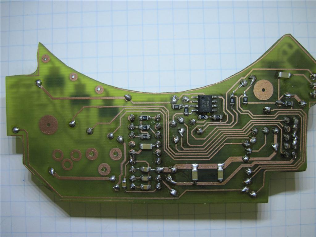

    I am asking for help. :( I did everything I sold and cramp somewhere short circuit because it disconnects the programmer; / and I can not even program it, someone has an idea where it can to lie?
    HDDClock - clock from hard drive HDDClock - clock from hard drive
    Apple Surgery
    Śląska, Bargły, 42-262 | Company Website: https://applesurgery.com.pl
  • #177 9446299
    mlassota
    Posts: 372
    Help: 11
    Rate: 85
    It's hard to deduce anything from these photos.
    Maybe the jet processor shifted on the pads? The short-circuit is quite easy to do both at the "top" soldering of the cabinet as well as under the programmer's socket.
    You have to carefully follow the flow of power - it is not complicated in this project. I have given three critical points. Another critical point after looking at the plate is the 10uF capacitor - the bottom right corner of the plate - the pads are under tantalum - so they are quite close - it can move - for now it can be soldered out - the watch will also move without it ... In the myriad of possibilities straighten the parts they lay exactly on the pads.
