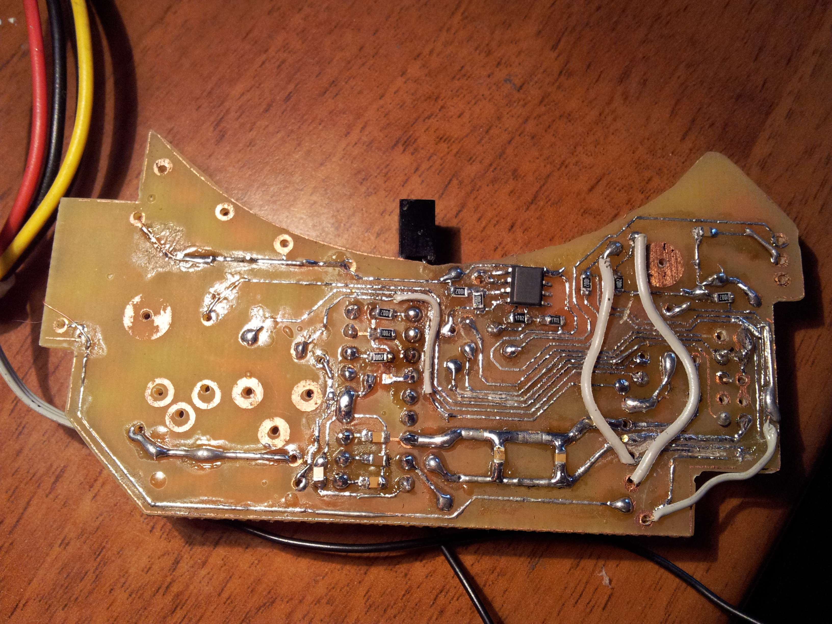

  • #208 11734186
    aleksa809
    HDDClock - clock from hard drive HDDClock - clock from hard drive
    Here are the images of both sides of the pcb. I know it looks horrible ( It is my first double sided printer transfered SMD board i have ever made :) ) ,but all connections are solid and there are no shorts, the clock chip is missing because i coulnd find it in an SO-8 package but only DIP-8 ,so it will be mounted somewhere in the case, and the PDO jumper isnt where it is supposed to be,but right after it goes out of the atmega,with a little piece of wire ( i will clean it up right after i manage to program it ) and mb1988mb1988 thank you very much for responding, it is an honnor :)
    Again i know it really looks bad but trust me all connections are how they are supposed to be, I've put many many hours into this board :) I've even tried the opto switch op amp output and it is good, but so far it is the only thing that works on the board :(
  • #209 11734385
    mb1988
    Posts: 93
    Rate: 258
    Oh, where to start...
    First of all, 'few glithes' and ''horrible' in your situation sounds like a complement :P .
    What I see is unfortunately lack of knowledge and I don't think that the clock will run near soon, but with small steps maybe someday you will get this working.
    What you call 'jumpers' is in the fact 10-pin programming socket compatibile with ISP programmer which uses KANDA pinout standard e.g. USBasp. You should get one and try to comunicate with your uC. I won't be describing this procedure because it was described many times elsewhere. This step is crucial and can't be skiped.
  • #210 11734415

What capacitors control RPM on the TDA5140A driver?
Cap-ST (pin 9-10) sets base speed. Start with 18–22 nF from the datasheet; smaller values raise RPM, larger slow it [Elektroda, mlassota, post #9289906] Cap-TI must be ≥ 2 nF for kick-start stability NXP TDA5140A Datasheet.
My disk stops after one minute when using the original PCB—why?
Drive firmware parks the motor if heads aren’t detected. Either transplant a standalone BLDC driver (e.g., TDA5140A) or cut the power trace and feed coils directly; leaving stock electronics risks auto-shutdown and excess current [Elektroda, whd, post #7362488]
