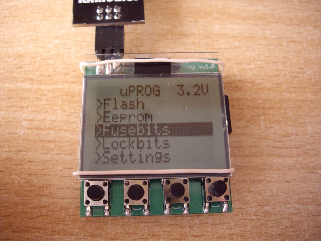

    leonow32
    Level 30  
    Posts: 2027
    Help: 37
    Rate: 1232
    You could do the option to automatically set the fusebits before programming - the point is that if there is a 16MHz quartz on the plate, let the process be programmed using a quartz clock and not the internal 1MHz generator.
    The question is how to do it?
    How to tell if there is quartz on the plate? If it changes and it will not be ... you will have to attach ...
    The procedure could look like this:
    Reading fusebits
    If lower than 8MHz - change to 8MHz - internal
    programming
    Return to previously read
    Honestly, I do not really see such a need ... After all, even with 62.5kHż programming does not take forever ...

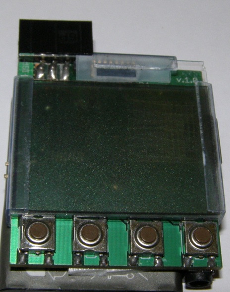

    One more piece of advice for rockers
    The packaging for elements in SSOP housings is ideal (almost) for holding the display. You need to cut the concave part with a margin of about 1mm.
    It is easy to do ... I recommend it
    This packaging looks like this
    uProg - small, fast, portable AVR programmer with SD
    and the display unit is attached - like this:
