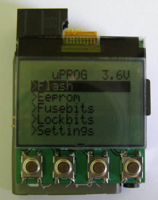

    Oh, I would have forgotten, I got a Chinese today (display of course) and as it turned out the matrix has an organization of 48 * 84 pixels, and the driver is 48 * 102 pixels. Also in practice, the display has 14 characters per line, and theoretically 17. Terrible Chinese technical thought, brrr. Well, but I did itsome code and the programmer supports both types of displays - just select the setting in the file on the card :)
    Added after ... a little longer:
    The display I bought did not have a permanently attached "connector", so when I split the frame it all fell apart.
    On the left the replacement, on the right the original:
    uProg - small, fast, portable AVR programmer with SD
    The joint to the board is soldered in such a way that the movable side of the plates is facing up. You have to struggle with it a bit but you can do it nicely:
    uProg - small, fast, portable AVR programmer with SD uProg - small, fast, portable AVR programmer with SD
    Well, we add the display, I must be honest that it is SUPER. I used the same clips as before:
    And there is also a metal display frame, it looks like it can be used nicely to attach the display, so you will not need a housing. I'll tire her out yet :)

    Hello colleagues
    As I made this arrangement some time ago, together with a colleague mannequin we have been testing since version 1.0.1.
    Originally my version looked like this: uProg - small, fast, portable AVR programmer with SD
    Friend mannequin he sent me a "factory" board to make the final version of the programmer. Of course I took advantage of it and here is what came into being:
    uProg - small, fast, portable AVR programmer with SD uProg - small, fast, portable AVR programmer with SD uProg - small, fast, portable AVR programmer with SD uProg - small, fast, portable AVR programmer with SD
    I also post programming videos "in layout".
    Now the sensations.
    The programmer is perfect. I program very fast. The reading function allows you to save the program on the card, e.g. before updating the program in the target device.
    Programming errors practically do not occur - unless the plug is disconnected from the programmed circuit :)
    The battery from a mobile phone (some Samsung - it was about dimensions) works very well. Connected to the programmer through the 4148 diode (SMD visible on the bottom side of the board) to lower the voltage to 3.6V. It will last a long time - after 12 hours of switching on and several dozen programmed processors it dropped by 0.1V. I also added a socket to the charger from Nokia (old), but you need to check the voltage of the unloaded - max 5.5 V (a drop on the 0.6V diode gives 4.9 per processor - and it is still safe - in sleep due to the practical no load on the processor can go higher voltage and 5.5V will withstand) YOU MUST REMOVE THE SD CARD
    What more to write. It is simply a revelation!
    I heartily recommend it, a friend mannequin Congratulations once again on a great project
    Regards
    M.

    SPIOUT was a software SPI. UDR is a UARTA buffer, in this case the uart works in the "uart in spi mode" - that is, I have two fully functional hardware SPIs - and the LCD works on such SPI together with the memory card. Atmega328P makes it possible, the compiler will surely crash the Atmega8.
    Added after 4 [hours] 18 [minutes]:
    Update No. 2
    Soft v.1.2
    -fixed incorrect addressing of last word in 128kB procks, uprog addressed it with "0000" instead of "FFFF"
    -fixed bug with progress bar for files larger than 64kB
    -fixed a bug with the progress bar when saving small files to large prock
    - button delays when navigating in the menu have been improved
    -added support for extended addressing of IntelHEX files - read and write (no 64kB limit). The files created are identical to those created by AVRDUDE while reading.
    -Added 1 second delay when turning on if the battery voltage is below 3V (this helps to initialize the SD card by charging the capacitor for longer)
    - programming speed test (signature reading) is now performed 100 times, higher chance of detecting too high speed / errors with a long tapeworm (the test is very fast, you can't see the difference)
    - "success" animation has been added, it is played after successful saving / verification, provided that animations are turned on.
    Chip.db v.1.02 prock database
    -I completed almost all entries, there are also grandparents from the AT90S series and a few attins.
    I'm going to add a PDI interface for XMEGA procks. But first I need to get one such copy and a piece of the programmer for it. Unfortunately, it will be implemented programmatically and it probably will not surprise you with the speed of an ISP, but we'll see what comes out of it :) And even the socket fits, 6pin PDI = 6pin ISP.
    I already have displays, tiles soon :)
    I will add a video from Atmega128, but it was recorded earlier and it does not show operations on HEX files. But you can see the programming speed, the test gave the same results as I got on the Atmega644 - write 12.5kB / s, read 14.5kB / s.
    Before uploading a flash, please read the THIS LINK
    • Âľprog_update2.rar (513.21 KB) You must be logged in to download this attachment.

    And how is the work with the automatic setting of coffee grounds after programming the processor going? Will it be possible?
