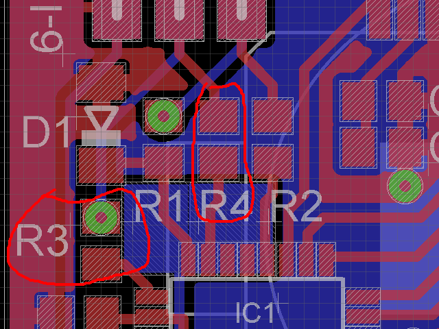

    I have a few questions:
    1) If I read it correctly, is it possible to upload only one version of the program to the programmer?
    2) Is your colleague going to make the option of selecting a file for programming? For example, I upload 10 programs to uProg and choose the current version on the spot
    3) Is it possible to download the program from the microcontroller connected to the programmer (backup)
  • #37 9607844
    piotrva
    Posts: 6409
    Help: 625
    Rate: 735
    1) There can only be one firmware version on the programmer
    2) it is written that in the uProg programmer there is an SD card with many programs, and in the menu we choose which program we want to upload to the programmed system
    3) yes, as long as the processor from which we want to read the program is not read-protected with Lock Bits
  • #38 9608384

    I have one more question for my friend, could my friend share (or send me via e-mail) a piece of bootloder responsible for programming the atmega flash memory, I mean exactly to which registers the colleague sends, what packages (the point is that you have to send to flash by pages) , and what also needs to be scratched in assembly language.

    Please read the description carefully. I know it's very long and maybe you can get a little lost, but it's really there. You can upload any number of HEX or BIN programs to the card and select them from the list. The contents of the system can also be read to a file on the card, files with a sequence number are created. As far as I remember, you can create 255 of them, but if someone needs more, I can increase the number to 65535. So the so-called backup can also be done. The posted video explains a lot.
    As for the bootloader, for the purposes of this project I modified the original bootloader of the avr-dos developer to fit 4kB (because it took up about 7kB). Here are the sources of the bootloader with the modified library: http://www.mcselec.com/index2.php?option=com_forum&Itemid=59&page=viewtopic&p=47233#47233
    I tested on Atmega32 and Atmega328P. But if my colleague just wants to write something to flash memory, there are also examples in the bascom help.
    Klima wrote:
    Could you describe the method of mounting the display in more detail?
    Exactly what? How did I make these handles? Because this display is only held on the handles. There is no need to describe it too much, it is a fragment of such a plugin:
    http://sklep.avt.pl/photo/product_info/4/b/e/1_4be6aaab5d20.jpg
    I do not remember whether male or female, but one of them has these partitions, exactly 5.2 mm wide, and this is the perfect width to catch the display with the plate. It is enough to saw off what is needed and sand it nicely. After that, the display lies on the SD card slot and a contact eraser. The left side is hanging in the air, but you can stick something on because there is too much pressure and you can say goodbye to the display :(

    One more note for people doing the programmer.
    Unfortunately ... I released two processors - through my own fault ... This processor should be programmed from 3.3V or 5V (unpinning the display and card) the entire uProg should be powered.
    As I agreed with the author, to whom I would like to congratulate you once again and thank you for your help, the remaining lines, ie SCK and MISO, should have 220R resistors and a 3.3V Zener diode ... It will be safer.
    Yes, you have to bear in mind that programming a system powered with 3V3 0V-5V signals often ends with pinned ports. You need a programmer with a buffer that can program voltage from the target system, or make resistor dividers or protections in the form of a resistor + zener diode. From poverty, about 470ohm resistors in series are enough.
    There is one more problem (design error) like in prototypes. Let's assume a situation that we want to program a circuit with uThreshold. This circuit on the SPI lines has some actuators or whatever else connected, and let's assume that there is a 5V state all the time. Until the device receives a reset signal, this state will continue as the program is executing. By connecting the uProg to such a system, 5V will flow on the MISO, MOSI, and SCK lines. On board 1.0, only the MISO line (master in, slave out) is secured. There will be a conflict of states on the others. As we know from "absolute maximum ratings" the maximum voltage that can be given on a pin is VCC + 0.5 . These 0.5V is the voltage of the pin protection diode. So the maximum that can be given is 3.8V. During the tests, nothing bad happened because the circuit was powered by the battery, and excess voltage was flowing through this diode to the battery. So protection is also needed on the MOSI (master out, slave in) and SCK lines. Today I will try to release a 1.1 CD with these patches. Unfortunately, I was in a hurry and the boards were produced with this oversight - but this is not a problem because it is enough to cut two paths and solder the resistor to protect these lines. Alternatively, the resistors can be plugged into the ISP cable.
    There is an error in the diagram - the resistor R1 should be 330ohm.
    For now, I am waiting for a display replacement (Chinese) and when it comes, I will be able to further develop the program - I will try to add the options that you have proposed.
    Regards.

    The first update will probably be tomorrow. So far, there are a few bugs in the program and I'm slowly eating them up with a colleague mlassota we eliminate. It's great if someone else tried to make a tile on their own and helped to test, you know that 3 heads are not 2 ;)
    For now, upgrade the board from 1.0 to 1.1 - as you can see it is simple, just cut two paths and solder two resistors that will limit the current of the ports in the case I described in the previous post:
