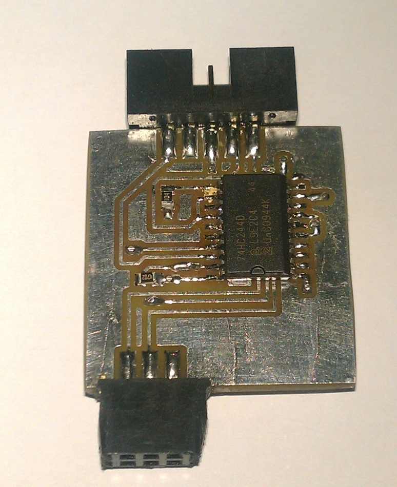

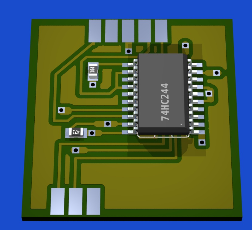

    Hello colleagues
    As I tested the uProg in a system in which I had mosfet transistors on the ports used for the ISP, which gave quite a large load and thus a programming voltage drop, in order to program the processor in the system, the minimum battery voltage had to be 3.4V - then there were no problems.
    But what will the voltage drop and there is nowhere to recharge?
    I made a buffer - traditionally on the 74HC244.
    The buffer is powered from the target circuit, so the programming voltage will be at the level of the target circuit.
    Maybe it will be useful to someone
    It can be connected directly to the connector on the threshold

    I know that the Polygon is not connected to the ground, but it was supposed to be - the socket is much better soldered to the PCB :)

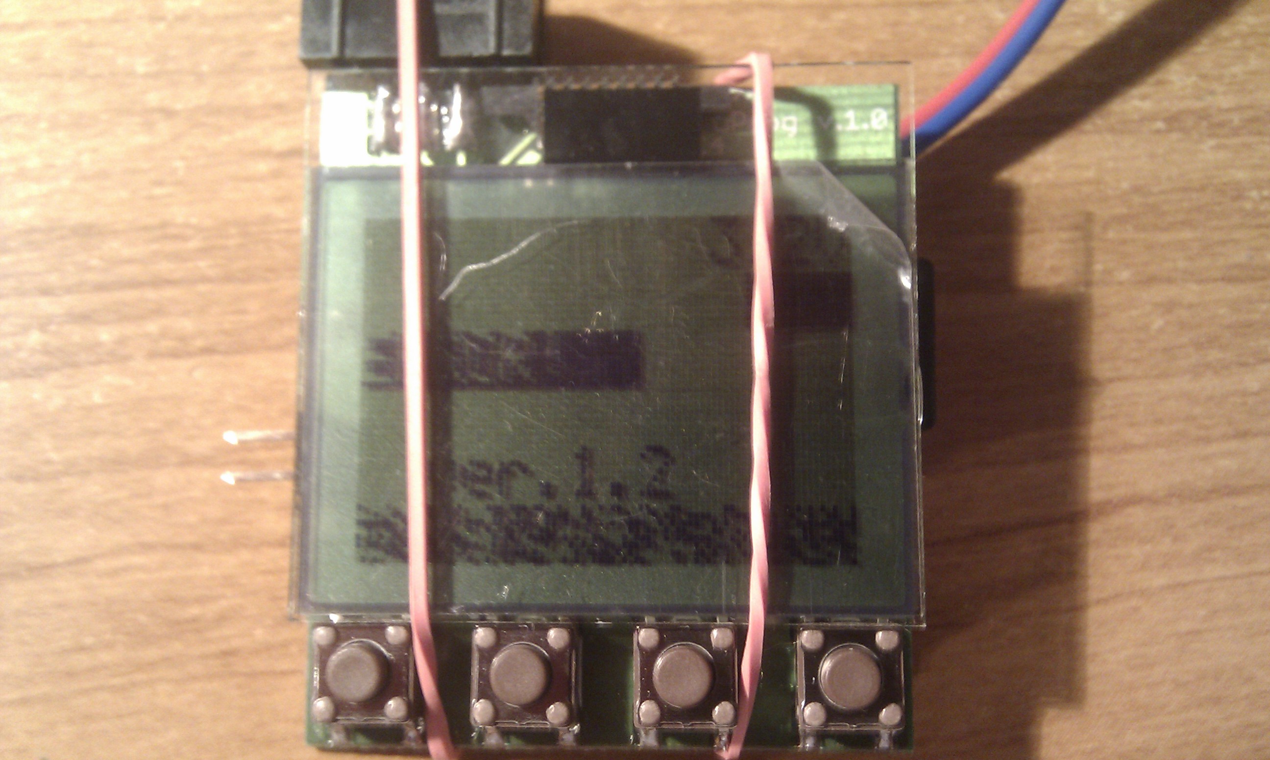

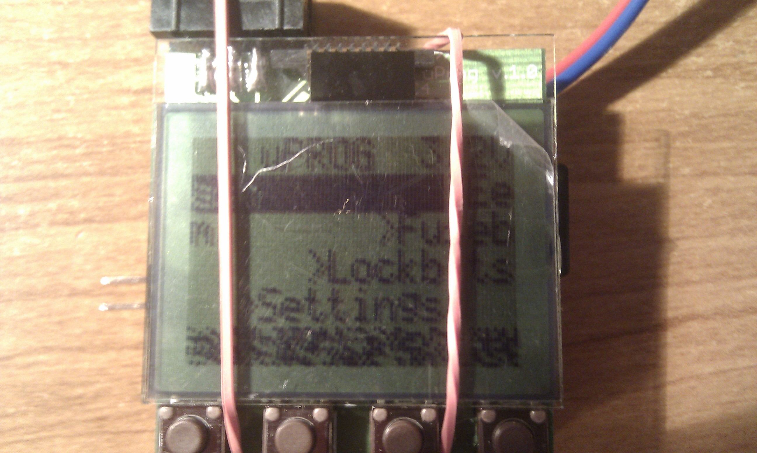

    I am the happy owner of this programmer (board and display were purchased from the author). I just launched it, but it showed an error - you can see in the pictures:
    https://obrazki.elektroda.pl/5043712000_1310929712.jpg
    https://obrazki.elektroda.pl/5393731200_1310929713.jpg
    It doesn't matter if there is a microSD card or not. Reacts very slowly to button presses. Do you have to set anything up in the files on the card?
    Please help.

    This is how it behaves when there is no card - i.e. when it does not see it, or when there are no files on it - Have you uploaded all the directories?

    Yes, but I didn't change anything.

    It should move and no change ...
    How did you set up the Fusebits?
    If you have a GG, send me an e-mail and I will try to help

    Well, you have to change the fusebits, first of all. Second, what's your capacitor next to the SD card?

    Capacitor 10uF as in the diagram. And how to change fusebits? in config.ini?

    You change fusebits in the processor not in config.ini and 10uF may not be enough
    What did you program the processor with?
    On standard 1MHz it will go too, but very slowly

    Capacitor give a minimum of 20-22uF. Fusebits are changed with the programmer ...

    On the display you can see the cut word "SD ERROR", which means that the card has not been initialized and thus no settings from the file have been read. As colleagues advise, the 10 uF capacitor is too small. The diagram is mine, but please read the description - I explained in it something about the initiation of the card and the current it consumes at startup. A 22uF or 33uF capacitor will certainly do the trick :)
    So the circuit is at 1MHz. Be sure to set the fusebits. See the support file in the batch directory. After that, everything should move nicely :)

    O3: If the target system's ISP lines are loaded with something, use a buffer on these lines or reduce the speed manually in "config.ini"
