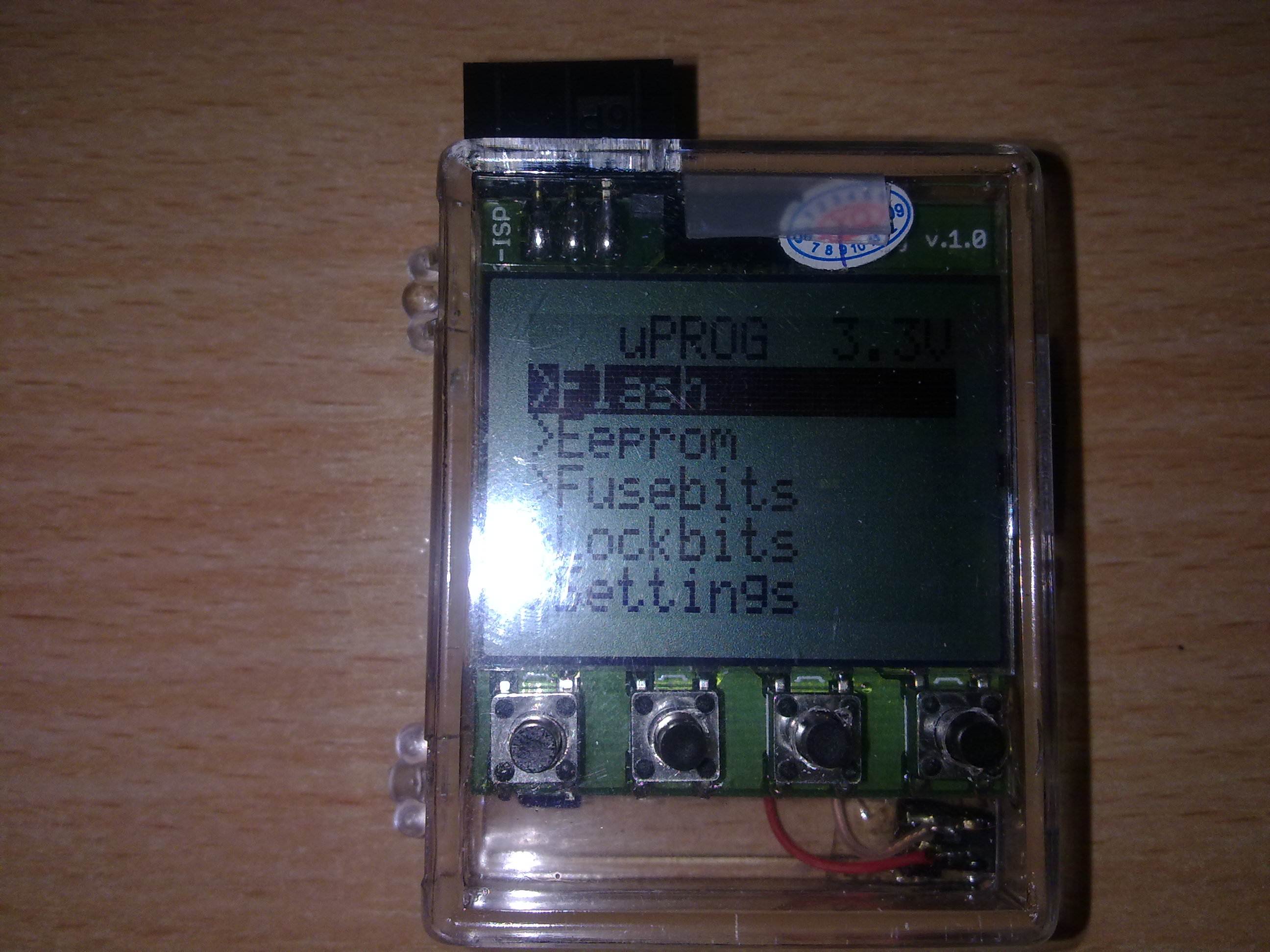

  • #164 9772373
    Sebastian.R
    Level 20  
    Posts: 525
    Help: 14
    Rate: 41
    One suggestion :) Display contacts. there you can use a conductive eraser from another broken display.
    uProg - small, fast, portable AVR programmer with SD
  • Custom housing planned to secure the display

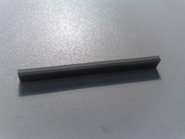

    #165 9772534
    manekinen
    Posts: 1629
    Help: 76
    Rate: 2362
    The rubber band is problematic because it moves easily and disconnects. When buying or picking out the display, we usually already have either an eraser or a badge. The problem is fixing the display :) But soon (I hope) I will show a custom-made housing for uProg, I do not want to write anything more so as not to confuse, but if it goes well, I will have a lot of them and at a good price - I think that with such a housing the programmer will really look like a programmer real :)

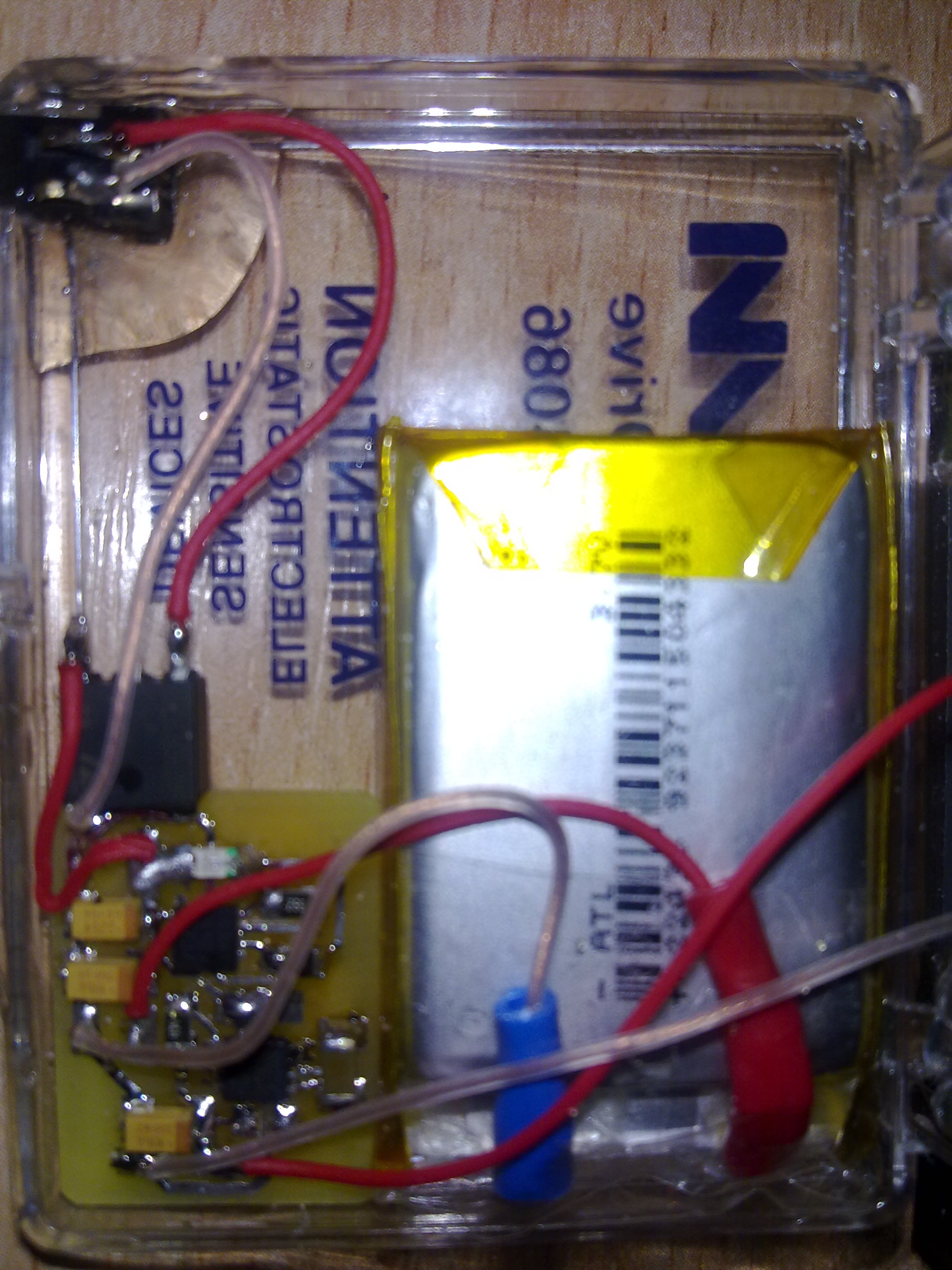

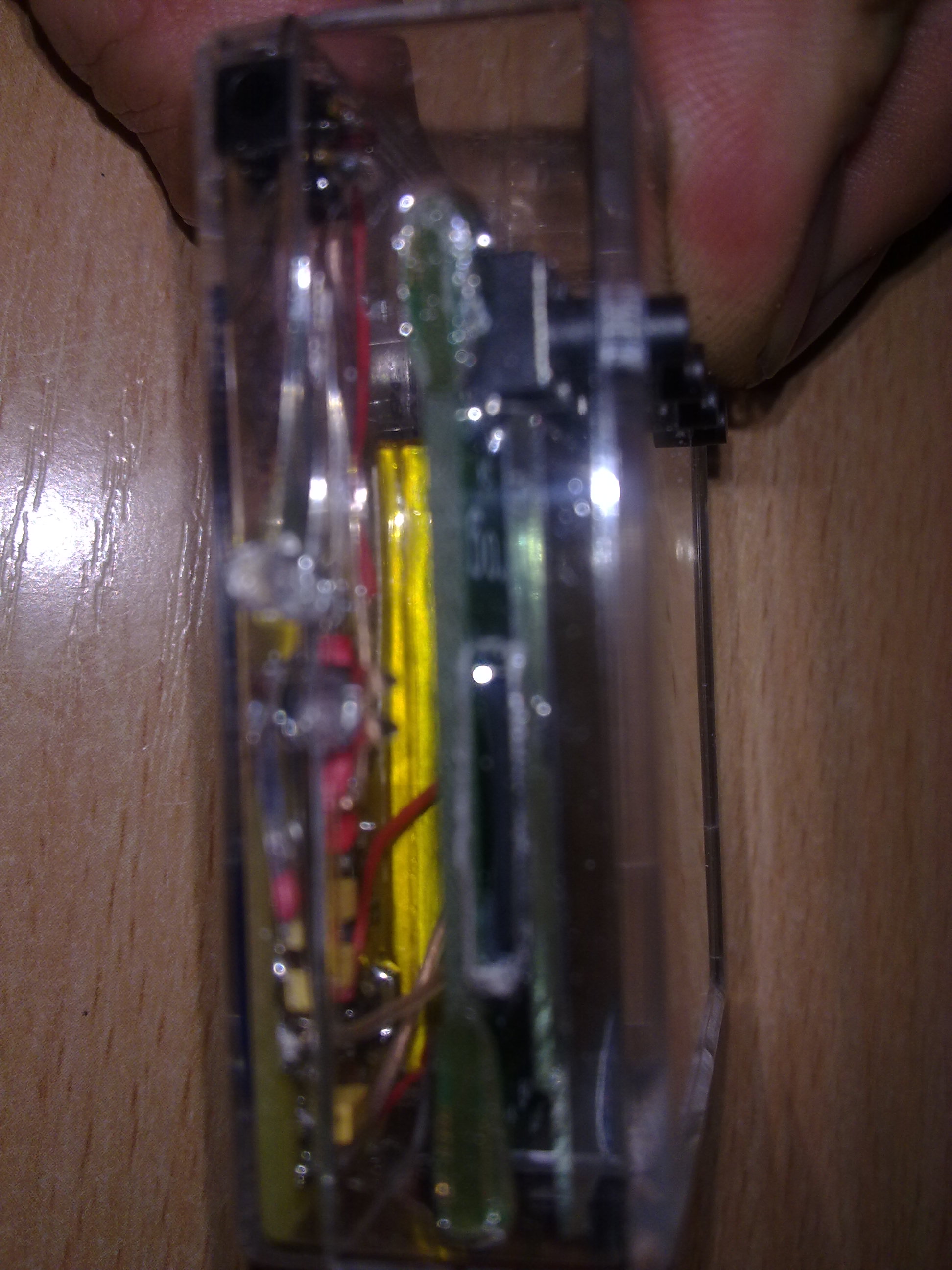

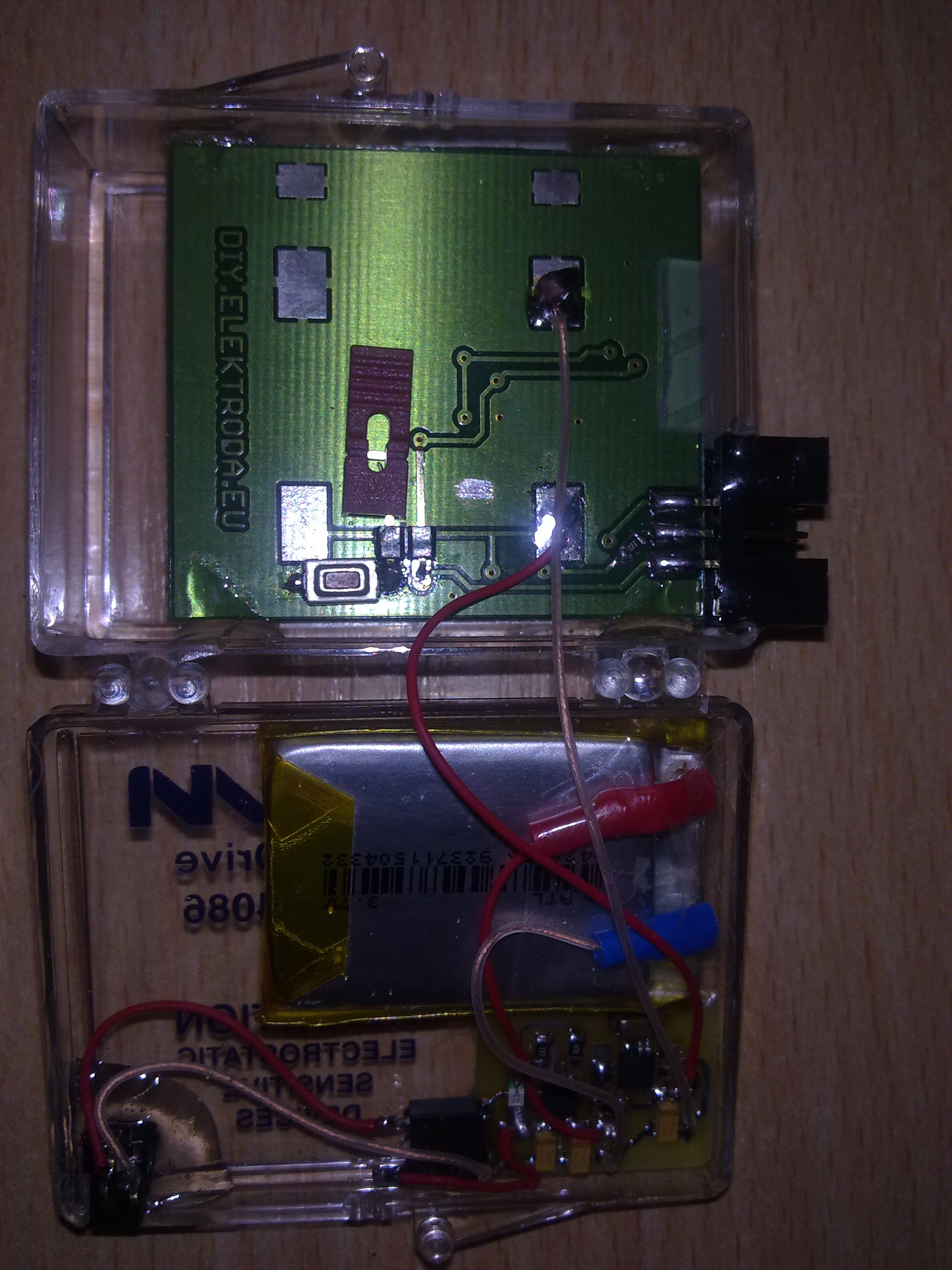

  • #166 9773466
    MatygaD
    Posts: 70
    Help: 17
    Rate: 47
    I made a uProg on a PCB from the author, but I decided to put it in a housing :)
    There was a Maxim sample box lying in the cupboard and I think they were making those boxes under the uProga :)
    Look at the photos for how it fits :)
    Since the batteries always run out as needed, I decided to equip the programmer with battery power.
    I had some Li-poly batteries from Philips MP3 players, 3.7V 500mA and decided to use it.
    Charging from a Nokia charger via the Li-Pol MCP73113 controller and the MCP1252-33 × 50 as a 3.3V 120mA power supply.
    Current consumption from the battery when on, about 9 mA, in standby mode 75uA.
    Pytka and Eagle diagram for download.
    Due to the fact that the Nokia charger can give over 7V without load and the MCP73113 has an OVP of 6.2V between the socket and the module, I added a 78M05 stabilizer which is not included in the diagram and board.
    Manekinen again, thanks for the great project and sharing it.
    Regards
    Darek

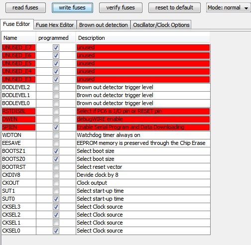

  • #174 9797458
    jajen
    Posts: 469
    Rate: 1258
    I have a request, can someone take a screenshot of the fusebit settings from the BurnOmat overlay? I don't want to mess with coffee grounds, and I don't know how to set Ext: 07, high :D 0, low: A2 with this program.
  • #176 9797495
    manekinen
    Posts: 1629
    Help: 76
    Rate: 2362
    Enter these values in the "Fuse Hex Editor" tab - nothing easier :)
