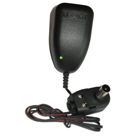

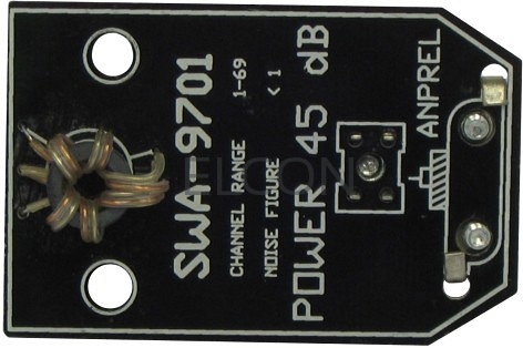

    As for the cable, I recommend the 50ohm H155. It is a cable with good parameters, low loss and is most often used on 2.4GHz wifi. I have the same one in the antenna installation for the tuner and it is better than the 75ohm cable. As for amplifiers, somewhere in this topic I described how to connect them and what types I recommend. I am currently using two SWA9701 and ABL-21 amplifiers.
    It is best to mount the amplifier close to the antenna, I have it done. 30cm for the antenna in a hermetic housing I have SWA9701 I did one more thing, I soldered this choke on the back of the plate from photo 1 and connected the antenna with a cable directly to these contacts as in photo 2.
    Photo 1
    How to use RTL-SDR on a cheap USB DVB-T tuner for HF and 64–1700 MHz?
    Photo 2
    Main vein red.
    Yellow cable braid.
    The power supply may be 12v but I use 13.8v and it works fine. You will also need a voltage separator similar to that of the tv antenna.
    Power supply with a separator

    The thing you have desoldered is the antenna impedance transformer. Due to the fact that I have good experience with closed dipoles, I would encourage you to re-solder it and use such an antenna. The second option is to place the antenna on a mast that extends above the roof of your home and forego amplifiers. And so there is no need to count on pickups over 100km. I am referring, of course, to the reception of the stations you want to listen to.
    PS. use the dipole only, without reflectors and directors. Here it is worth giving up directionality in favor of omnidirectional. It's enough for these solutions.

    If someone uses dipoles as antennas, he can leave them behind. Unfortunately, I use mostly collinary antennas and unfortunately the reception was worse due to this transformer, so I propose to unsolder it. As for the reception of the station, if you have a well-made collinary antenna calculated for a given band and amplifiers, you are able to receive the station from a distance of over 100 km. The sdr tuner has a poor internal amplifier, besides, there are also cable losses, so it is better to use the booster as close to the antenna as possible and in the program you set a lower gain, which eliminates the interference from the tuner itself.

    This transformer is used not so much to convert the impedance, but to match a symmetrical antenna, such as a dipole, to an unbalanced transmission line, which is a coaxial cable. Its purpose is to prevent the cable braid / shield from acting as an antenna.

    You're wrong. The SWA-9701 referred to here is a 300/75 Ohm transformer.

    @ SP5IT Is it only a 300/75 transformer ?? God forbid, it does not deny that there is an impedance matching in it. I am writing this in the context of the collinear antenna used by the col. @don_viking - I treat it as an unbalanced antenna, in this case I consider using a Bal-Un 1: 4 transformer a bad idea. The mismatch between the impedance of the antenna and the impedance of the coaxial cable should with an increase in attenuation - is it so? I mean Bal-Un rather than 1: 4 to avoid a situation where the shield of the coaxial cable does an unwanted part of the antenna, raising the background level.

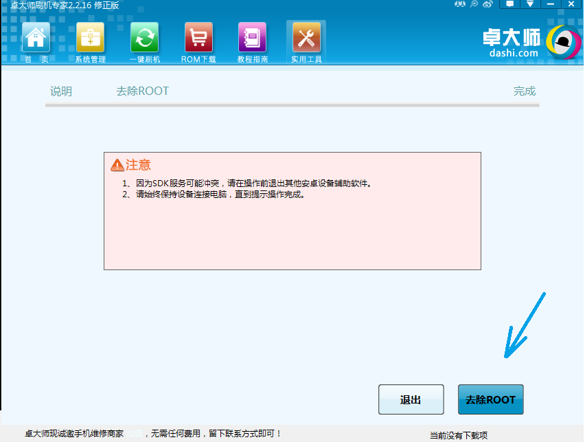

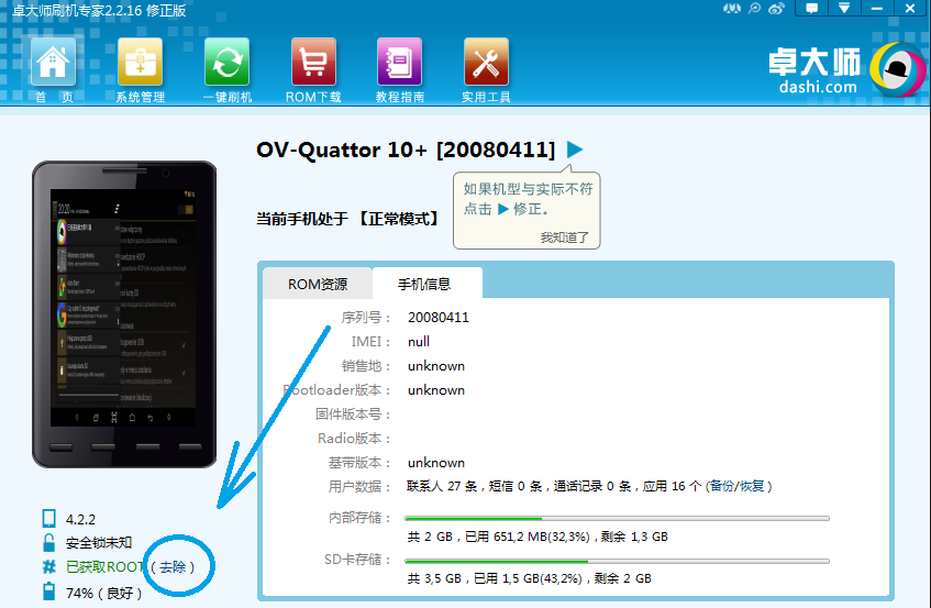

    Install the tablet drivers on the computer, run ZhuoDaShi, connect it to the computer and click this button.
    And then this button.

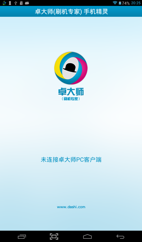

    The ZhuoDaShi logo will appear on the tablet while rooting.

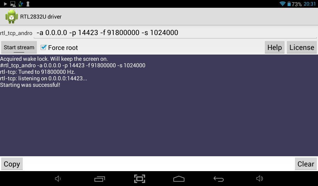

    Install the oldest known to me RTL2832U_driver_2.2 (none newer will fit) and select (permanently) Force root - Start should result in such a message.
    From now on, the driver is ready for operation, and if it does not, it throws such a message.
    Check the physical connection of the RTL-SDR with the OTG cable to the tablet as well as the voltage supplying the adapter.
    Importantly, the USB HUB is unnecessary, the OTG cable has been detected and supplied with a sufficient current of 300 mA from a separate converter - although the OTG tablet does not have.

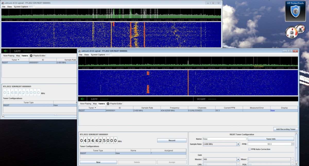

    Hello. Recently I launched sdrtrunk v 0.5.0 alpha 6 on windows and set up a few channels in DMR. It turned out that the program has the ability to decode many channels at once and, more interestingly, the voice is much better than in dsd +. There is an event window, map and other useful functions, the decoder even shows broadcast LRRP information that dsd + cannot decode. The problem is that in the alpha version it does not show the LRRP position on the map. But it shows the positions on the map in the P25 system.
    Link to the program.
    https://github.com/DSheirer/sdrtrunk/releases
    Link to the disc with photos from the program.
    disk
    I recommend especially to those who want to listen to many DMR channels and be up to date.
    After completing the data in the "Alias" tab of individual groups and adding "Identifiers" and selecting "Record", the program records each group separately. Pictures from the settings at the link to the disk above. The audio files are located in the "recordings" directory and the path is set in "Users Preferences" "File Storage / Directories".
    After further tests, I can say that the load on the processor and memory with two tuners running in two program windows is small as you can see in the photo. Also, if someone has the option of dividing the desktop into two different monitors, this is a great thing and one panel will be visible on each of them.
