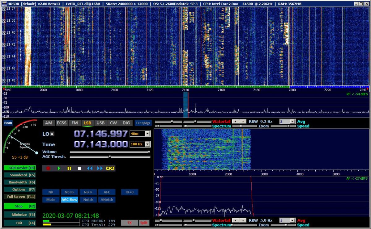

  • #1453 18515539
    ArturAVS
    Moderator
    Posts: 26416
    Help: 2303
    Rate: 7832
    don_viking wrote:
    A new Beta version has been released, I invite you to test it
    To be honest, I do not like HDSDR because of its graphics, although I use it with RSHFIQ (own design) https://www.kickstarter.com/projects/hobbypcb...hfiq-5w-software-defined-radio-sdr-tranceiver. I downloaded this beta, and I am pleasantly surprised by the quality of reception on RTL (direct sampling). A photo from a moment ago;
    How to use RTL-SDR on a cheap USB DVB-T tuner for HF and 64–1700 MHz?
    30m LW antenna at a height of about 5m directly to the RTL (separated by a broadband transformer to the Q RTL input). Compared to SDRSharp, much less noise, but also a lower sound level.

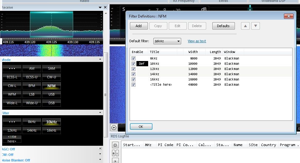

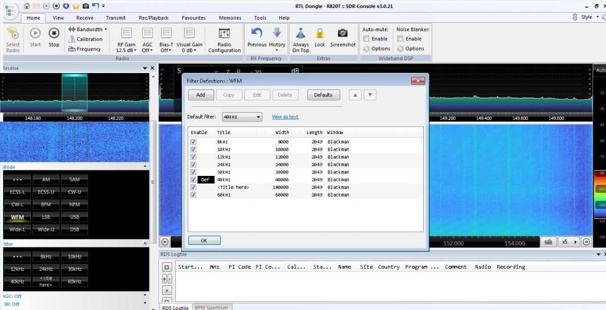

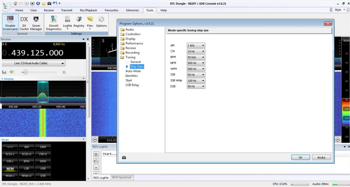

    Hello, I have a problem with Sdr console V3.
    How do I set the mouse to scroll a range? In Sdrsharp, I was able to grab with the left mouse button and move it right or left. Here I only see two buttons on the bottom left and right. It's less convenient.
    Second question: in Sdrsharp I was able to set the bandwidth in NFM to 32kHz, in Sdr console V3 only 16kHz, which makes NOAA reception pointless. In WFM I have a wider band, but the signal is much weaker. Can you somehow set in NFM at least these 32 kHz?

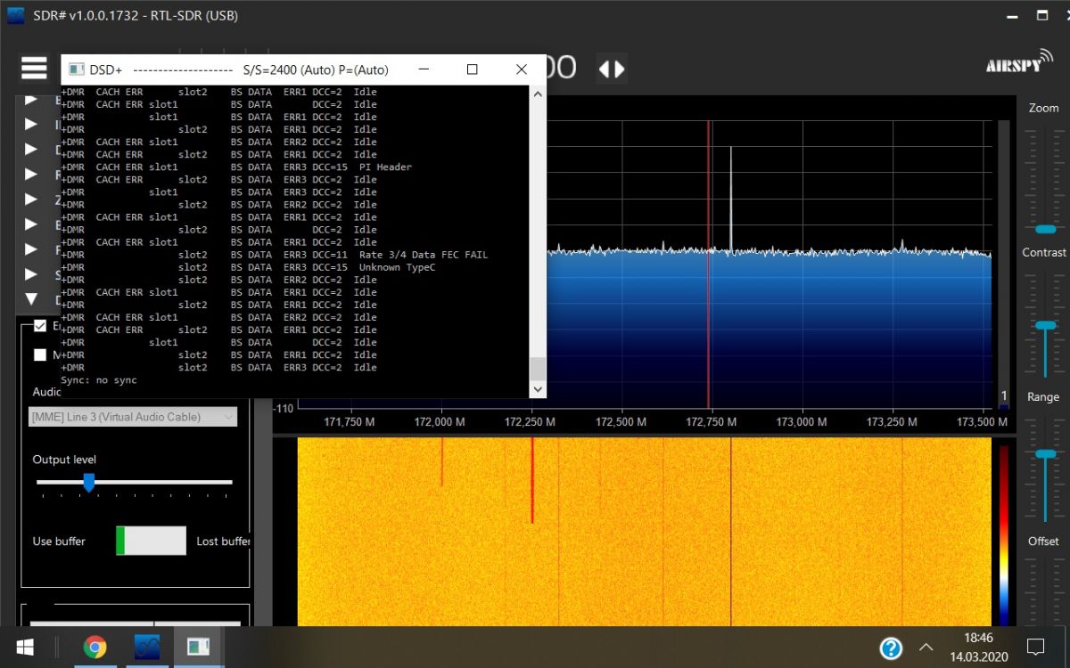

    pawinow
    Posts: 17
    pawinow wrote:
    Hello. How to change the outputs to Dmr
    Added after 2 [hours] 15 [minutes]:
    I cannot change the settings so that the input is on a virtual cable and the output is speakers. Please help
    Hello. Is this channel scrambled or something is wrong?
  • #1459 18531776
    internick
    Level 36  
    Posts: 3081
    Help: 273
    Rate: 555
    Looking at the frequency, rather yes.
    But you are not picturing speech here, but a frame, so it's just a guess. Wait for someone to talk. And you will see in the Event window.
    Besides, you have a lot of mistakes.
    What's your antenna?
    As for the step settings in SDR Console V3, you click Tools, then option, tining and step as in the picture. You set a step for each modulation. Then, while holding the mouse pointer on the spectrum, you spin the mouse wheel.
    As for bandwidth setting, you can manually set the appropriate bandwidth. You click on the left side of the program below the modulation window in the filter window on the three dots. The filter window opens and you can add a new width or edit an existing one and save it as the next one. I suggest using WFM to decode all digital modulations due to the wide bandwidth and the lack of additional filters that cut the top or bottom of the band.
  • #1461 18532505
    antyvlad
    Posts: 10
    don_viking wrote:
    How to use RTL-SDR on a cheap USB DVB-T tuner for HF and 64–1700 MHz? [/url]
    Thank you for your response. Unfortunately, the highest value I can set there is 16kHz :(
  • #1462 18532530
    don_viking
    Level 21  
    Posts: 562
    Help: 14
    Rate: 136
    antyvlad wrote:
    That's why I recommend using WFM and I guarantee you that this modulation will be the best.

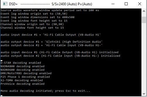

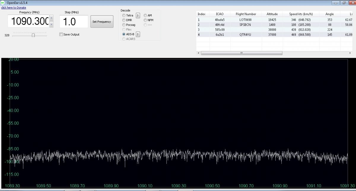

    Apart from the topic, there is a new version of SDRSharper v 1.1
    https://www.qsl.net/sdr/SDRSharper_11.zip
    Has anyone tested the new program " Openear "? Links below. I have a problem with my decoded voice breaking.
    Openear
