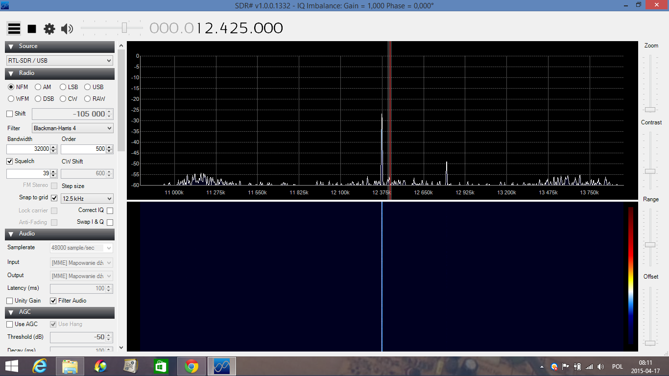

    mkpl wrote:
    Which is, of course, 5 seconds to show. You go through this sensitive point and touch the adc pins with a needle, when the signal jumps in value, you know when it appears elsewhere, the transformation works.
    I touched the ADC pins with a needle, but it didn't change anything. I touched both before and after the condensers.
  • #454 14624029
    mkpl
    Level 37  
    Posts: 5678
    Help: 306
    Rate: 863
    I analyzed both screenshots you posted. Unfortunately, both look like interference from the FM band.
    Were you able to pick up something?
  • #455 14624037
    tomek10861
    Posts: 1371
    Help: 13
    Rate: 199
    At the time of taking screenshots, no. I did them only to show the decrease in signal strength (without the antenna). However, much earlier, when I connected a long cable (about 15m) to the hot wire and grounded the screen, I calmly received radio stations on 5MHz modulated in AM. These were, of course, foreign stations. https://obrazki.elektroda.pl/3804903500_1428088459.png
    In addition, on 17Mhz I also receive AM stations.

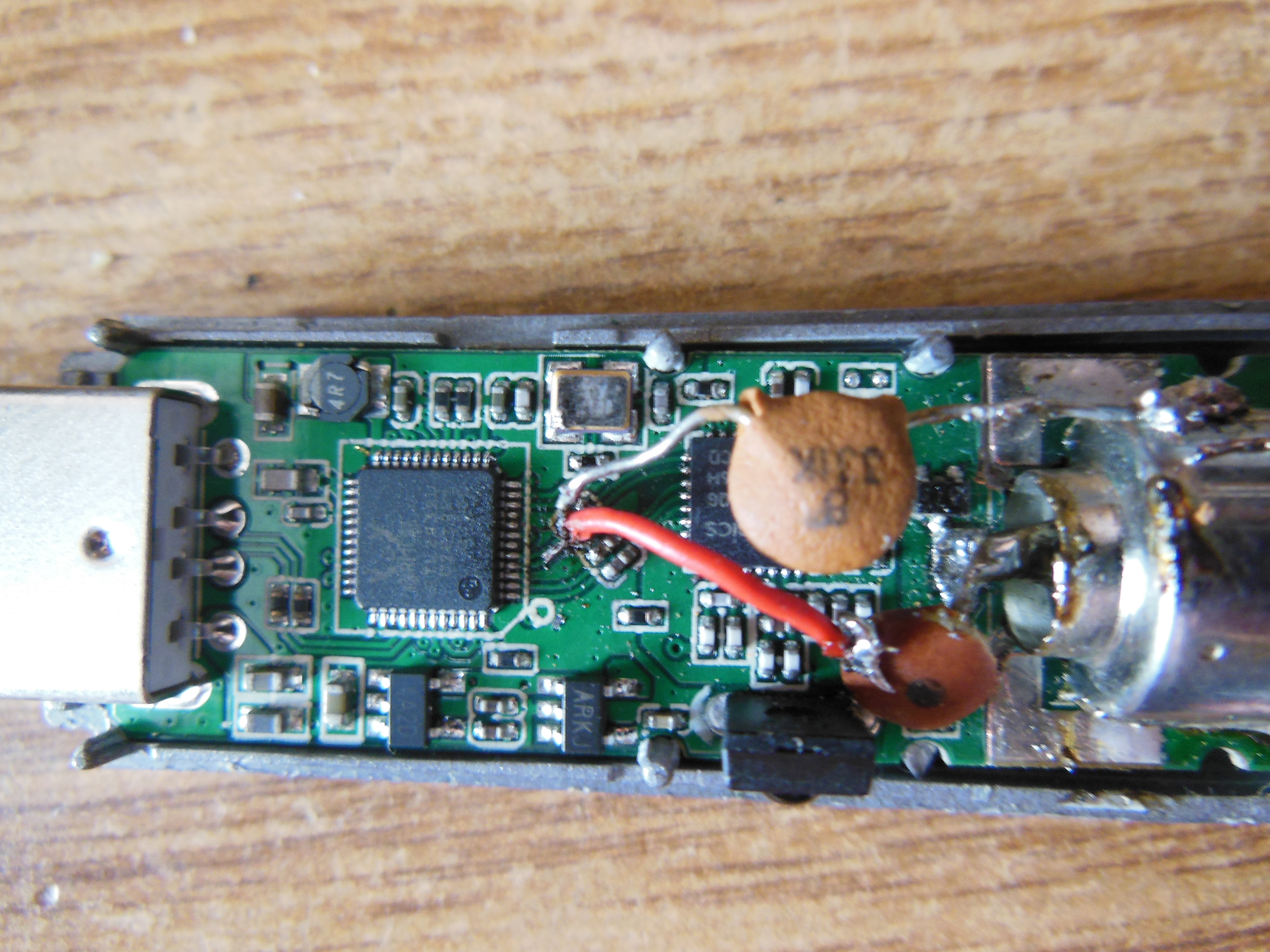

    I noticed that with these new drivers, the 5Mhz reception was supposed to improve, the tuner is not as sensitive as it should. I changed the dongle by completely cutting off the signal from the head. I ran the signal straight from the antenna through capacitors on the RTL2832. Of course, the mass paths to which the antenna socket was soldered had to be cut so that the rest of the system would not wake up. I set "Direct sampling Q-branch" in the SDRSharp settings and I receive signals from 1MHz to 28Mhz on a 1.5 meter vertical antenna. The photo shows the connections. Of course, such a converted dongl is no longer suitable for receiving the band above. There are descriptions on the net how to do it, you can also use a choke, but I gave it up because it lowered the sensitivity.

    don_viking IMHO pity the tuner :) Something else like the head layout burned or something. ;) BTW. since you are modifying the tuner in this way, try to connect the output of the head chip to the sound card (remember to connect the tuner to the power supply).
    For me, Direct sampling is not working. After changing the settings, the program throws an error when you try to press the play button.

    You are right, I decided to convert the dongle because I accidentally fried the E4000 head and therefore instead of throwing it away I changed it. Because of them, I made a short circuit at the antenna input and 12V went there. Therefore, when someone has such a damaged tuner, he can successfully use it as a HF receiver. I don't know what program and what dongle you are using, but I have LV5TDLX, the kf one on the E4000 and for the higher band I use the same dongle only on the FC0013. I also have one for the R820T, but I don't test it that way and I use the band above 1Ghz to receive it. As for the program, SDRSharp and HDSDR. I turn on HDSDR using the driver in the attachment.

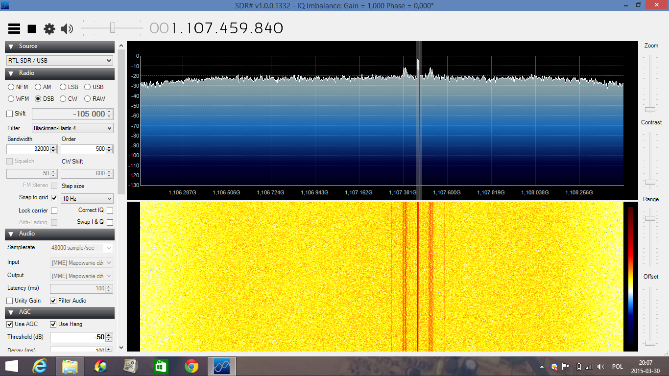

    As for the reception above 1 GHz, any converters, is it just spinning? Has anyone been listening to 2.4GHz? :)
    Except for the topic, this is how the 10Ghz band looks like, I connected to the LBN out of the sat decoder (working).

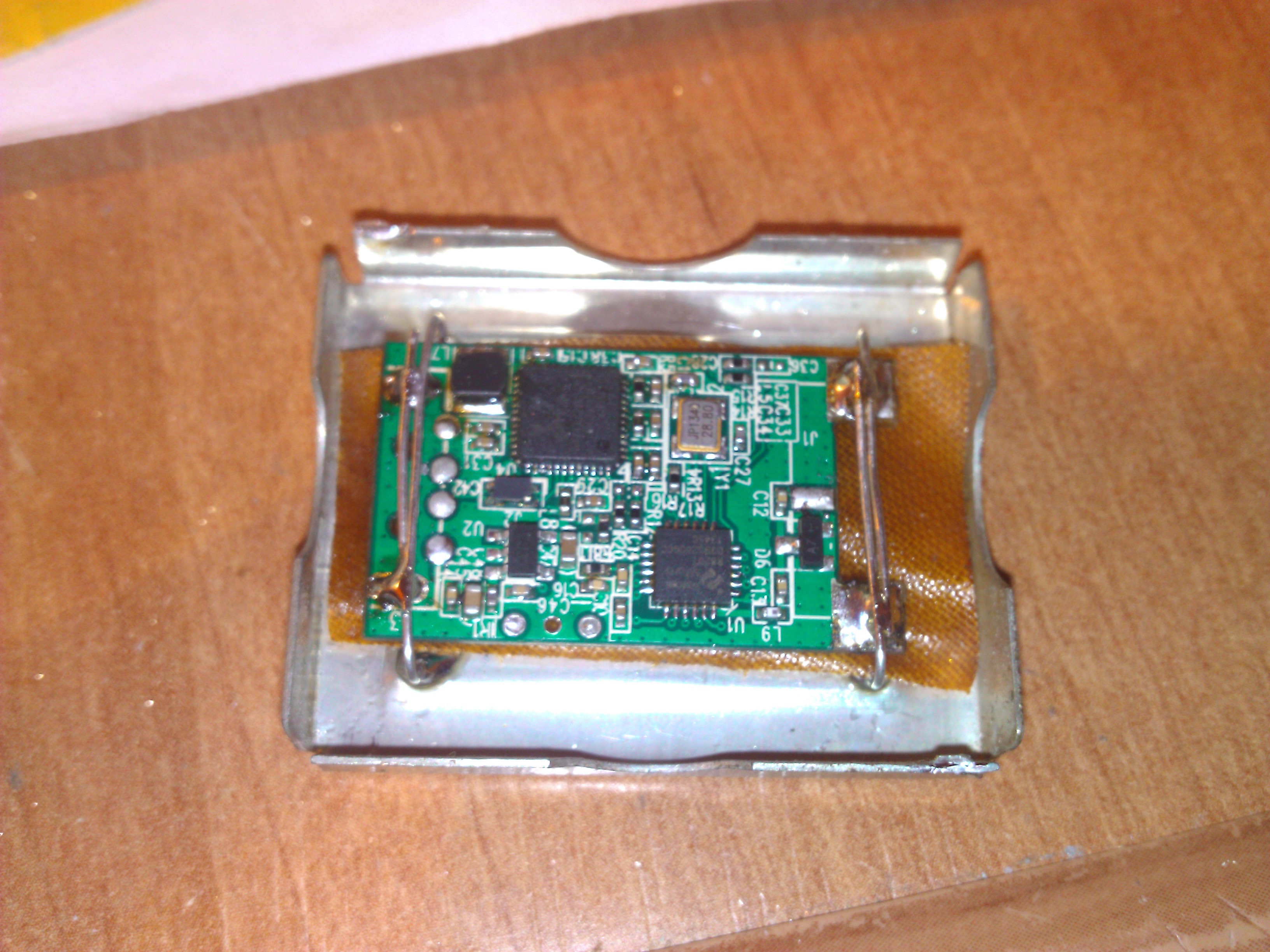

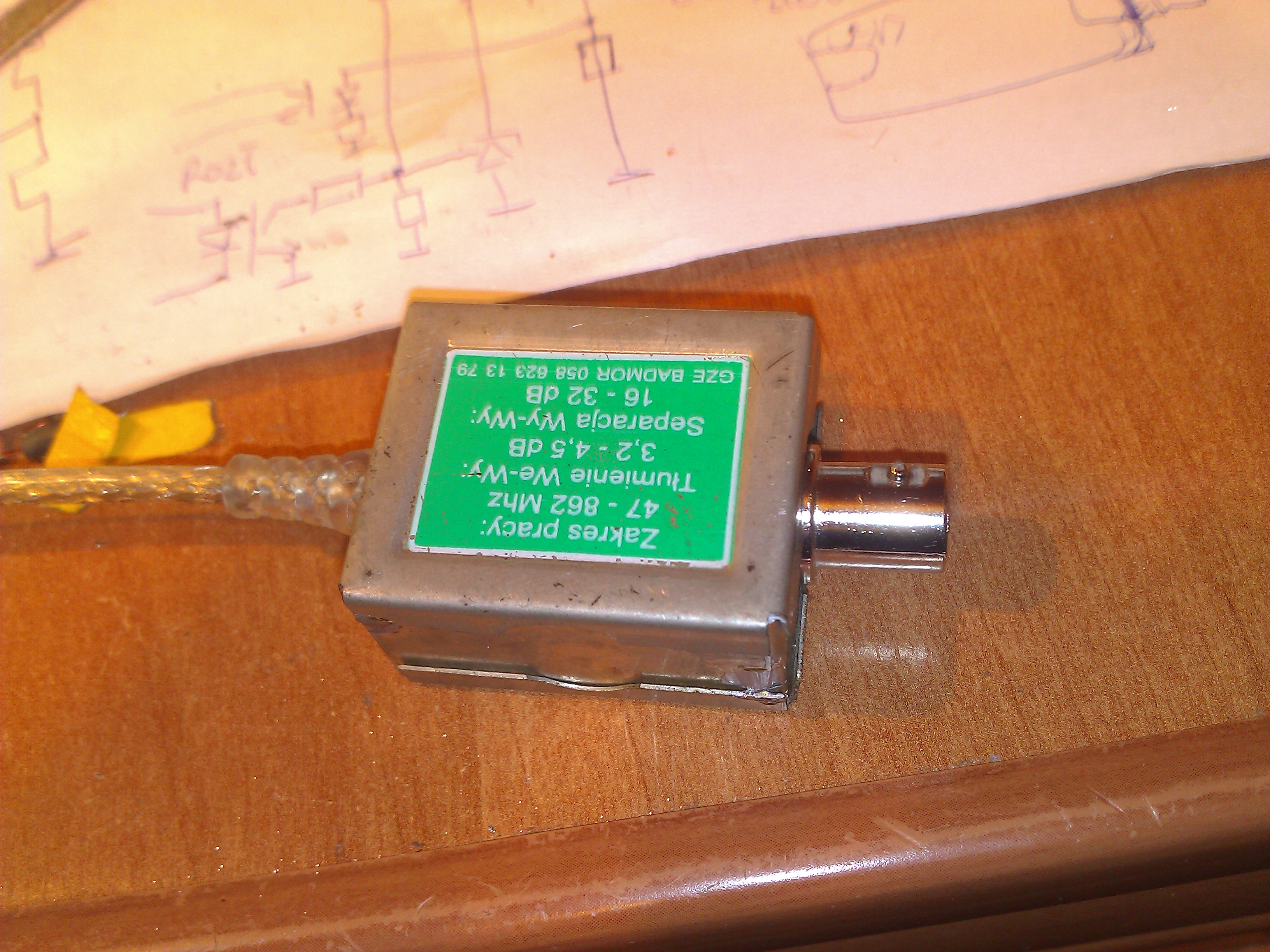

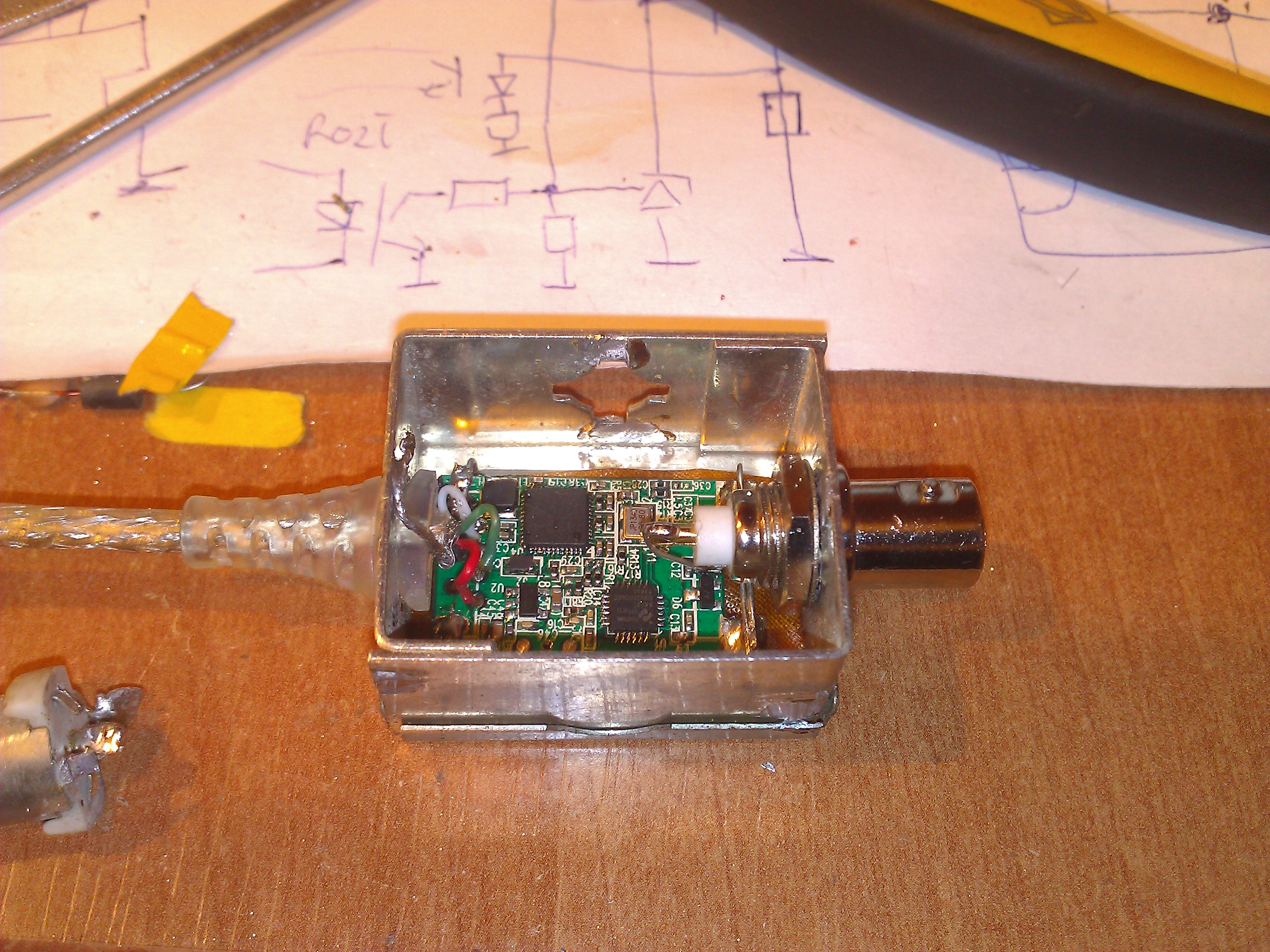

    I wanted to show off my successful modification of the SDR
    I removed the sockets (the usb was factory defective anyway) and the IR receiver because it was unnecessary anyway
    The housing is a BADMOR signal splitter (it fell into my hands and the sockets fell apart).
    A cable from some telephone (the use of a shielded one lowers the noise).
    To sum up. By default, the gain was set to 12.5dB to get noise around 55dB (I live in Mysłowice and have 5km to the transmitter in Costowy ...),
    Currently without antenna -60dB noise at 42dB gain! Revelation!.
    I did not get such effects even by shielding the dongle housing with aluminum foil and by placing x ferrite cores on the USB cable.

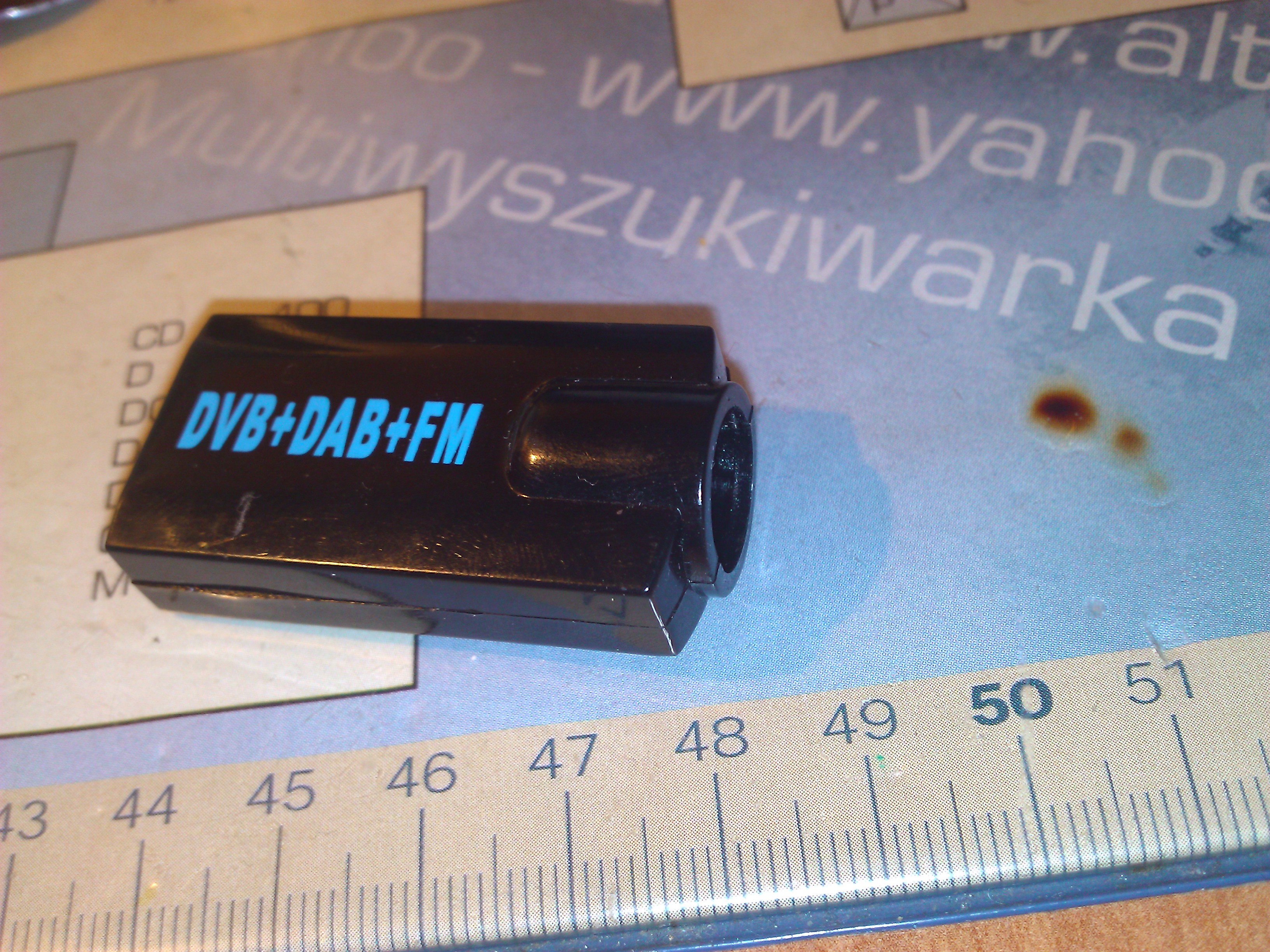

    This is the first time I see a Media Tech tuner with the R820T tuner. Typically, IT systems are installed there, e.g. IT9135 and IT9137. A colleague may give the model symbol of this tuner, eg MT4166.

    I expressed myself badly, the housing is only similar.
    I haven't been able to find anything like mine on the internet ....
    So I throw in a photo of the case :)

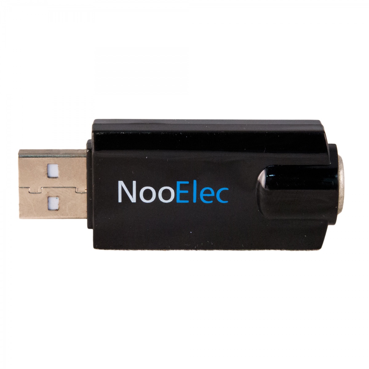

  • #470 14636057
    don_viking
    Level 21  
    Posts: 562
    Help: 14
    Rate: 136
    So you have something else. It is a cheaper version of the tuner from NooElec.
    http://www.nooelec.com/store/nooelec-nesdr-na...l2832-r820t-w-antenna-and-remote-control.html
    This tuner of yours is available on the Allegro for about PLN 55.

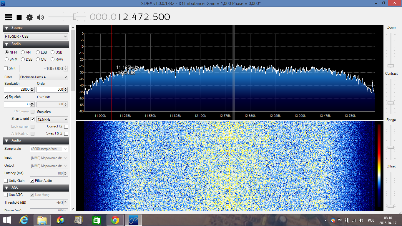

    #472 14639132
    diabelo
    Hello, I bought the R820T2 usb scanner through alledrogo, along with the telescopic antenna for the broadband scanner BNC is about 110cm. And got out. I controlled this whistle, supposedly active on sdhrd, sdr, etc., but you can not hear anything at all, even a commercial radio on 107.7 fm with distortions barely, barely 1 station, audible only when I set the sampling very high and this strong radio from Toruń is known what because I'm about 20 km from Toruń. I did an experiment - put the laptop next to the cb radio, set the frequency, modulations, the spectrum seemed to respond, but the voice was barely harshly mumbling something there. The antennas next to each other, i.e. the CB and the telescopic antenna, were about fifteen meters apart. Antenna screwed on properly. I flew through the instructions, tests, even instructions on you tube. I do not get it. Will someone drive? Or he knows what it is about. And he doesn't want to expose the visitor to the negative, as they say; ignorance does not exempt from responsibility ... because maybe there is a procedure that will make it not junk, but an efficient invention of this Finnish man. best regards

    Enter the tuner options and set the sensitivity.

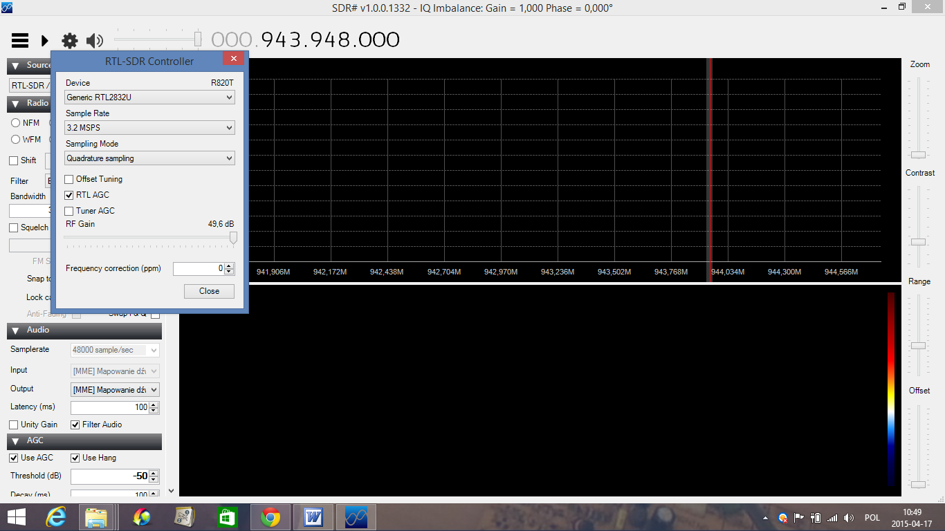

  • #474 14639193
    diabelo
    I will say this: radio stations caught clean, what I do not know, I also have a question: wfm and nfm, squelch is active with nfm, is it just the difference, and this is the same fm? The second thing on hdsdr does not work, but the stations started after the setting you gave me on the screen on the sdr sharp.

    Rate: 199
    WFM - wide fm. NFM - narrow FM. FM is frequency modulation, which means that the transmitter detracts a bit, and AM is amplitude modulation (that is, transmission power regulation). Thus, this frequency modulation can be wide or narrow. Squelch is active - you can turn it off however you want. What can you listen to? Catch my video (maybe the admin won't get upset :P )
    For the test, fire around 930Mhz, you should hear GSM.
  • Using a 12 V separator for satellite LNB reception
    How to use RTL-SDR on a cheap USB DVB-T tuner for HF and 64–1700 MHz?
    I think that the effect would be better if you connected this DVB-T dongle through the separator directly to the converter. Remembering that you would need to supply the converter with voltage of about 12V (writes sat on the back of the tuner) through this separator. Then in the band between 900Mhz and 2200Mhz you should be receiving the satellite signal. Converter - what is it? Satellite converters are devices used to shift and amplify signals in the ranges 10.7 - 11.7 and 11.7 - 12.75 GHz in the range of the first intermediate satellite frequency (950 - 2150 MHz).
    Separator needed? :) I will do some research, but at 10GHz, apart from satellites, there is nothing interesting :)

    You need a separator, because the LNB requires a power supply, and the polarity is switched by voltage. 14V - vertical, 18V - horizontal
