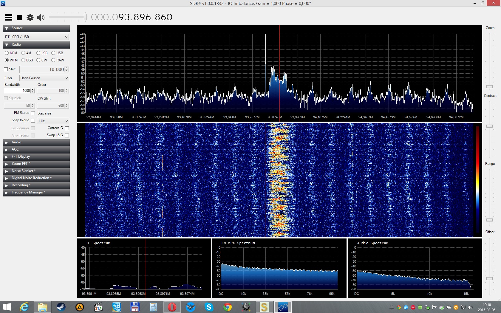

    What am I wrongly positioned? SDRSharp goes up to 93Mhz, nice "bar" next to it there is noise I aim exactly and there is silence :( as if it was just a carrier without modulation.
    How to use RTL-SDR on a cheap USB DVB-T tuner for HF and 64–1700 MHz?
  • #402 14411171
    Tommy82
    Posts: 12141
    Help: 455
    Rate: 1074
    Take a screenshot
    Maybe you have the wrong modulation set or the squelch is twisted too much.
  • #403 14413802
    Cataclysm
    Posts: 33
    1kHz bandwidth on WFM is not enough, and fft and waterfall do not look promising.

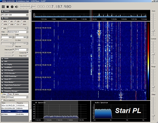

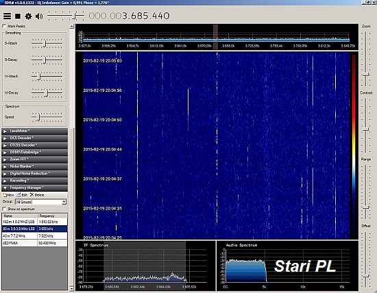

  • Modified drivers enable R820T reception from 13 MHz
    #407 14457569
    Stari PL
    Posts: 8
    lysy1980 wrote:
    There will be a post under the post, but I do not know if anyone mentioned modified drivers for receiving frequencies from 13MHz on tuners with the R820T chip?
    In the attachment, the SDR SHARP package is enough to replace the files and run the program.
    Screenshots of the work of a "bare" tuner on the R820T2 system with modified rudders. The antenna placed in the room is made of a coil that demagnetizes the cathode ray tube.
    40, 41 and 80 meters in the drops.

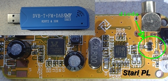

    Rate: 20
    AVE! I read the whole topic and read about securing the input with a diode, but not how to do it, can someone explain to me? I would like to know how you can crack a small RF amplifier. Additionally.
    Thank you greetings!

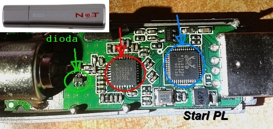

  • R820T2 compatibility confirmed; tuners include input protection diodes
    #410 14463113
    Stari PL
    Posts: 8
    lysy1980 wrote:
    Well, but you check the R820T2 and these drivers were created for its prototype and they also work.
    This is exactly what users describe, I personally checked on the R820T2.
    Check if your system does not already have one.
    My tuners are equipped with diodes:
    How to use RTL-SDR on a cheap USB DVB-T tuner for HF and 64–1700 MHz? How to use RTL-SDR on a cheap USB DVB-T tuner for HF and 64–1700 MHz?
  • #411 14465934
    KamiJas
    Posts: 200
    Rate: 20
    I thought that the SMD transistor is not a diode. And there is some way to reduce the noise from the mesh antenna because the dvbt will not pick me up on it, but in gqrx it shows me a fairly strong signal on all dvbt frequencies from Tarnów. Radio stations can be listened to without any problems, I heard even conversations around ~ 430MHz
  • #412 14466032
    Stari PL
    Posts: 8
    exactly two;
    BAV99

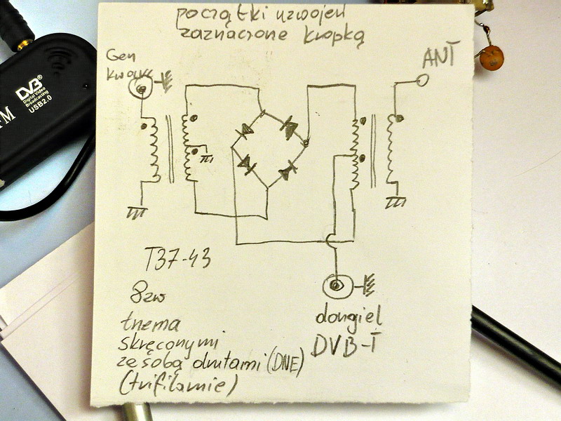

  • #417 14503070
    methyl
    Posts: 183
    Rate: 32

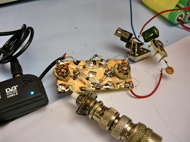

    All coils are wound on a cotton swab-tube and are 2.5 mm in diameter. The other dimensions are the winding length.
    In my opinion, a bad idea because it is very inaccurate and the "goodness" of these coils is also bad. But it sure works because it's not narrowband filters.
    My advice, get 2 ferrite cores from antenna baluns or buy 1 PLN for example ft37-43 plus 4 some germanium diodes, but there can also be ordinary 1n4148 and some winding wire.

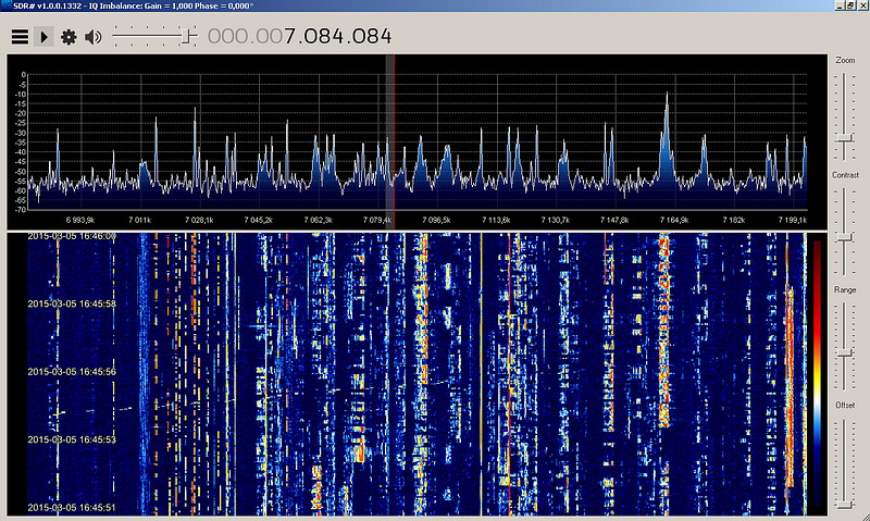

    Out of boredom, I have just assembled a converter for HF.
    Below is a photo of what it looks like and a screen shot of the 40m band listened to on this DVB-T converter and dongles. It is much nicer than the NE602 and the TA7358 not to mention. I know because I have a converter for NE612 (602) and I used to do it on TA7358.
    • How to use RTL-SDR on a cheap USB DVB-T tuner for HF and 64–1700 MHz? rys.jpg (159.78 KB) You must be logged in to download this attachment.
    • How to use RTL-SDR on a cheap USB DVB-T tuner for HF and 64–1700 MHz? zrzut.jpg (211.34 KB) You must be logged in to download this attachment.
    • How to use RTL-SDR on a cheap USB DVB-T tuner for HF and 64–1700 MHz? ringmixer.jpg (151.21 KB) You must be logged in to download this attachment.

  • #419 14503604
    tuner22
    Posts: 57
    Ok, I have diodes, too, because I was buying today, but it is about the connections of these windings, I understand that the middle of the "secondary winding", the end and the beginning of the winding from the generator side to ground, and from the antenna side to the dongle, and the question of the quartz generator, I see in the photo that you have connected output via potentiometer and capacitor. What values are supposed to be. And with what wire to wind it is about wire diameters
    Thanks
  • #420 14504060
    kriss51
    Posts: 5630
    Help: 672
    Rate: 482
    For such a mixer, all LEDs must be matched to their characteristics. They must all be the same. I would like to add that such a mixer has 5-7dB attenuation.
    Did you connect the NE602 symmetrically and accurately matched its input (3K) to 50? using transformers so you say?
