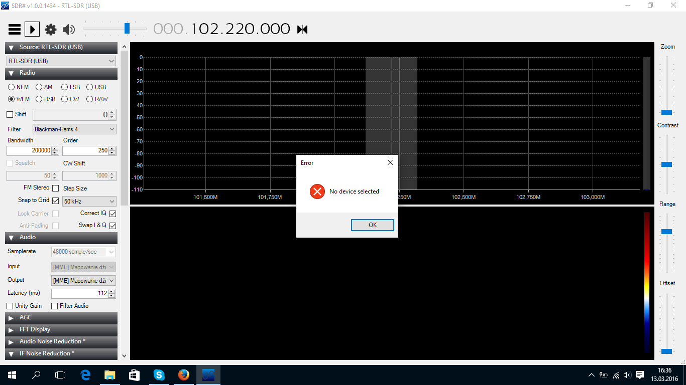

    Hello, could anyone describe the step-by-step procedure for installing the DSD + program for decoding mototrbo. I already have a Zadig installed and I receive aircraft positions from ADS - B. I have a problem with SDR to listen to, it shows me that it does not detect the device.
    As for searching the forum, I did it, but I found nothing that would describe the installation process step by step.
    Below I post a screnn with an error.

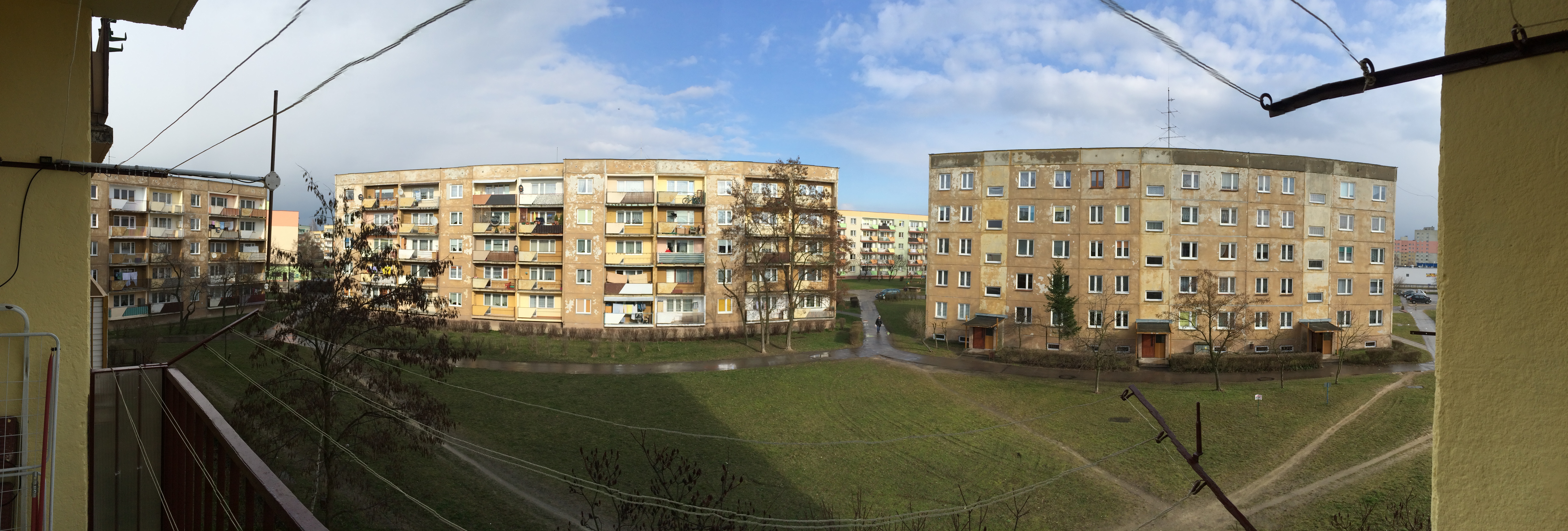

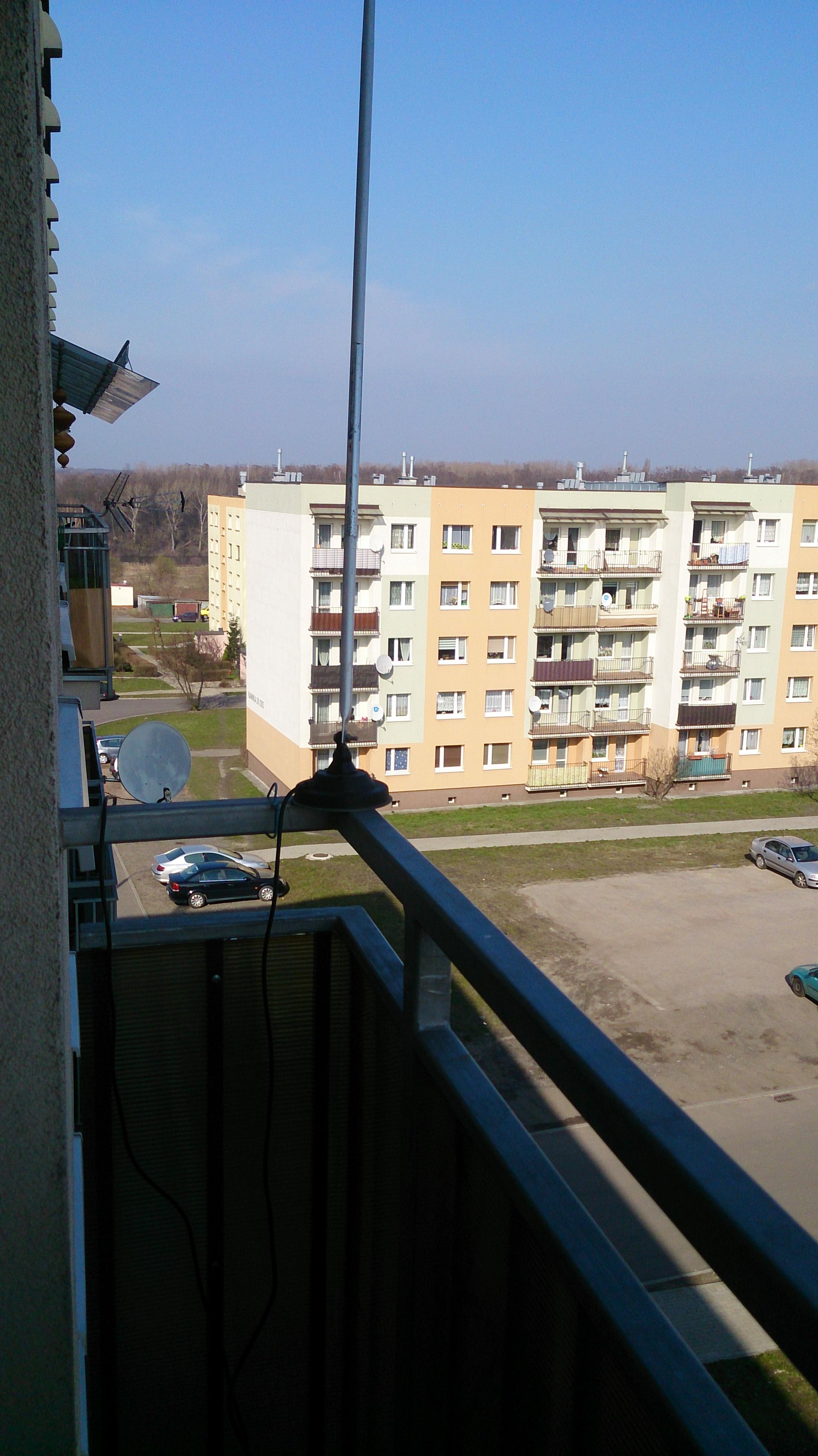

    How to use RTL-SDR on a cheap USB DVB-T tuner for HF and 64–1700 MHz? This is my antenna made of a ski pole, screwed to the base of the magnetic CB antenna, and I can pick up all stations from about 20 km, I think you can pick up more on the wire,
    Added after 21 [minutes]:
    The antenna looks east, west and south, I can't see Gliwice from the north.

    How long is the radiator? You will get a much better reception if you connect the cable braid to a metal railing. Best to make 1/4 wave counterweight.

    Tomorrow it is coming, but at this point the antenna picks up the best and I have no noise, because I moved to other places and there were problems with receiving it due to noise, the SDR receiver is DVB-T FM DAB 820T2 & SDR

    but at this point the antenna picks up the best for me and I have no noise
    I have not written anything about relocating the antenna. It's just about the counterweight.

    To my colleague Kriss51, the radiator is 112 cm long, the diameter at the bottom is 18 mm and at the top 10 mm, the antenna base is metallically connected to the balustrade through a metal base to which the cable shield is connected, I can sacrifice a stick and shorten it every few cm or the reception will improve.

    To colleague Kriss51, the radiator is 112 cm long,
    For 150 MHz, the radiator and counterweight must be 50 cm each. 112 cm is definitely too much.

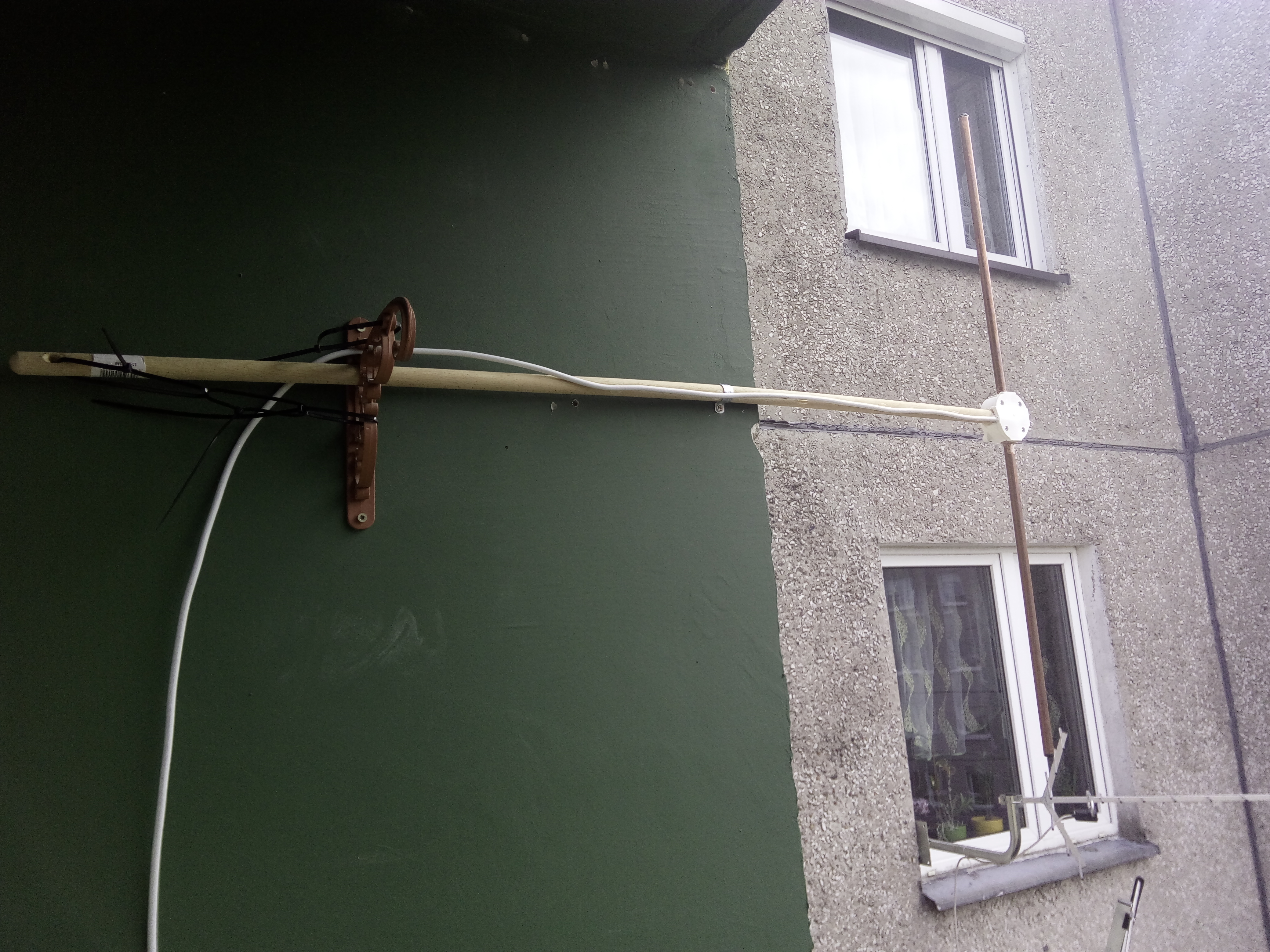

    For starters, move the antenna further away from the building wall, as the roof antenna won't help.

    KamilOc wrote:
    Siemano, I'm not satisfied with the range, where I receive from a DVB-T decoder and a half-wave dipole antenna .. What do you think about whether to buy a radio? Anything would help? Here, for example, this radio I wanted to buy but I wonder: http://www.banggood.com/Wholesale-BAOFENG-UV-...-Transceiver-Radio-Walkie-Talkie-p-61066.html
    Well, see for yourself that the antenna has nowhere to expand to catch the signal, I will not say because I can hear the control panel with 20 KM in the evenings, but mobile stations are approx. 2km, 3km, 4km, you can't hear it anymore, no noise ... Yes it looks like the encirclement of blocks around me:

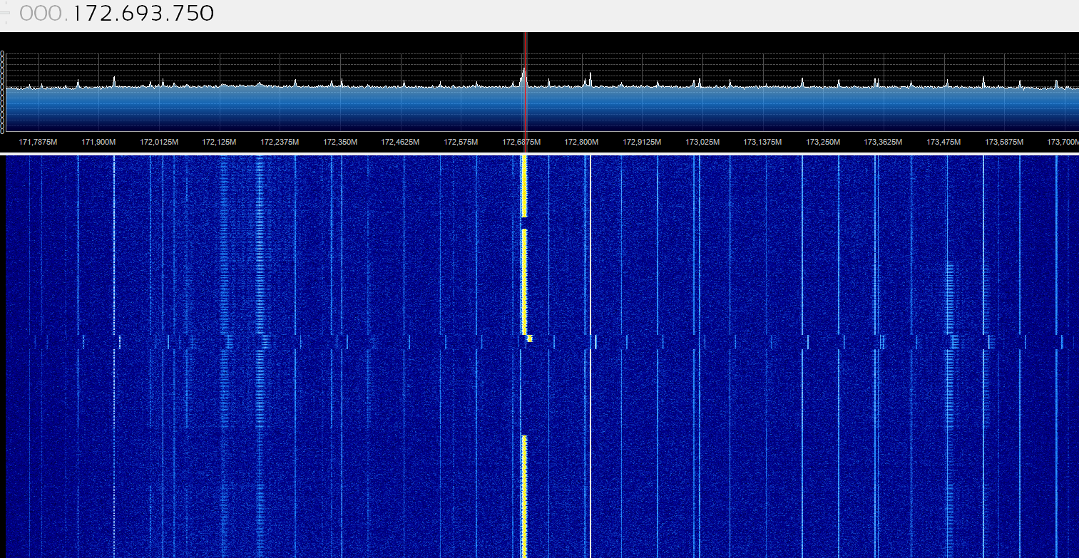

    What could it be?
    You hear a humming noise that stops from time to time.

    Most likely your PPM is misconfigured. This is most likely a transmission on 172.6875.

    He asked "what is it" - meaning "what transmission", not whether it has a well-set PPM.
    It is a digital voice broadcast.

    First you need to know what's going on there, not to write in the dark.
    When a colleague corrects the PPM, it may turn out that there is nothing to decode there.
    This system has been launched, but 99% no one is working on it. And what you can see is just a regular frame.
