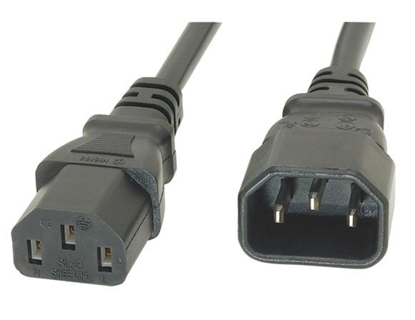

    Anyone know where in Warsaw or nearby you can buy an MCX-IEC adapter? Or even better how to do it yourself. My dongle is blue, with "NooElec R820T2 SDR & DVB-T NESDR Mini2" on the housing.
  • #889 15731378
    lysy1980
    Posts: 2238
    Help: 209
    Rate: 324
    How to make? Either buy MCX plug + cable + IEC socket, or cut the antenna from the set, (leave the cable with the plug) buy an IEC socket for the RG174 cable and clamp or solder.

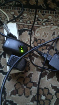

  • Poorly shielded antenna cable causes platform-dependent SDR interference
    #890 15731634
    mrqpa
    Posts: 113
    Help: 5
    Buying in my case is not that simple, I can't get this adapter anywhere, and I don't really trust various types of auction sites. Cutting the antenna from the set is not an option, the cable that connects the receiver with the antenna is very poorly made and allows a lot of interference. It is interesting that these disturbances are greatest when I listen in on the Windows + SDR # set, and much smaller on the Ubuntu + gqrx set.
  • #891 15732210
    Tommy82
    Posts: 12141
    Help: 455
    Rate: 1074
    @mrqpa
    It may be that something is working under Windows that is disturbing you. A very interesting observation.

    Of course, from a leaky cable installation :|
    I understand well that you mean such an IEC connector?
    How to use RTL-SDR on a cheap USB DVB-T tuner for HF and 64–1700 MHz?
  • #894 15732744
    lysy1980
    Posts: 2238
    Help: 209
    Rate: 324
    Antenna IEC (COAX)
