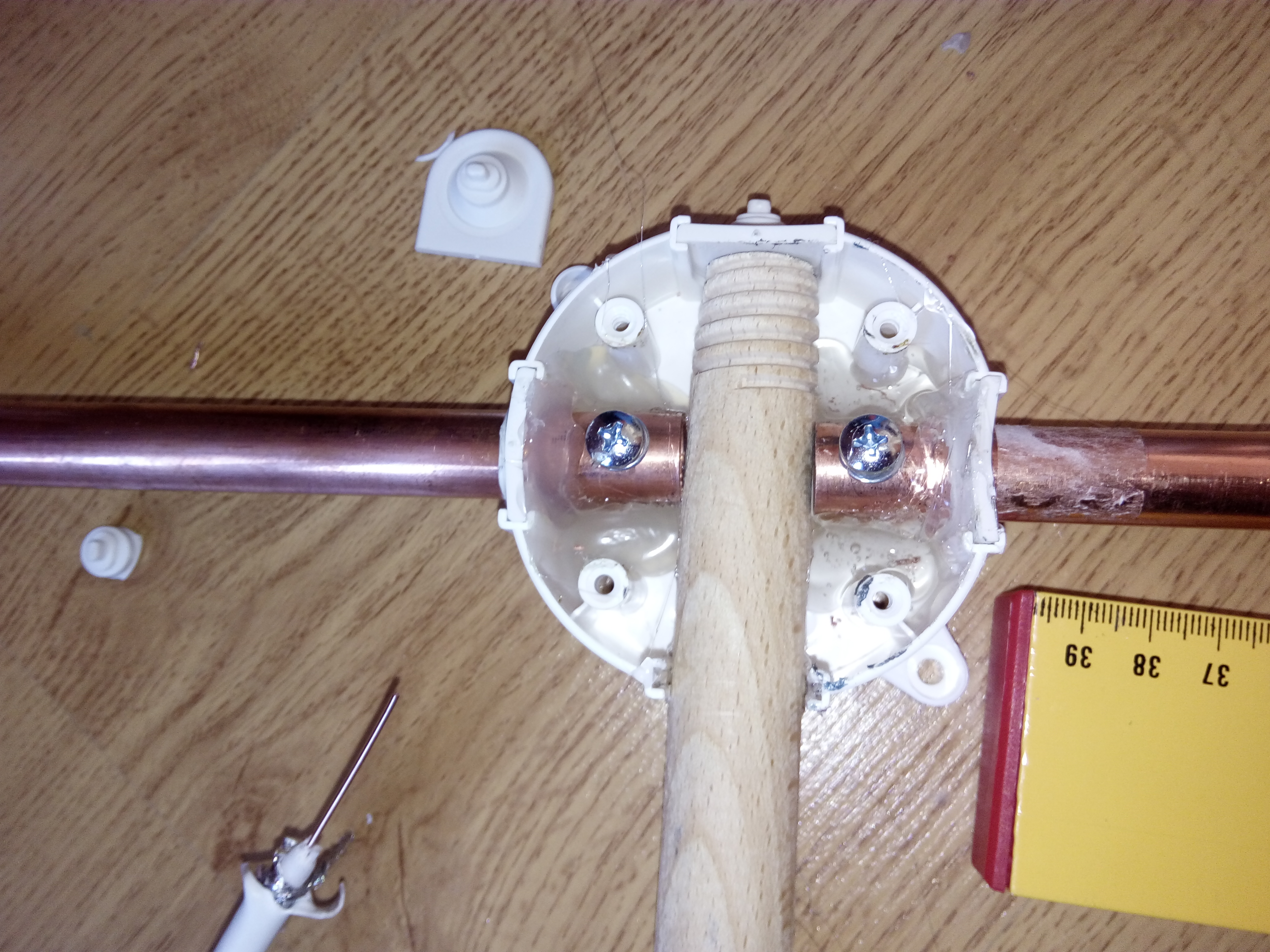

    Will copper tubing have better reception than 2.5mm copper tubing? Because I do not know if I should make a new antenna from pipes :) and what about this frequency scan anyone have any idea?
  • #764 15410677
    kriss51
    Posts: 5630
    Help: 672
    Rate: 482
    Generally it makes no difference. If only mechanically grasped it, it would not break or deform under its own weight.
  • #765 15410799
    czakos
    Posts: 85
    Damn because I bought tubes hoping that the reception will be better than the wire from the electric cable :) and, of course, the broomstick, because the stick would not be able to withstand it :) tomorrow I will post photos after I put it together. :) Anyone know where in the block I can install the antenna? Because I have a balcony on the balcony, but the blocks form a horseshoe, so I wanted to throw it on the roof, but it is too noticeable. I ordered 9 m of cable and I want to throw naked on the chimney above all the blocks because she is not so conspicuous :)
  • #766 15410863
    internick
    Level 36  
    Posts: 3081
    Help: 273
    Rate: 555
    They once taught me that the larger the diameter of the tubes, the wider the dipole works, but I have no physical explanation for it.
  • #767 15410929
    kriss51
    Posts: 5630
    Help: 672
    Rate: 482
    A broomstick? Better to use the tubes.
    They taught well, but on the reception it doesn't matter. What else, if you wanted to broadcast, you will immediately see the difference.
    internick wrote:
    but I have no physical explanation for that.
    The larger diameter of the radiator represents a larger capacitance. Generally, the L \ C ratio of such a radiator changes.

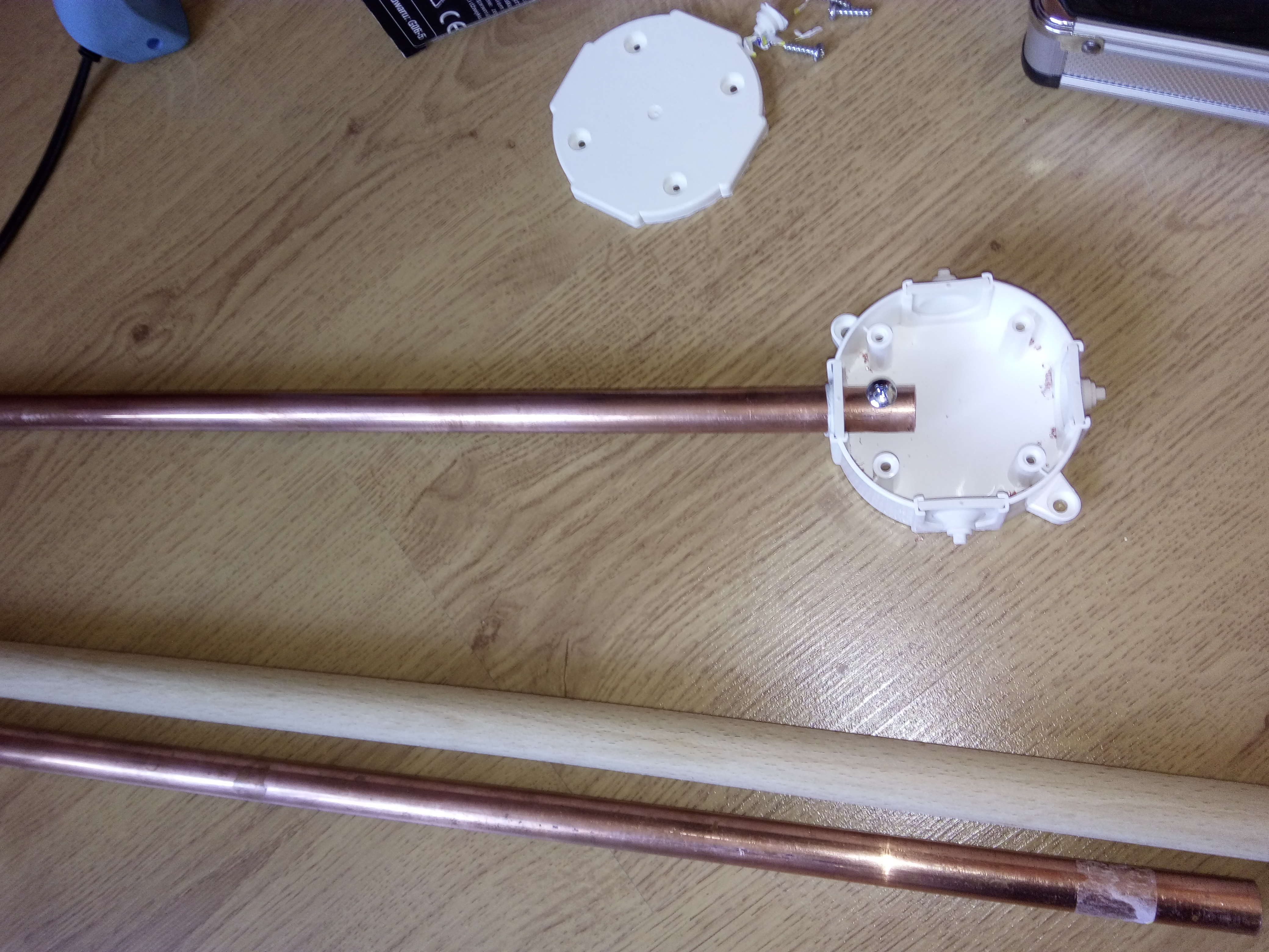

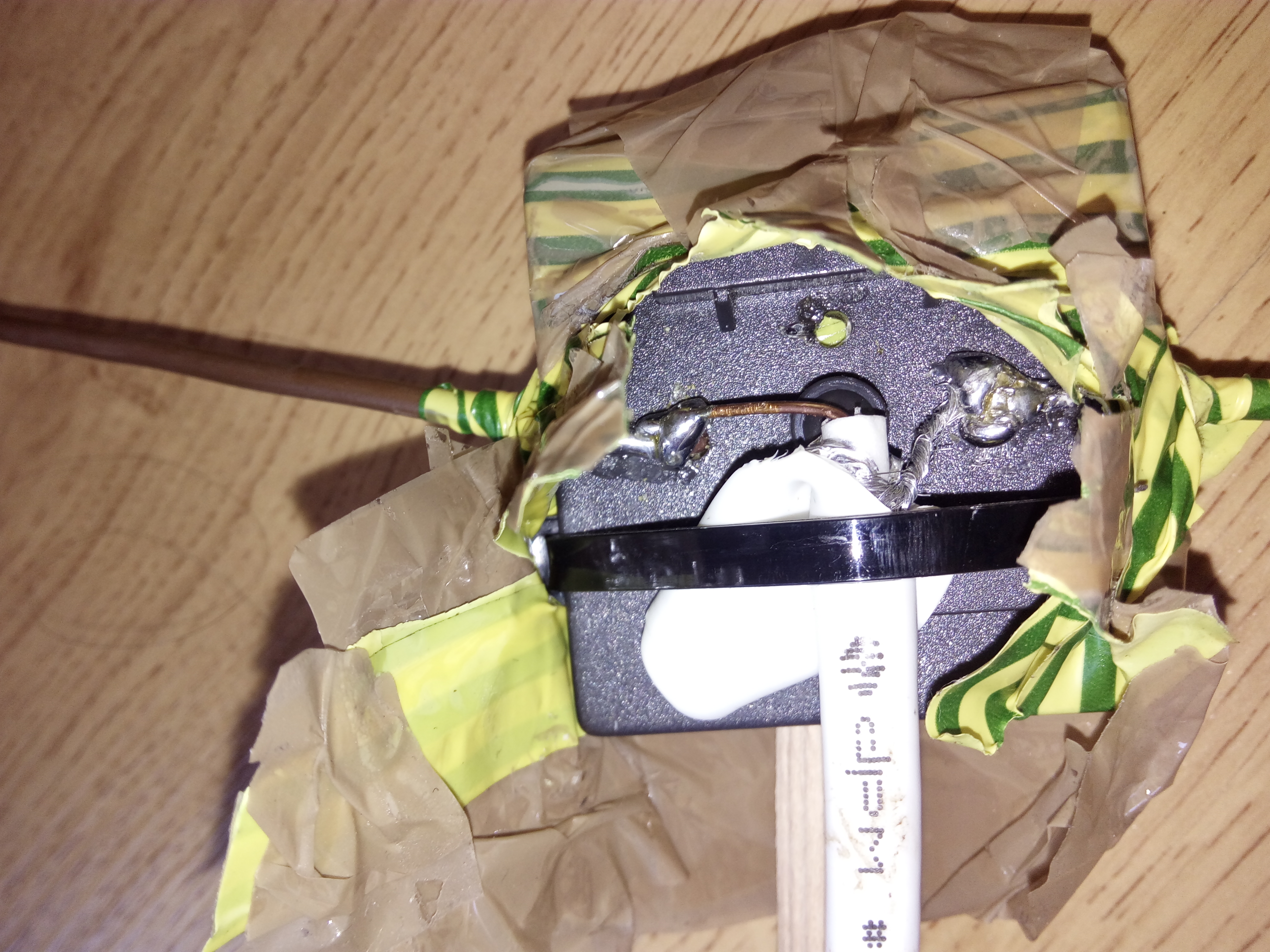

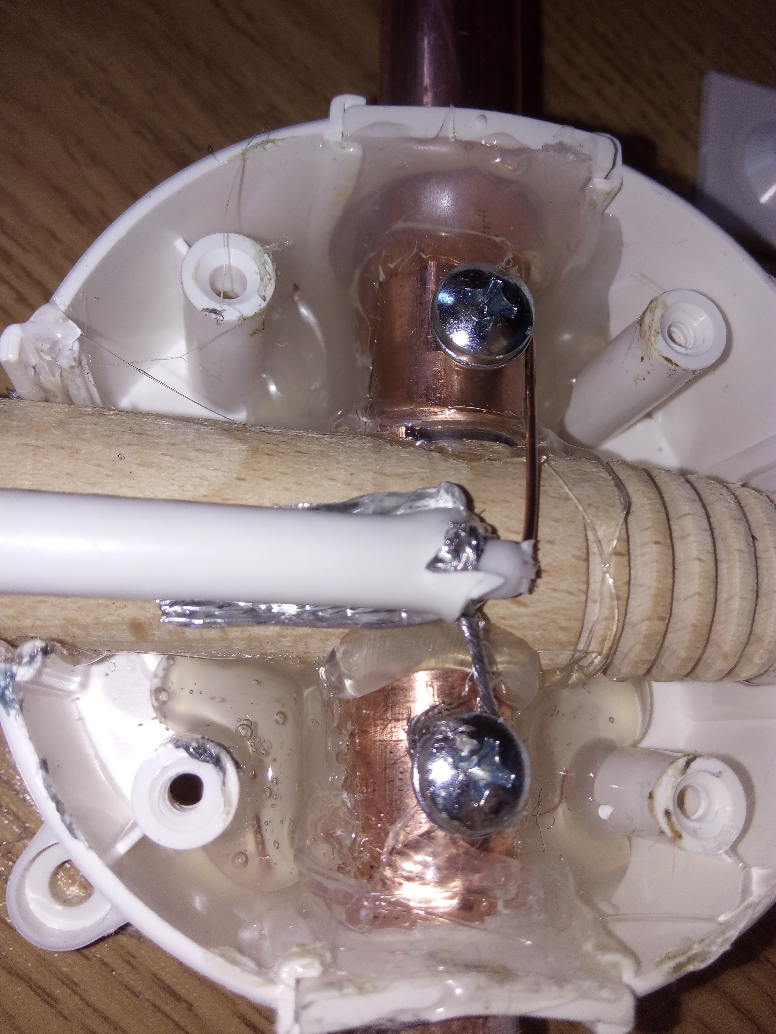

  • #768 15412041
    czakos
    Posts: 85

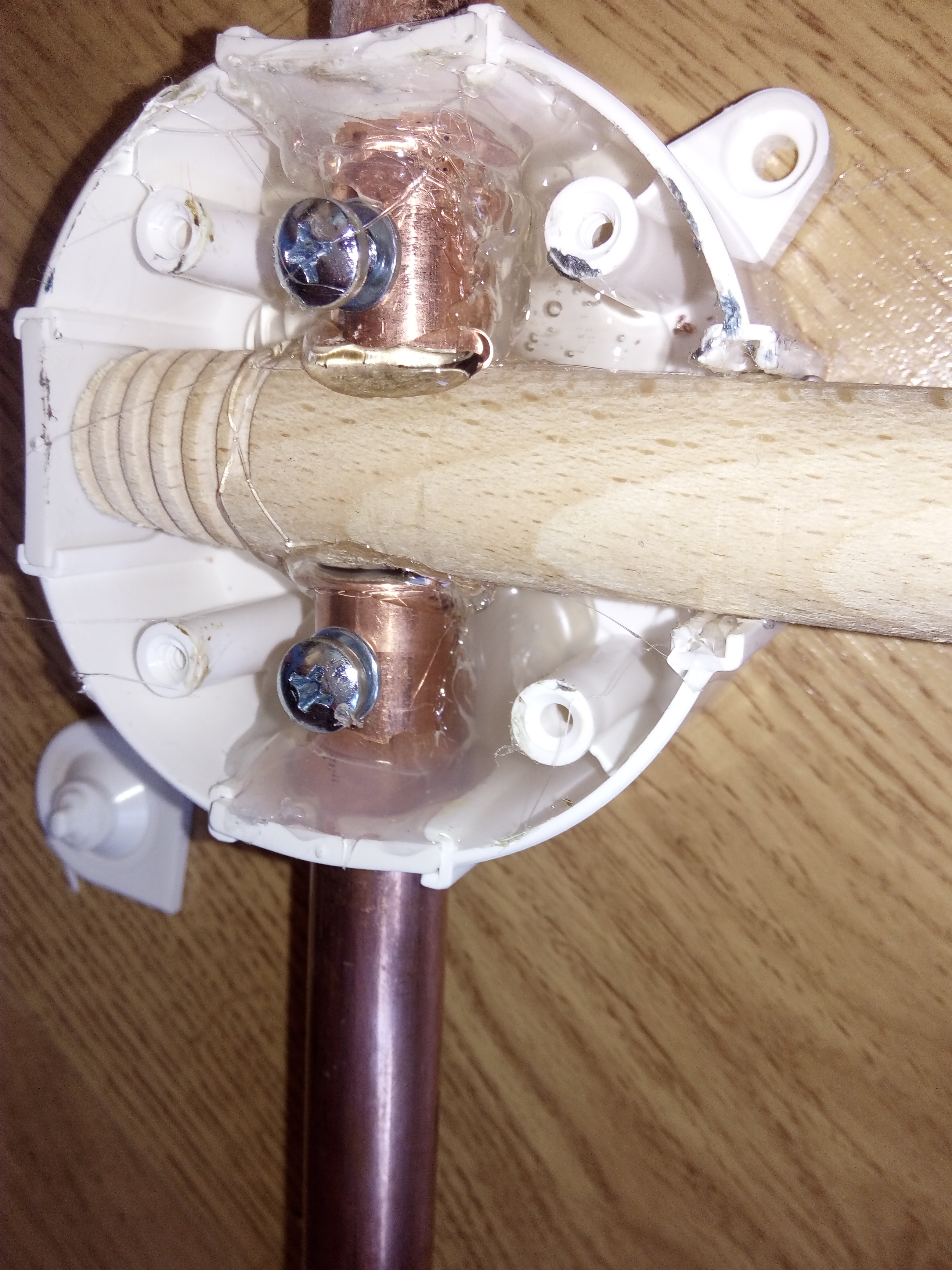

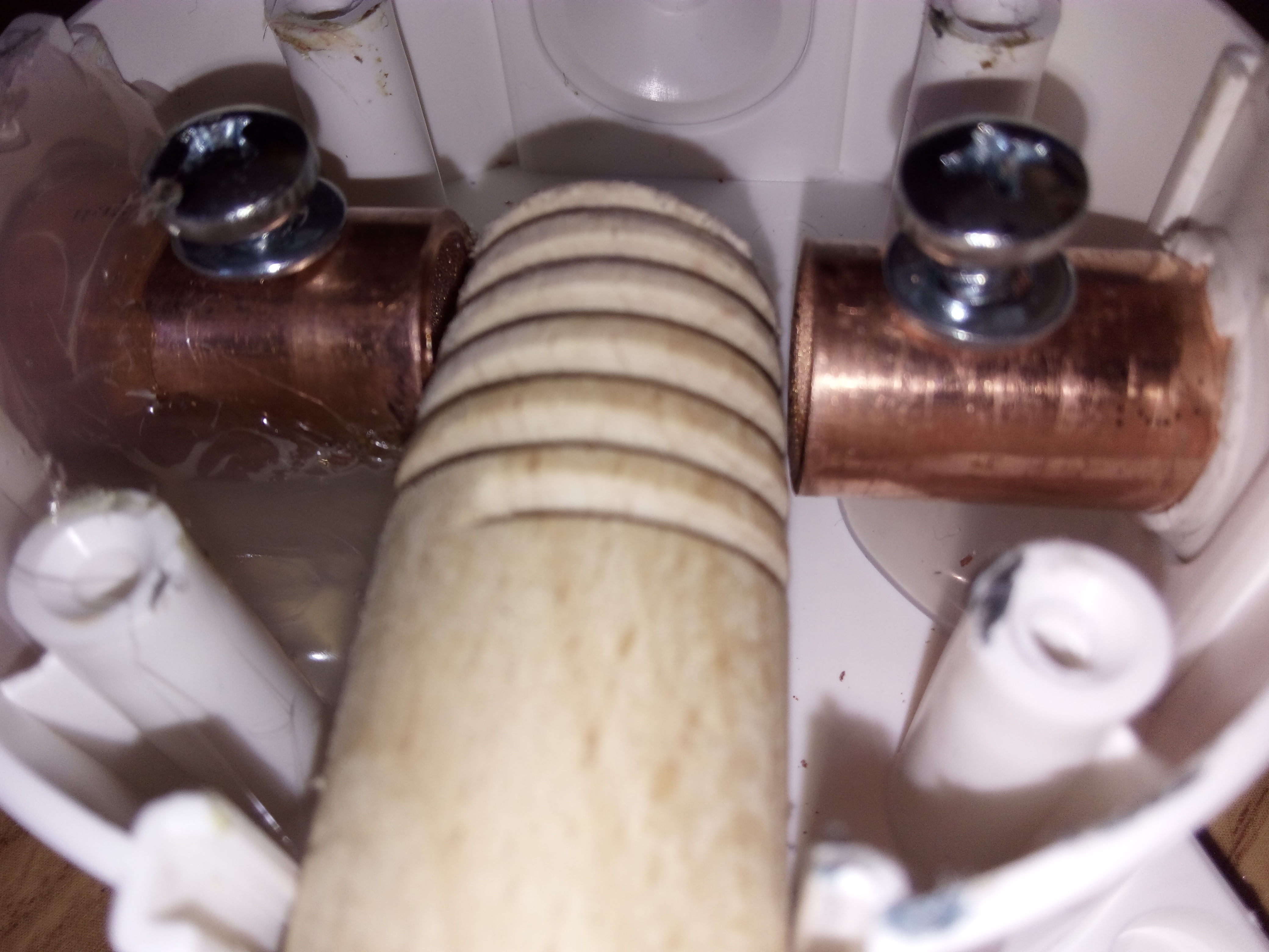

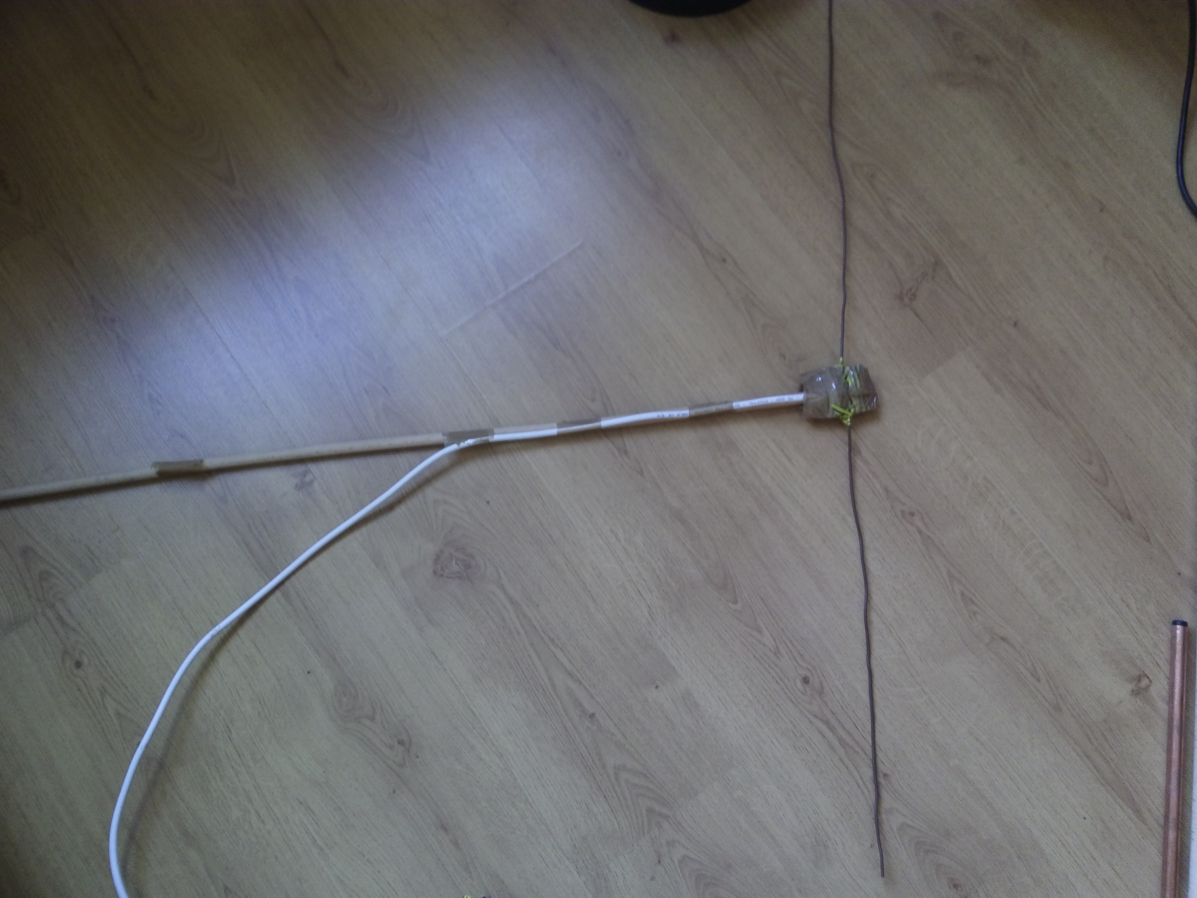

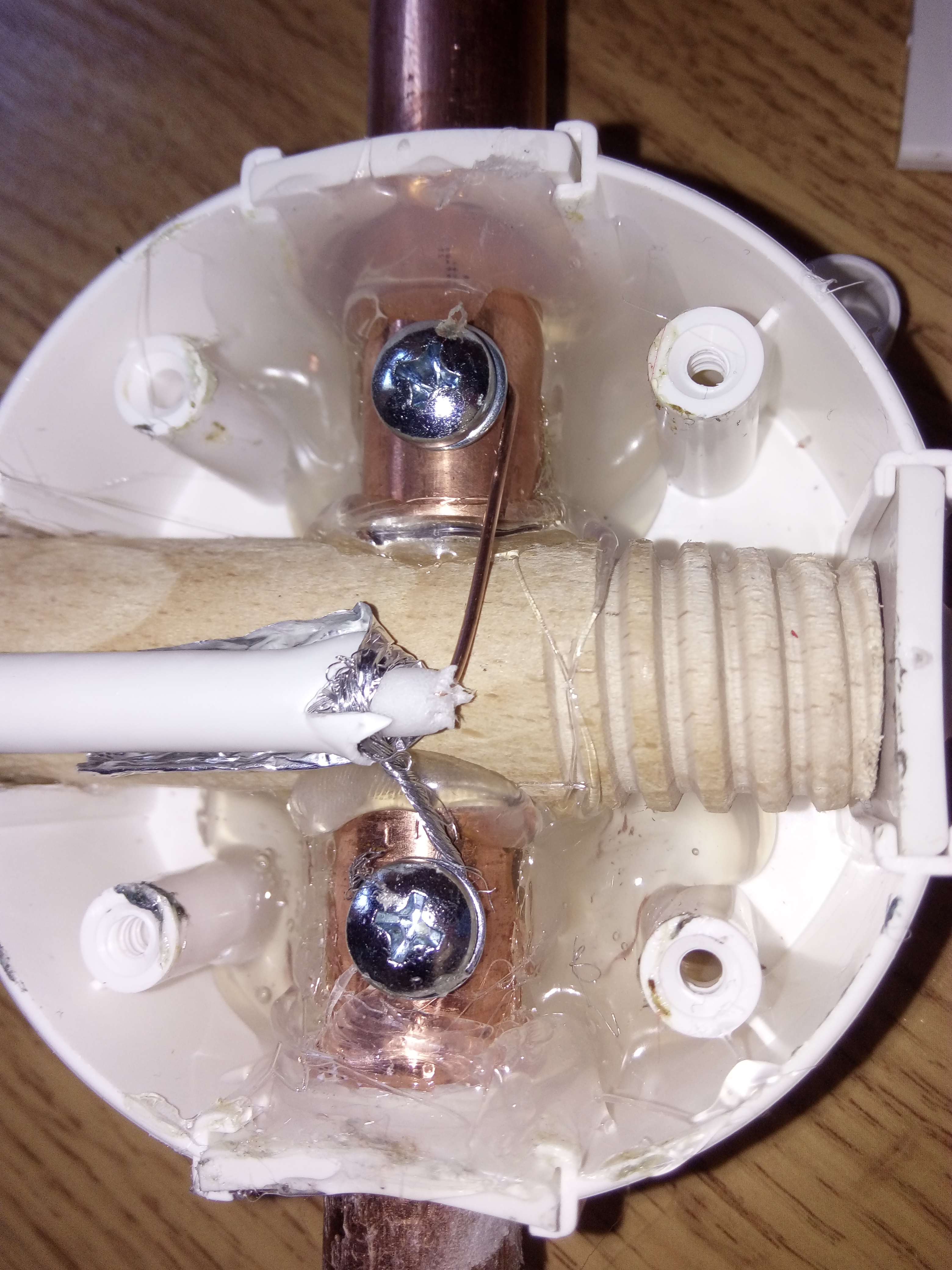

    Hello gentlemen, on Sunday morning I decided to go to work after yesterday's shopping, for comparison, I attach photos of the previous antenna made quickly :) And here, to my surprise, this 1 structure received much better reception, I mean it also receives a much weaker signal and maybe I have a higher gain on this one, I have 8.7 dB. From what my colleague Kamilo noticed that he has just behind the can, such as a coil made of a wire, maybe this is the reason? It seemed to me that thicker tubes had more copper surface to receive :)
    The last two photos, the 1st construction, the next one, is the 2nd construction, I will add that the tubes are 50 cm long and the 1st construction is 48 cm, which is typical for the strip. It is mounted exactly in the same place and yet the reception is worse and I suppose the distance is probably shorter, but after 15 minutes it's hard to say.
    I checked with a meter and the transition is from the tube on the plug and there is no short circuit.

    mkpl
    Level 37  
    Posts: 5678
    Help: 306
    Rate: 863
    Solder a 1k resistor or a 100uH coil between the tubes (better a coil). The antenna is open and must be shorted for DC to protect the tuner.
    The thickness of the tube determines the slenderness of the antenna, i.e. its bandwidth, but this parameter goes hand in hand with the shortening factor, which should be taken into account for the antenna to tune in the assumed band.

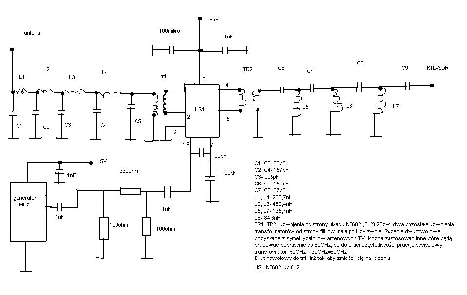

    I wanted to ask what core these transformers should be wound on? I have a T37-2 (red)
    I see. For the latter, I have all the parts. How to expand it to All right walked on short waves.
    • How to use RTL-SDR on a cheap USB DVB-T tuner for HF and 64–1700 MHz? 6205980200_1409824548.png (16.75 KB) You must be logged in to download this attachment.
    • How to use RTL-SDR on a cheap USB DVB-T tuner for HF and 64–1700 MHz? 7245994400_1401234345.jpg (59.03 KB) You must be logged in to download this attachment.
  • #773 15434065
    RAFPOL5
    Posts: 139
    Help: 23
    Rate: 41
    In the second diagram, cores from television baluns are written, the closest material is material no. 43 from Amidon.
  • #774 15434192
    You mean FT50-43 :?:

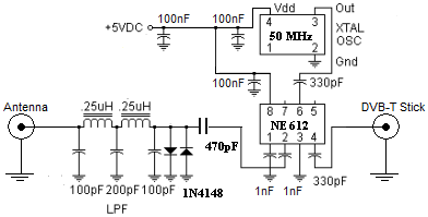

The discussion centers on using inexpensive DVB-T USB tuners, particularly those based on the RTL2832U chipset combined with various tuner modules like the R820T and E4000, as software-defined radio (SDR) receivers. These devices, originally intended for digital TV reception, can be repurposed for wideband SDR reception from approximately 25 MHz up to 1.7 GHz, covering amateur radio bands, FM broadcast, airband, ADS-B, and more. Modifications such as direct antenna connection to the RTL2832U chip pins enable reception of lower frequency bands (below 30 MHz), including shortwave, though precautions against electrostatic discharge and signal surges are necessary. Upconverter circuits based on chips like LA1186, LA1185, and TA7358AP are commonly used to extend reception down to HF and VLF bands by frequency shifting signals into the tuner's range. Various software solutions including SDR# (SDR Sharp), HDSDR, and dump1090 are recommended for Windows and Linux platforms, with driver installation often requiring tools like Zadig to replace default DVB-T drivers with RTL-SDR compatible ones. Users report challenges with driver installation, device recognition, and antenna selection, especially for frequencies outside the FM broadcast band. Amplifiers such as the FP6L and antennas like Discone or long wire are suggested to improve reception quality. Mobile and embedded platforms like Raspberry Pi and Android devices with USB OTG support are explored for portable SDR setups. The community shares detailed schematics, installation guides, and troubleshooting tips, emphasizing the cost-effectiveness and versatility of RTL-SDR dongles for radio experimentation and monitoring.
TL;DR: A US$13 RTL-SDR dongle with an R820T tuner covers 24-1762 MHz “Band 24-1762 MHz (no holes)” [Elektroda, zabex, post #12073526] and can be pushed to ≈100 kHz with a 50 MHz up-converter [Elektroda, sb8gapi, post #13074101]

What’s the simplest way to receive 0–30 MHz?
Add a 50 MHz HF up-converter using TA7358 or LA1185. It mixes HF to 50–80 MHz, cost under PLN 15 and sensitivity beats direct sampling [Elektroda, sb8gapi, #13074101; Elektroda, zabex, #12073526].
