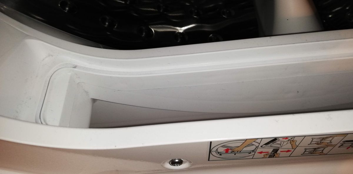

    A question for you. Sharp dryer KD-HHH7S8GW3-PL. I am a bit surprised that there is a groove in the housing where the lint filter is inserted, but there is no gasket in it.
    Bosch Condenser Tumble Dryer: Comparing WTW85460PL Heat Pump Model and Conventional Options
    As a result, the heat exchanger gets dirty faster and can only be cleaned from the front. Any of you know if a gasket from another manufacturer fits?
