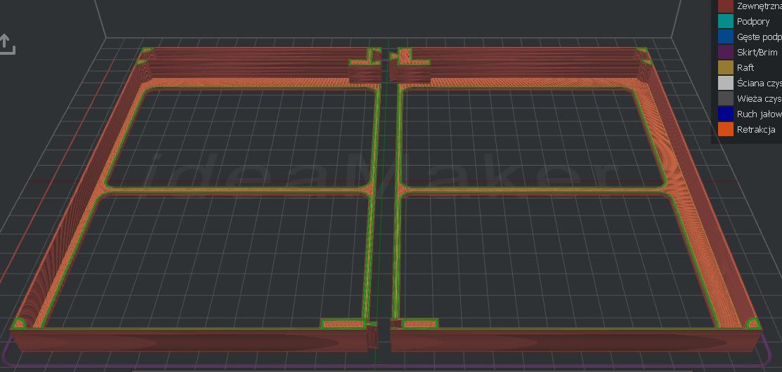

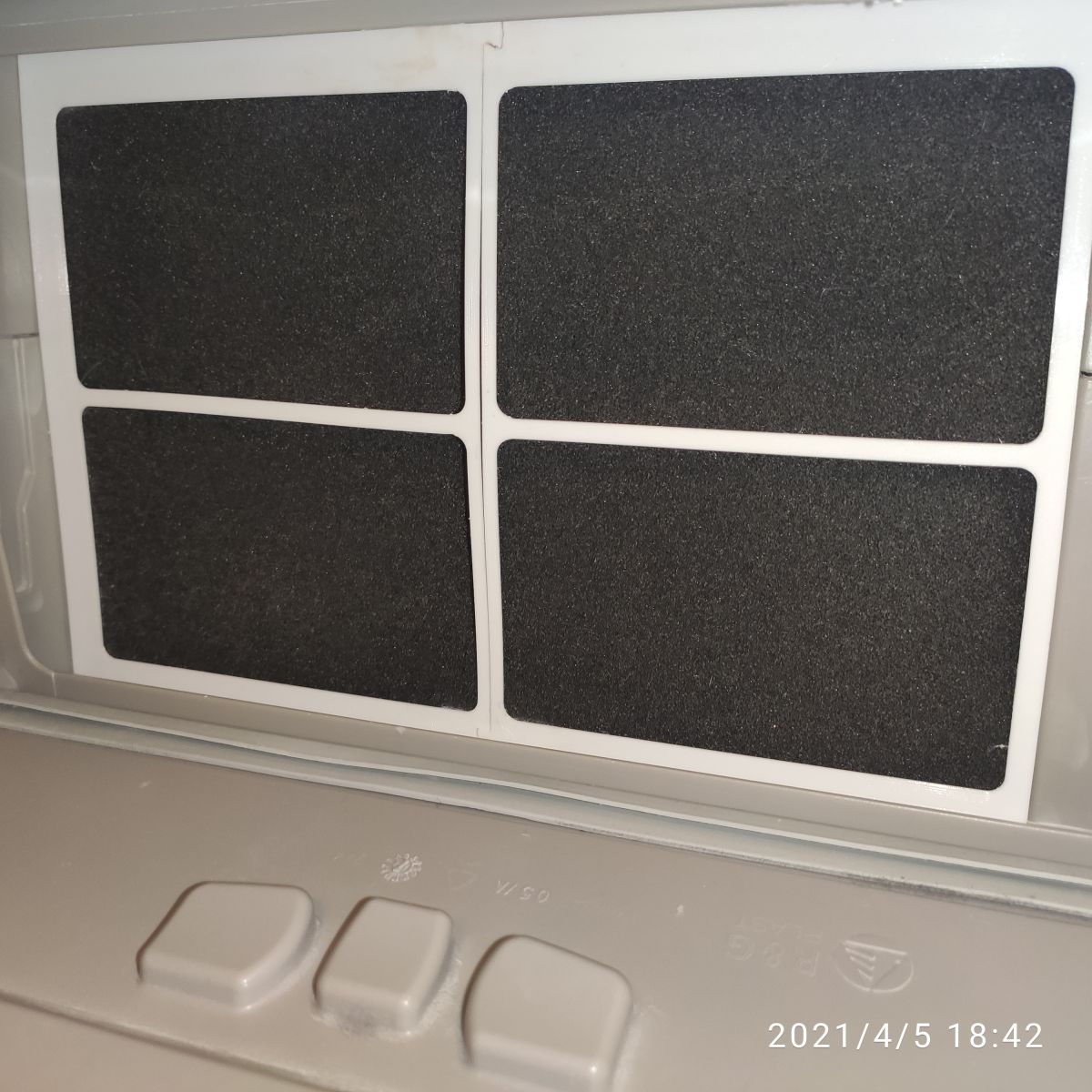

    I put in my EW8H458BP dryer a perfectly matching foam filter from Beko - No. 2964840200. Nothing needs to be cut.
    I made its mount on a 3D printer. It is a split frame made of PETG. For those willing, I will mix the necessary files.
    The frame fits snugly into the corners. We put each half of the frame separately and then connect it together in the middle with the hook.

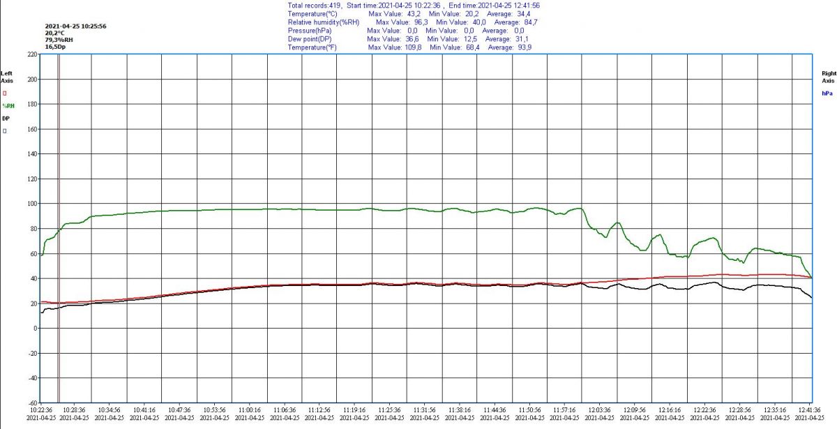

    Out of curiosity, I measured the temperature and humidity in the EW8H458BP dryer drum with about ~ 5 kg of load. Spun laundry set at 1200 rpm.
    Dryer set to program - Mixed XL.
    Bosch Condenser Tumble Dryer: Comparing WTW85460PL Heat Pump Model and Conventional Options
    Dryer set to program - Denim. Drying 5 towels

    Okay, but what conclusions?

    The discussion is about choosing a dryer - with or without a pump ...
    I took the measurements out of curiosity and perhaps for a certain group of people speaking here they provide some information ...
    For example, on the forum you wrote that some models dry up and others do not ... but where is the basis that someone says so? We're not discussing feelings, are we? However, I am not an expert, I do not service them, but if there are various arguments, it would be good to support them with some real measurements. For example, I gave Electrolux ... I have one, it's my first dryer.
    The data has been collected and I leave it for evaluation to someone who knows about it and can say something specific about these measurements.
    Maybe someone will be tempted to do something similar, e.g. in the BOSH brand or other type of dryer ...
