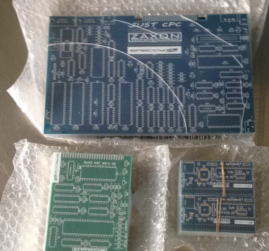

    The rev. 2.0 comes from the factory, another advantage of ordering PCBs in China, I ordered on February 28, I had a deadline on March 9, and they sent 6, immediately emailed, attached photos.
    Clone Amstrada CPC 464

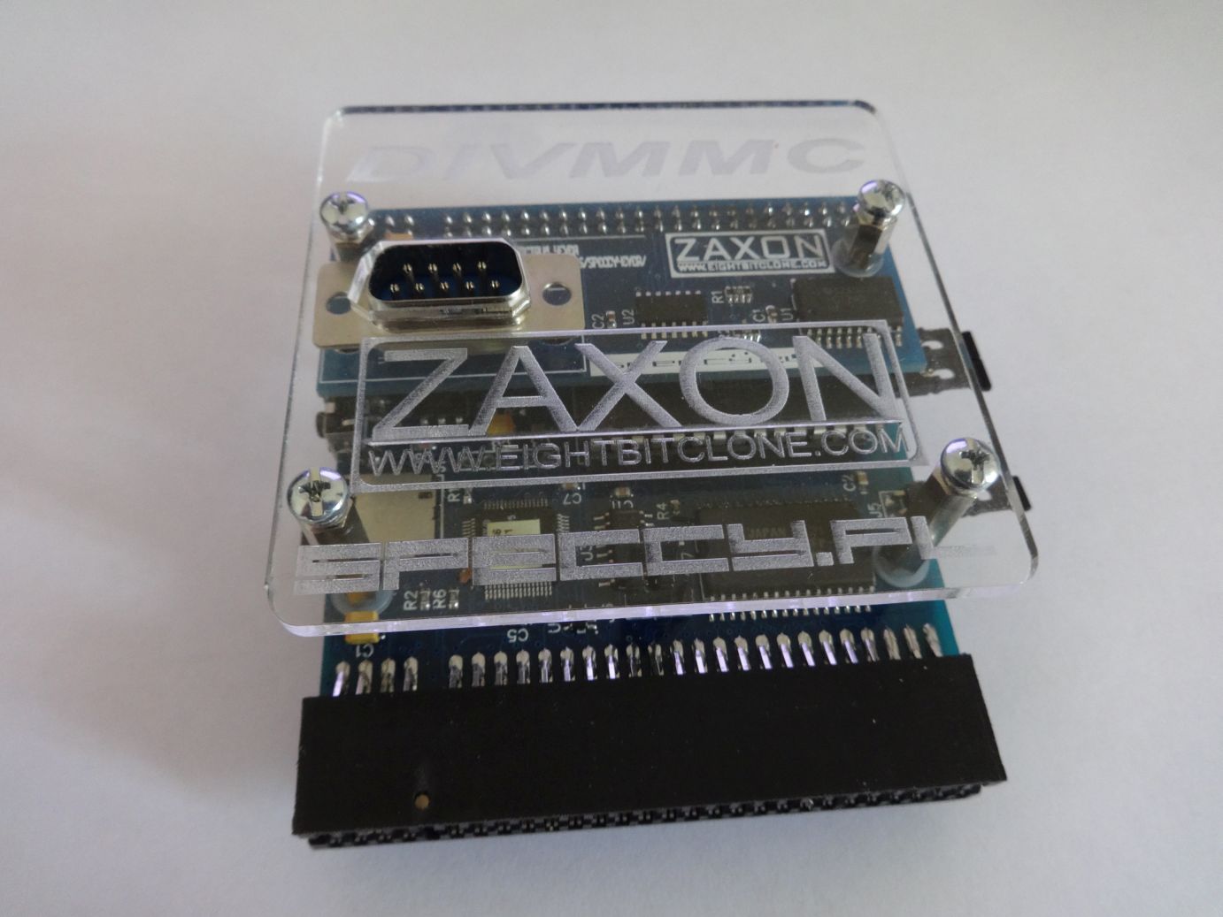

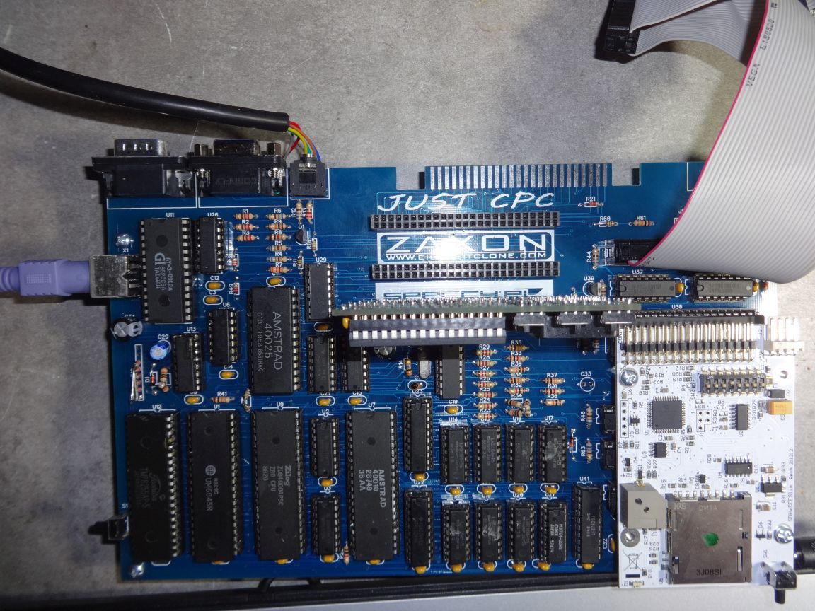

    zaxoniec
    Posts: 191
    Rate: 835
    The gray board is a disk drive emulator for SD cards, the board in the "edge" slot is a rombox and an additional 512 kb of RAM.

    zaxoniec
    Posts: 191
    Rate: 835
    And this is not my production, this is HXC floppy emulator. Easy to googgle ;)

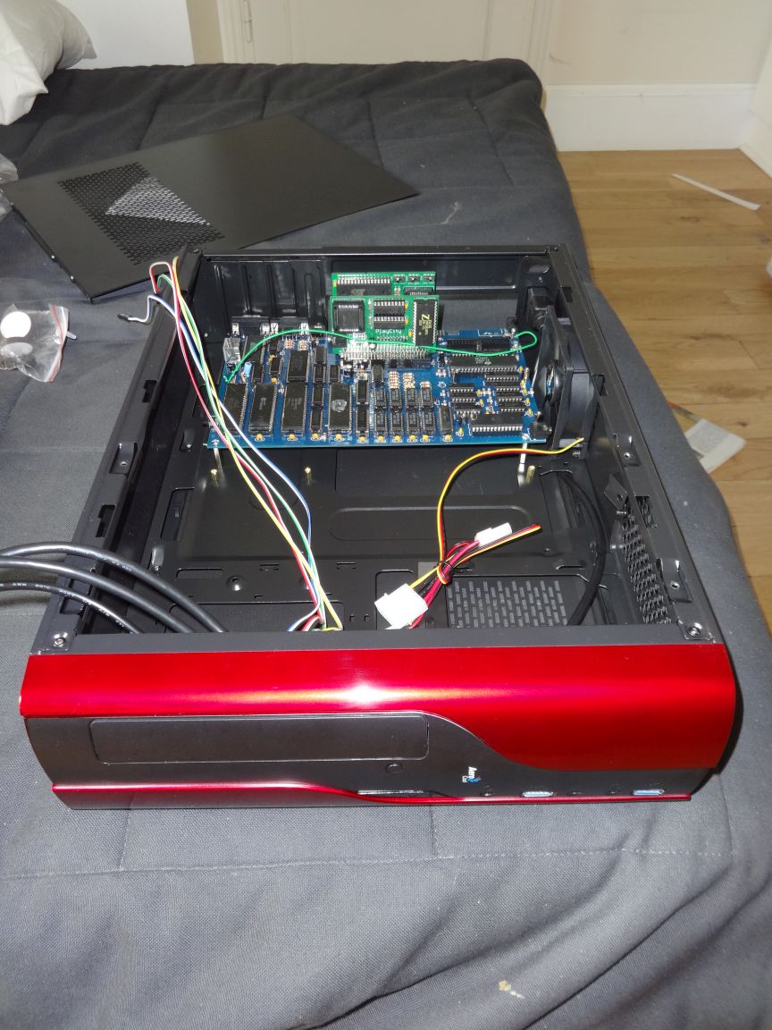

    zaxoniec
    Posts: 191
    Rate: 835
    A fully populated rev. 2.0 in action. Three expansion cards plugged into the board, - 512 kb and rombox extension of the frame,
    -hard disk interface on DOM (disk on module) 128 megabytes
    -Sound card 6 channels, 2x Yamaha YM294
    It all works on a 4Mhz Z80 processor.
    https://www.youtube.com/watch?v=Tfvgbh1UdY4&list=UUq0qTOm1ux2WOhEDPbe0Ofg
    And casing fittings:

    zaxoniec
    Posts: 191
    Rate: 835
    Pc Handyman, what are you talking about?
    Leonow32, you are right, the only advantage is the power supply, the board consumes almost 2 amps / 5V. Anyway, I feel sorry to close it in the housing. Maybe I will order 2 plexiglass plates with an engraving as for my other toy.
