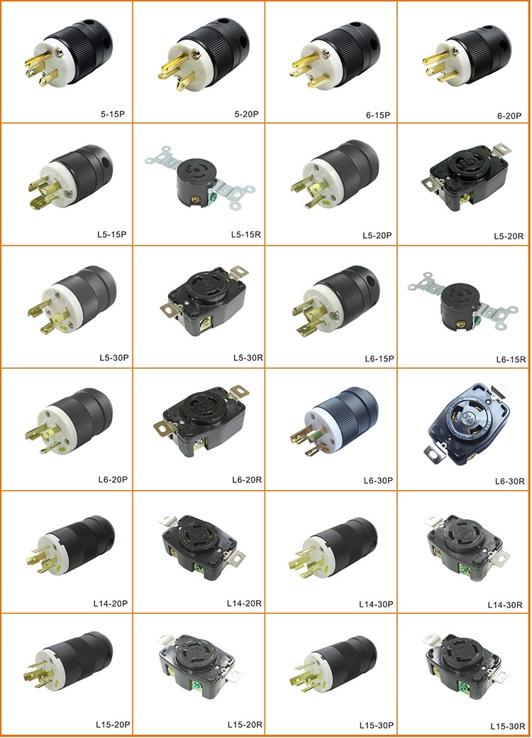

    rafbid wrote:
    janusz2k wrote:
    3-phase voltage is also available in the US
    With what tension?
    3x 460VAC as well as 3 x 220VAC are available.
    Except that 3x460VAC is provided by the energy supplier (or the owner of the building), and 3 x 220VAC, the company that needs the same voltage must take care of the proper installation.
    I would like to add that the voltage of 227VAC is also used in industrial lighting :)
    And personally, I am more irritated by the multitude of plugs / sockets used in the USA than the voltages themselves :(
    So there are more plug standards in the US?

    #42 15599687
    Polon_us
    Level 42  
    Posts: 6937
    Help: 1184
    Rate: 1282
    Below is just a part of what is available in the USA in industrial installations.
    The following (i.e. the table) are the so-called "straight blade" or straight plugs (pins?).
    Exactly the same values, ie voltages and currents, are also available in the "twist lock" sockets / plugs (photo below), ie a plug with a light twist lock. I don't know how to better explain it.
    And I would like to add that the following does not include plugs for 460 / 480V installations.
    But I didn't want to bore my colleagues with details.

Which plug and socket types should European visitors expect in the U.S.?
NEMA 1-15 (two flat blades, ungrounded) and NEMA 5-15 (two blades plus round earth pin) dominate. Travel adapters sold in Europe often mis-match grounding pins, so choose NEMA-rated models [Elektroda, Polon_us, post #15792834]
