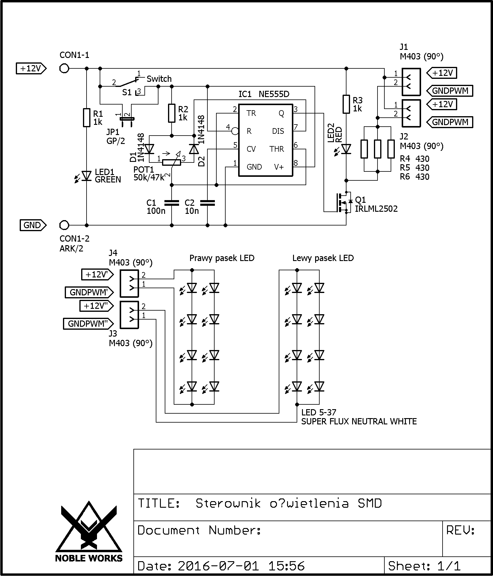

    I would like to share with you the design of the fog chamber and the experience that can be made through it.
    There are a few things here that are not related to electronics, but I hope you find it interesting. In case I throw here the functional block designs of the chamber: HV generator with multi-tap duplicator, PWM lighting controller and fan power regulator and water cooling used in the project.
    I also recorded a short film presenting the work of the chamber - you can see the radiation of the obtained samples and visualization of the tracks of elementary particles very nicely there.
    I encourage you to watch, comment and make your own experiments!

    ? Server power supply 12V and 69A with voltage regulation in the range of 12-13.5V
    ? Lighting system with PWM control

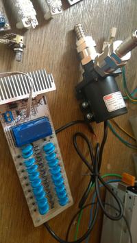

    ? Constant high voltage generator with multi-tap duplicator and electrodes
    1-20kV

    Calm on these peltiers is real -30C because I measured with a thermocouple, but you can do even more if you have good quality cells. http://www.cloudylabs.fr/wp/wp-content/uploads/2013/12/DIY-Wilson.pdf Here the designer received even -40 but he had other cells / paste / cooling. Initially, I tried with 3 layers of appropriate gradation in power but it did not come out very well and I received a miserable -20C, which is barely the limit of the appearance of pairs. For me, the water cooling block is 10mm copper and soldered tubes, so I thought I would get better results than it did on air cooling, but Chinese TECs are like that .... Unfortunately, I have 24 cells used / damaged in the workshop because tests / tests gluing was not easy.
    I will have to describe the control panel and try to do it soon.
    The high voltage generator has completely inflated values on the description of the board, because I was not able to predict everything. The assumptions were that the generator would ultimately give high voltage on + 3kV taps per degree, but as it turned out, the requirements and realities are completely different. Sufficient with 15kV, which provides traffic from the inverter. The whole is insulated with a 10mm layer of epoxy resin on each side of the plate.
    The high voltage electrode is placed at the bottom, due to tests during which it came out, that there are burns to lighting and once even the ignition of alcohol occurred ...
    If someone would like to do something similar on an average surface, it is worth choosing a compressor system, because it will be cheaper and probably less problems with it. There are various designs of chambers for one day, where it can be put together for quick observations, and the low temperature is provided by dry ice, which must be somehow obtained.
