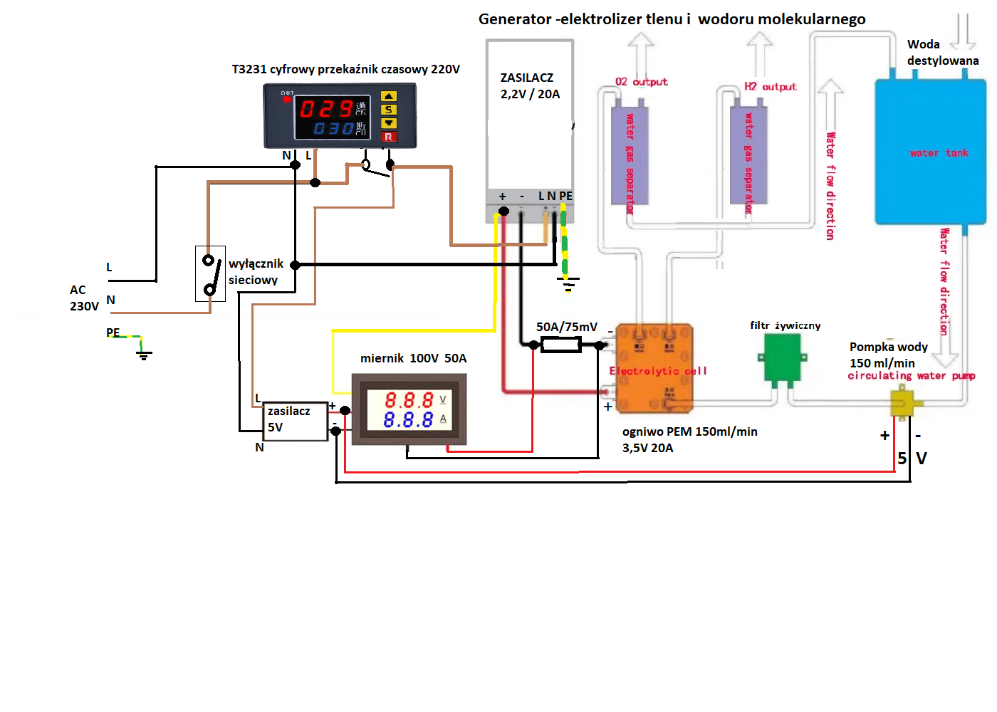

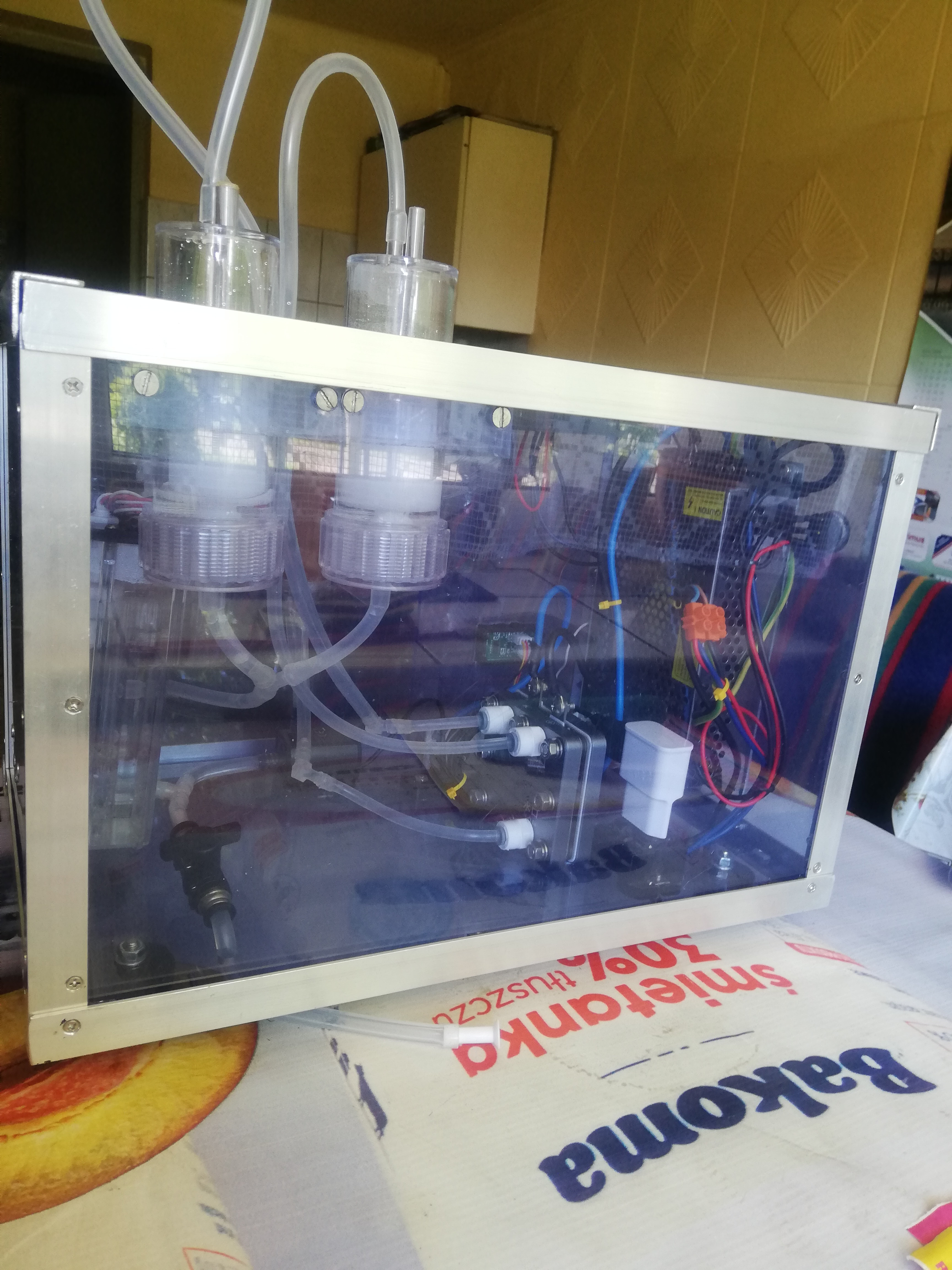

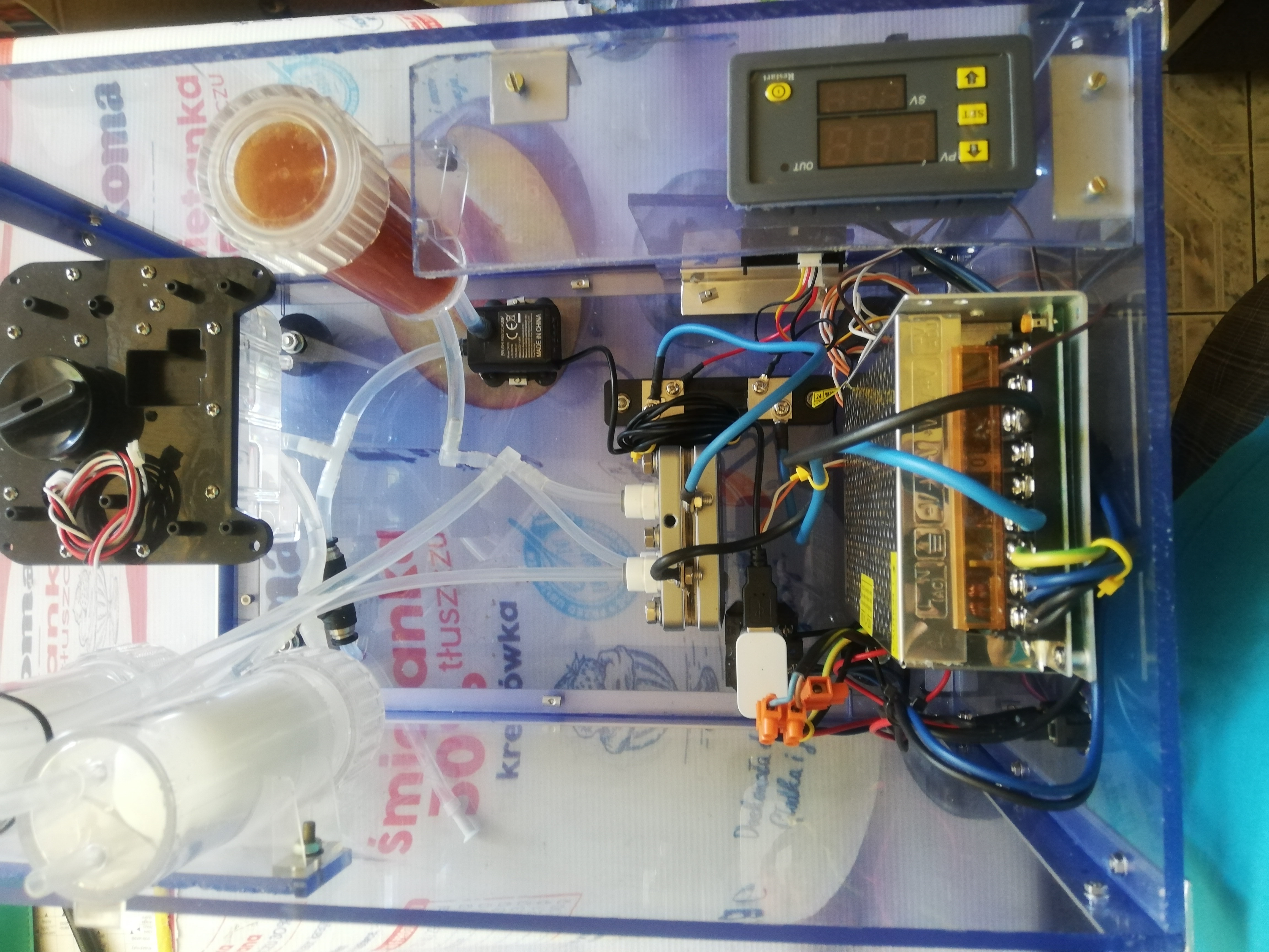

    It took me a long time to decide whether to publish this post, it also took me a little while to prepare it, so I don't know if I've drawn up everything exactly according to the "what you need" recipe. However, I decided to post it, maybe it will inspire someone or I will learn something new (hopefully not a wave of heckling: that e.g. - it doesn't work, what's the point of it, scammers, they're pulling a fast one, shamans came up with something again.... and etc.).
    Molecular hydrogen generator - such a novelty that has relatively recently appeared in the offer and medicine. I will not describe here the effects of molecular hydrogen on the human body. Those interested will find everything at Uncle Google and YT. Personally, I came across a description or a video somewhere on the internet, there I found out that such hydrogen is a boon, I started digging and decided to make my own such a generator for myself. You can buy ready-made ones, but the cost is over 4 thousand. Although I counted a little, because making it out of blocks was not cheap either, and you still had to spend a lot of time.
    Description:

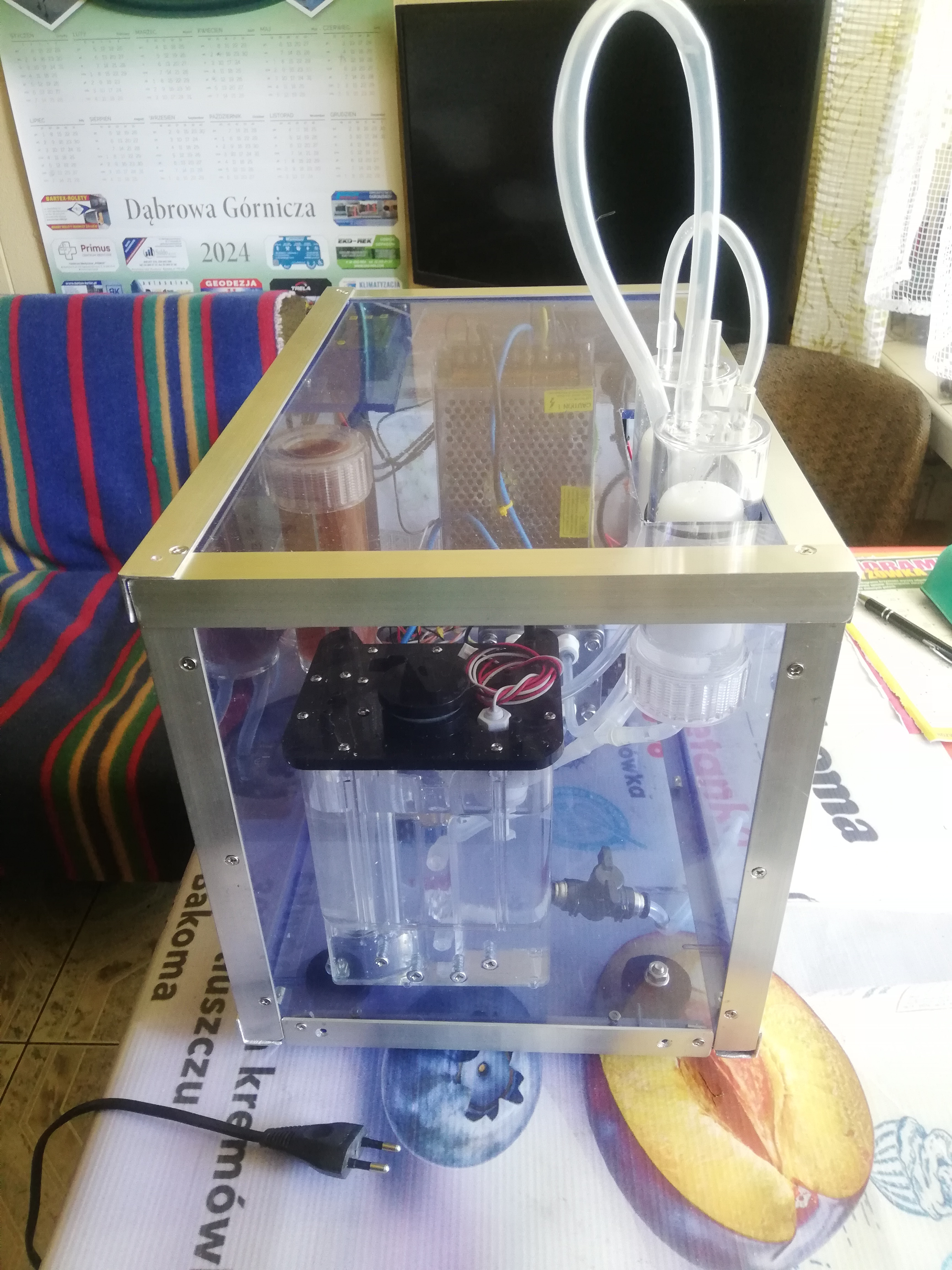

    Hydrogen generator capacity 150 ml/min. The PEM hydrogen cell produces pure molecular hydrogen for inhalation, which is separated from water in one of the gas separators. In time I realised that there are rods available for dissolving hydrogen in water, so I purchased such a rod, placed it in a jar, fed the hydrogen from the separator, which through the rod (diffuser) hydrogenates the mineral water for drinking in the jar, and at that time the other end from the jar lid is fed to the cannula, which is used for inhalation, and so I obtained 2in1 (inhalation + hydrogen water). It is recommended to pour distilled water (not demineralised water - just pure distilled water) into the diffuser jar. You can pour whatever water you like to drink into the diffuser jar. The second gas separator gives off pure oxygen, which can also be used for inhalation or mixed with hydrogen and inhaled; if not, it escapes into the atmosphere. You can skip this separator, saving a hundred and drop the tube with oxygen and water back into the decomposition water container directly (that's how those little factory generators have it). You can also skip the resin filter, saving another hundred. All in all, if you buy a container like I have, you can skip both separators, as there is already a separator in the container. You could use it for the hydrogen, and pipe the oxygen and water back into the decomposition water.
    Everything bought on AliExpress, after the fact I found auctions where you could buy everything together and it would come out cheaper (ie: hydrogen cell, filter, separator, dedicated power supply - no modifications, dedicated water pump).
    Costs:
    The whole thing cost me around PLN1300-1400, so on the borderline of cost-effective.
    - 150ml/20A hydrogen cell: 400 zł
    - Resin filter: 100 zł
    - Gas separator 2 pcs: PLN220 (PLN2x110). Although you could splurge on 1 piece, then oxygen straight into the water container
    - Power supply (you need 2.1V 20A): there is a special dedicated one for different cells, costs 300 zł - I converted a 3V 40A power supply for 100 zł, there was a bit of wrangling with the conversion: https://www.elektroda.pl/rtvforum/topic3890375.html#21191459. Not to mention that earlier I bought a second 5V/70A power supply also for 100 zł, with which I didn't work out, but in the end I managed to convert the 3V/40A one, so that it gave the needed current and voltage for this cell, i.e. 20A/2.1V. I would probably buy the dedicated one next time
    - Water pump with flow control: PLN35 (you can also buy a dedicated water pump, but the cost is approx.. PLN 100)
    - Meter with 50A, 100V shunt: PLN20 (need not be there)
    - Timer 230V AC: 20 zł (does not have to be)
    - 5V phone charger (to power the meter), 230V socket: PLN20 (does not need to be there)
    - Special water container: PLN140 (although here, too, could be made out of some plastic bottle and connectors). However, by using this container, you could omit both separators, saving 2 hundred pounds
    - Silicone hoses and plastic connectors, jar: about 60 zł (I bought more)
    - Cannula: 17 zł

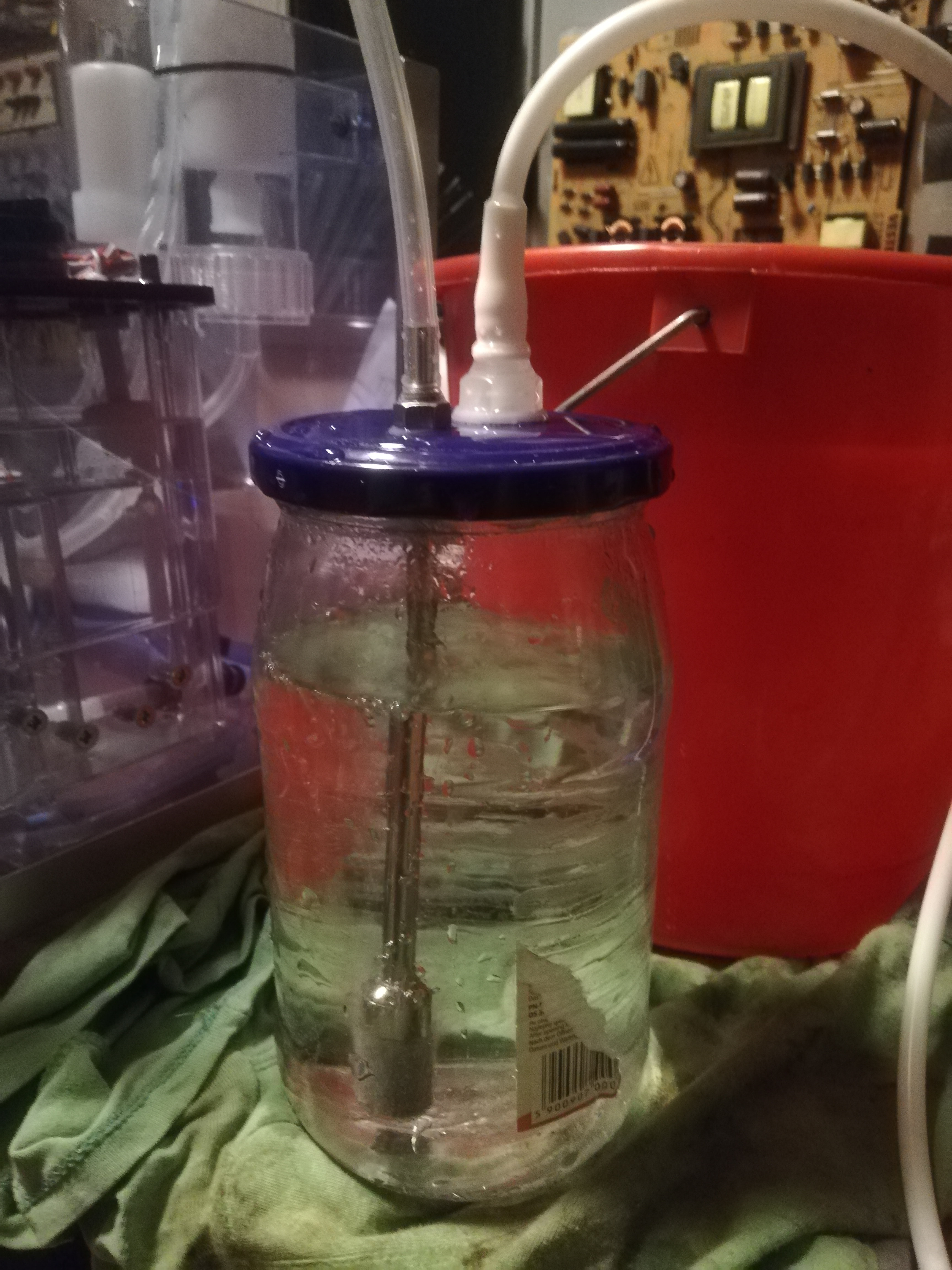

    - Stainless rod (diffuser) for dissolving hydrogen in water: PLN 130
    - I made the enclosure from plexiglass bought at scrap price and new angle brackets from Allegro - all about PLN120
    - 3mm screws with nuts: approx. 20 zł
    Previously for live (hydrogenated) and dead water I made myself a generator based on the principle of electrolysis, which separates both waters through a membrane. I will give some pictures, but I don't want to describe it :) . Similar designs have been described on the electrode as well. I just wonder if the better water is the live one from electrolysis or the one hydrated by the diffuser from the jar described above. Perhaps someone will comment wisely on this subject :) .

    Since there are submissions as to why the topic is on the main: here uploaded the author of the design and it is a DIY electronic design like any other, I have nothing to complain about structurally and will not censor the project, the design itself is correct. And what it generates, or what the author uses it for.... might as well generate air for the fish. If the author is helped by the placebo, let him use it. If audiophiles want cable holders for 1000PLN, let them buy them and use them. I deleted from the topic "for inhalation" so as not to suggest such a specific use of the design. There will be no forum censorship or censoring of opinions.

    Thanks for the honourable mention :) and for the corrections. I was not able to arrange it nicely and put the text with pictures , because for example the first 3 pictures are related to my earlier electrolyzer of living and dead water ( it would be good to separate it somehow so that it would be visible that they are separate projects )
    Does this therapy help and does it work? Hmm .... I don't know, but I personally believe it does. I've only been using it, about 3 weeks at 30 mins a day if I have the time. I seem to feel better after inhalation but maybe this is just a suggestion . Just because the therapy is not completely proven to work does not mean that it does not work. I know that an hour of inhalation costs approx. 60 zł. Let everyone decide for themselves whether something like this can help or not. Of course, it would be advisable to do a little reading and research before criticising anything. I am in no way recommending or advertising anything. I am also not responsible for possible side effects or any other damage that might occur (should someone want to build a similar project) . The risks can be many: from electrocution to a hydrogen explosion, so I urge caution.
    As far as dosage is concerned, as far as I know, you can't overdose on hydrogen from such a machine. 150ml/min when inhaled, mixed with air, is rather safe, the excess is excreted in the form of water. Of course you have to be careful with fire, because as you know hydrogen and fire.... BOOOM!!!! And then it will certainly harm :) .
    scientific research on molecular hydrogen can be found here : https://molecularhydrogeninstitute.org
    and here is a sample article from here translated in the translator https://molecularhydrogeninstitute-org.transl..._tr_tl=en&_x_tr_hl=en&_x_tr_hist=true

    I understand that the device works on the principle of electrolysis.
    But, from what I understand we have hydrogen and oxygen in two separate containers?
    What about water with added hydrogen?
    Regards Hubert

    I would remove the phrase "for inhalation" from the topic name and treat the whole device simply as an H2 and O2 generator.

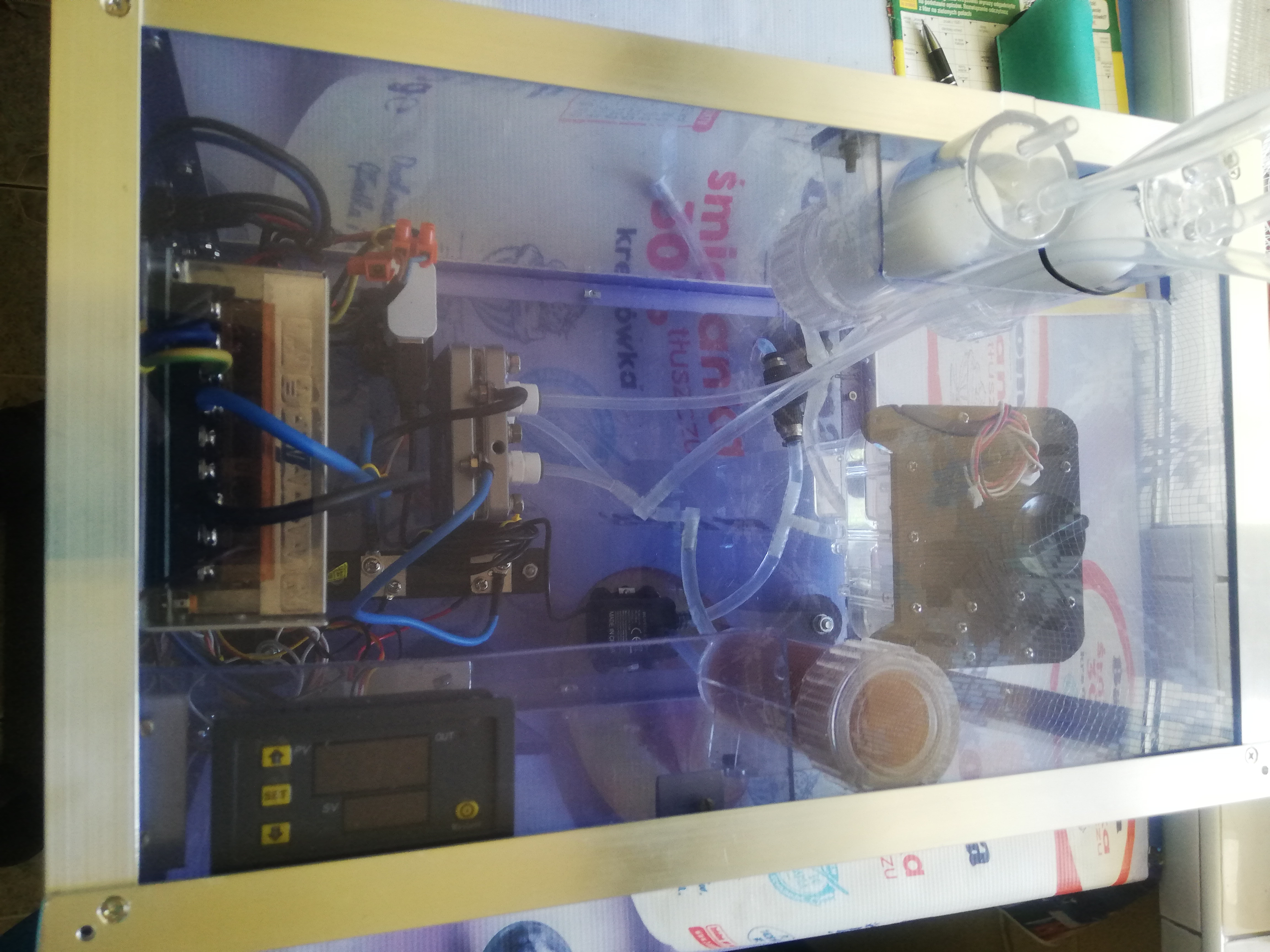

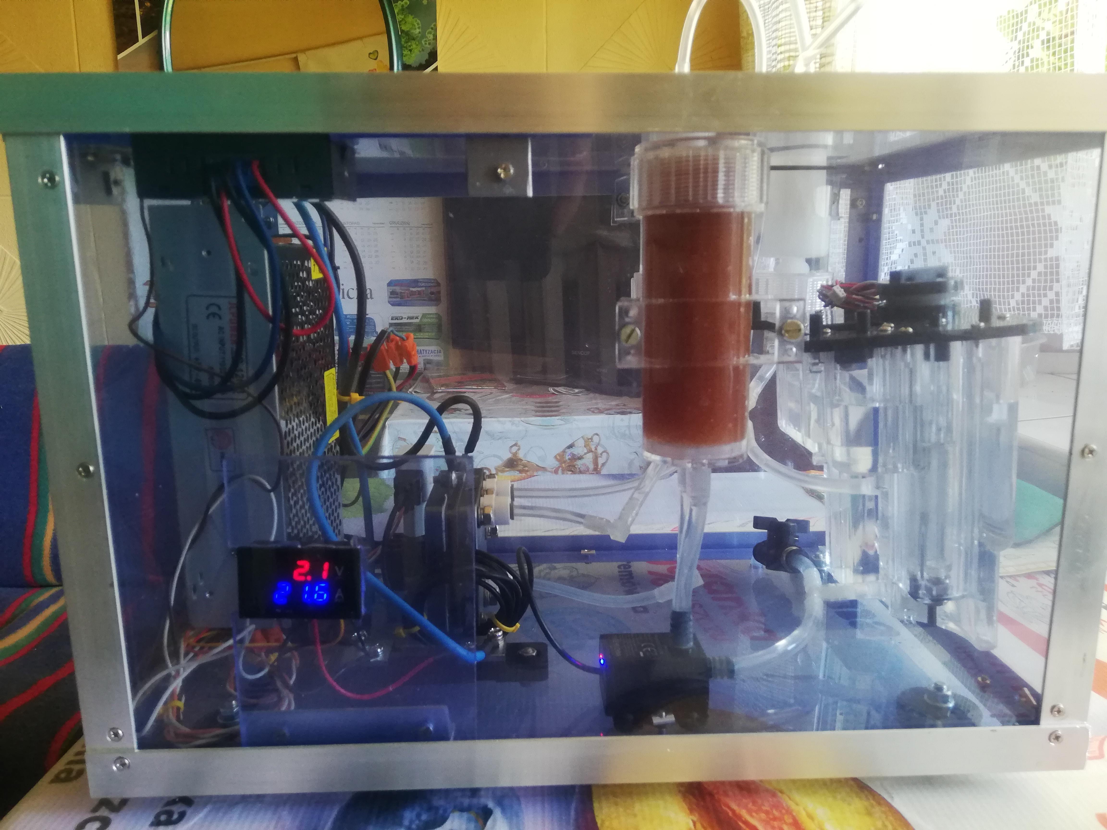

    I would pay attention to technical details, safety, quality of assembly (especially connections).
    Why does it look poor, to say the least, despite spending such a sum?
    If it works, it's still half a poor thing. I have had some nice projects behind me which, despite looking nice, did not work :) .

    Any playing with hydrogen is dangerous and should not be done indoors.
    For this reason, e.g. acid batteries should be charged outside because of the danger of explosion (from sparks), fire, etc.
    All the more so in the case of an amateur inhalation device. It does not take much to extract hydrogen and oxygen from water, but they require responsible behaviour.
