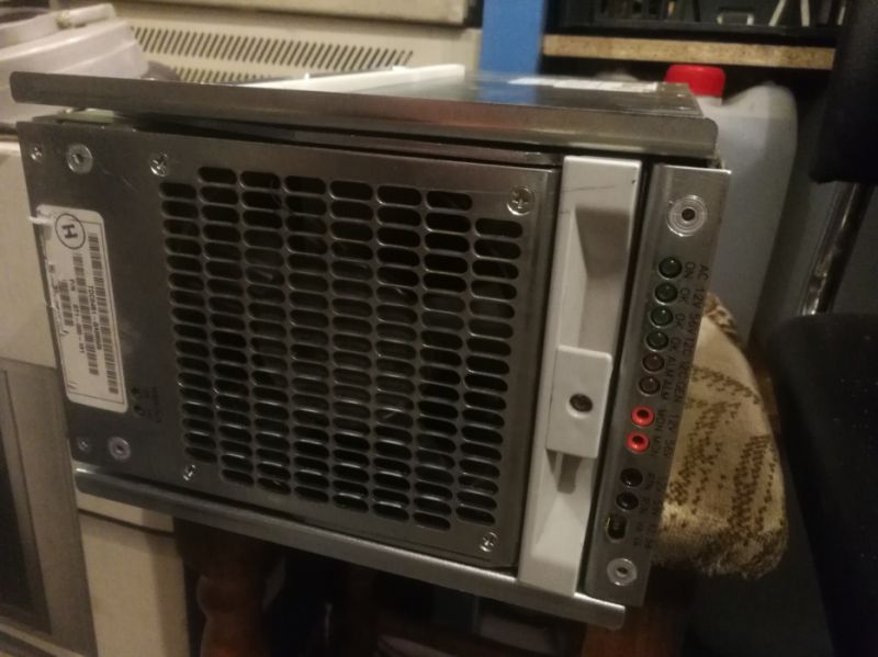

    [Modification] We are taming the DELTA DPS-600QB 40A / 12V, 600W, pinout server [Modification] We are taming the DELTA DPS-600QB 40A / 12V, 600W, pinout server [Modification] We are taming the DELTA DPS-600QB 40A / 12V, 600W, pinout server

    Thanks for the answer, I can see that it is really a monster, not only it has 175A at 12V, it also has 57V and 10A on this bus and also has a UPS / charger? I admit I did not imagine something like that in my collection, but maybe I will get it somehow ;-) I would like to use it as a 12V power supply, but I'm also interested in the 57V ones, e.g. for anodizing aluminum. But for now, only the 12V ones satisfy me.
    Only tomorrow I will be able to look inside, meanwhile I am sending photos of mine to be sure about the output socket. [Modification] We are taming the DELTA DPS-600QB 40A / 12V, 600W, pinout server [Modification] We are taming the DELTA DPS-600QB 40A / 12V, 600W, pinout server [Modification] We are taming the DELTA DPS-600QB 40A / 12V, 600W, pinout server
    But I gave the bodies, this one of mine is Chinese, and the one from my friend is the USA.
    Sorry for the mistake.
  • #58 17553465
    Vinncent
    Posts: 94
    Rate: 17
    Hello, I brought this 2nd power supply from a friend of the USA version, he gives photos: [Modification] We are taming the DELTA DPS-600QB 40A / 12V, 600W, pinout server [Modification] We are taming the DELTA DPS-600QB 40A / 12V, 600W, pinout server [Modification] We are taming the DELTA DPS-600QB 40A / 12V, 600W, pinout server [Modification] We are taming the DELTA DPS-600QB 40A / 12V, 600W, pinout server
    I wanted to run the 12V board first and throw out unnecessary components / plates.
    I have a question because I do not know how it is configured yet, as much as I opened it, whether it is possible to detach individual discs in full, it is known that it is not like that.
    I'm scared of the control (too many pins), you said that you can break a lot and the power supply starts right away, I'm a bit afraid of it and hence these questions. Maybe some tips.
    best regards
    PS
    Something these photos are hard to read, like what it will send again.
