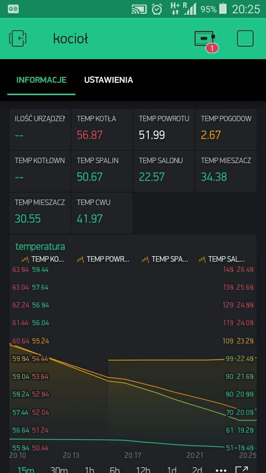

  • #185 18435837
    webster21
    Posts: 17
    So this is:
    According to the analyzer for the metalfach boiler, I was able to find the following values:
    Code: Python
    details in the attachment. Ultimately, I would like to search for all service codes for this furnace :) that is, sending a signal. I wonder if this is possible.
    and this is what it looks like from the phone:
    Internet module ecoNet 300 and ecoLINK2
    • ecomax860p.zip (1.76 KB) You must be logged in to download this attachment.

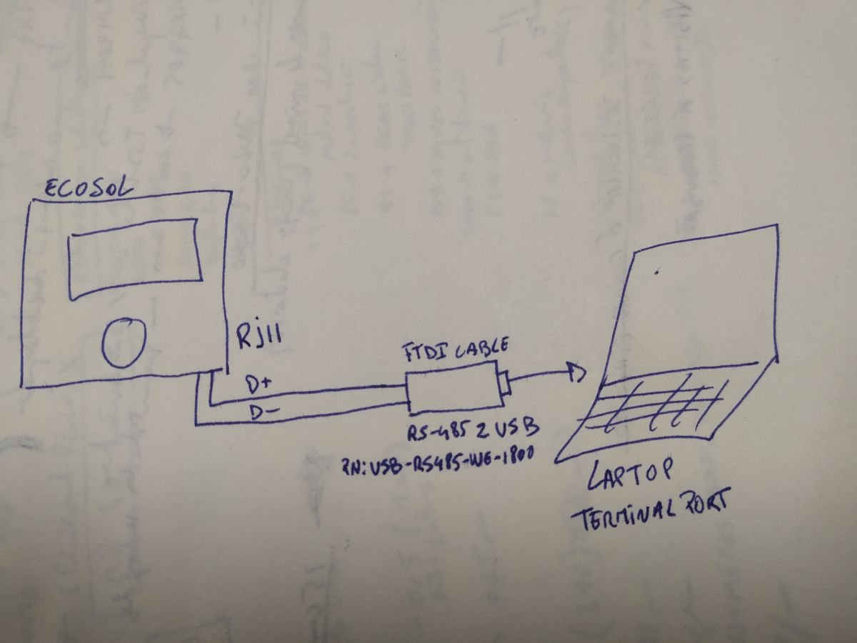

    Rui_Silva
    Hi everyone,
    this will be my first forum post here so i hope i am not typing in the wrong place and i hope the google translation tool will be able to translate from portuguese to polish.
    In my house, I installed a PLUM ecoSOL 301 solar controller with an RJ11 connection port and the manual says it allows you to collect data for the EcoNet300 router with an EcoLink2 connection cable, but I have neither an Econet300 cable nor an EcoLink2 cable.
    I would like to collect the variables of the controlled when the temperature enters the PLC through the RS-485 port. However, it is not a protocol supported by ecoSol301. Experience shows that it is enough to connect the cable with the RS-485 converter and collect the data, or is it necessary to send a command for the ecoSol301 to respond?
    I have connected a converter and a terminal to check if information is being sent with different baud rate settings but so far I have not received anything. I even changed the D- and D + lines to see if they were changed but no luck.
    Someone on the forum who has already collected information from ecoSol 301?
    Thank you very much in advance
    Rui
  • #199 18721228
    Rui_Silva
    Today I did a test, connected FTDI to RS-485 converter to computer and tried to grab something via serial port.
    The only thing that happens is when I plug in the controller I get the file string below but then I get nothing else. I waited about 30 minutes to see if more strings of data would come out of the serial port, but nothing happened.
    the data received were as follows:
    Terminal log file
    Date: May 27, 2020 - 7:33:08 am
    68 0A 00 FF ED C7 82 E0 D5 16
    Have an idea how to collect controller temperatures?
    Thank you
    • 115200.txt (127 Bytes) You must be logged in to download this attachment.
  • #200 18726871
    domadm
    Posts: 34
    Rate: 9
    For me, the boiler is suitable all the time, so if you have good equipment, it should be like that.
    Try some RS485 module on USB to be sure.
  • #201 18731870
    Rui_Silva
    Good morning and thank you for helping Domadm.
    I have ecoSol connected to the FTDI USB-RS-485-WE-1800-WE cable. I am using a baud rate of 115200.
    I made a drawing showing how to connect the connected equipment
    After connecting the power supply to ecoSol, the following message appears on the computer: "68 0A 00 FF ED C7 82 E0 D5 16", but ecoSol never sends a message again.
    Will I have to send a message from the computer terminal for ecoSol to reply and send a message with more data?
    From what I read on the forum here was that the ecoSOL hardware always sends internal data over the RS-485 bus, am I making a mistake?
    I wish I could collect the data present in ecoSol but it is getting difficult :(
    Once again, I appreciate all the help and information provided in this forum :)
  • #202 18732059
    SławekSS
    Posts: 726
    Help: 34
    Rate: 80
    It sends ecomax all the time because there are at least two modules and you are intercepting the transmission between them.
    EcoSol is one module and to catch the transmission you need to connect a second module, eg Econet300.
    Otherwise, you must send your queries from the terminal. What you catch is asking the driver if there is something connected to the line (or reporting presence and waiting for request).
