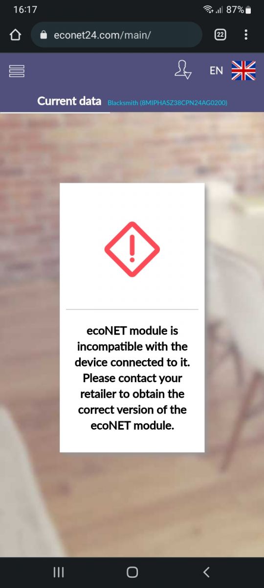

    I have uploaded the soft from post #96, Kostrzewa stove, I set up an account on 4pellet because it's like a portal for Kostrzewa stoves, but I logged in to econet24 with the same data, so it's probably just a redirection and they use the same server.
    On econet24 and 4pellet it showed that the device was blocked and nothing could be done except to change the account details, the phone application worked with basic settings, the preview was important to me and that was enough for me. About 3 or 4 days everything fell, the application closes itself and the website searches for devices and nothing else. As I wrote earlier, after disconnecting econet from the Internet, my driver is displayed on the website in the list of devices, but because it is disconnected, nothing can be done.
    Perhaps they started blocking self-made, I will add that mine appeared as blocked, maybe this is the reason for the block?
    Does anyone have a soft for the 4pellet server, maybe I could try if it would change anything.
    and so it had to be left. After a few days, weeks, months (like mine) it was unlocked.

    tusiek5
    Posts: 13
    SławekSS wrote:
    I didn't change anything, that's how it worked for about 2 months, I was hoping that in some time they would unlock it like you did, and now it stopped working overnight, apparently they changed something on the server.

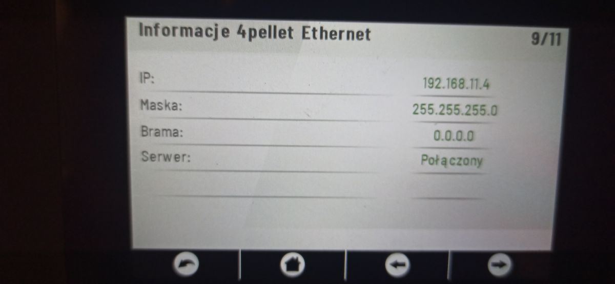

  • #428 20331999

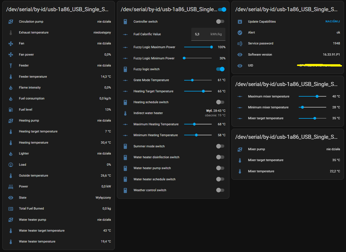

    gigipawel1
    jerguitariste wrote:
    Currently the only solution to make this work is not to use a TPlink mr3020 router but a raspberry pi with home assistant.
    https://github.com/denpamusic/homeassistant-plum-ecomax using RS485 or TCP serial gateway, just installed it on ecoMAX810p and it works fine.
    Internet module ecoNet 300 and ecoLINK2
    What port (G1 or G2) did you use to connect?
    did you use RS485 -> USB or RS -> Ethernet converter?

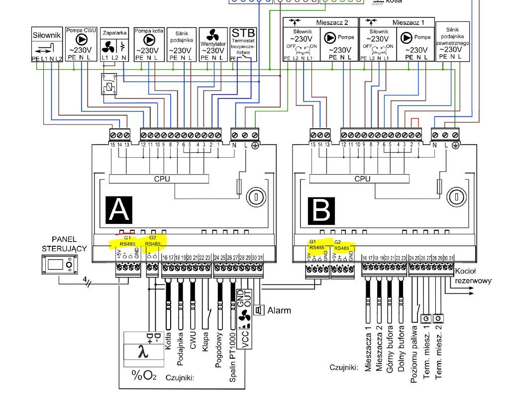

  • #435 20337254
    gigipawel1
    I used a Raspberry Pi 3 connected directly to the USB -> RS485 gateway
    Which RS485 port are you using? What communication parameters have you set?
    • Internet module ecoNet 300 and ecoLINK2 schemat_Plum.JPG (152.74 KB) You must be logged in to download this attachment.
  • #436 20337258
    SławekSS
    Posts: 726
    Help: 34
    Rate: 80
    Moduł A, port G1

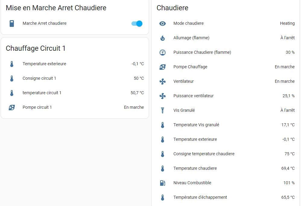

    krebou
    With my ecomax920 with PyPlumIO fescue software it works great, I haven't tested it with this HA but it should be ok.
    PyPlumIO is a great library, it pretends to be an econet to extract data. In addition to extracting data from the frame, which ecomax throws out by default, it asks ecomax about data and receives them ... I wonder if the guest figured out econet enough or had the opportunity to work at it that he knows how and what to ask ecomax ...
    Btw. In the PyPlumIO documentation there is also a thank you to a colleague here from the topic
    For people with ecoNet or 4pellets with access to change data. Are you able to change the work from constant to automatic (boiler) from their level?

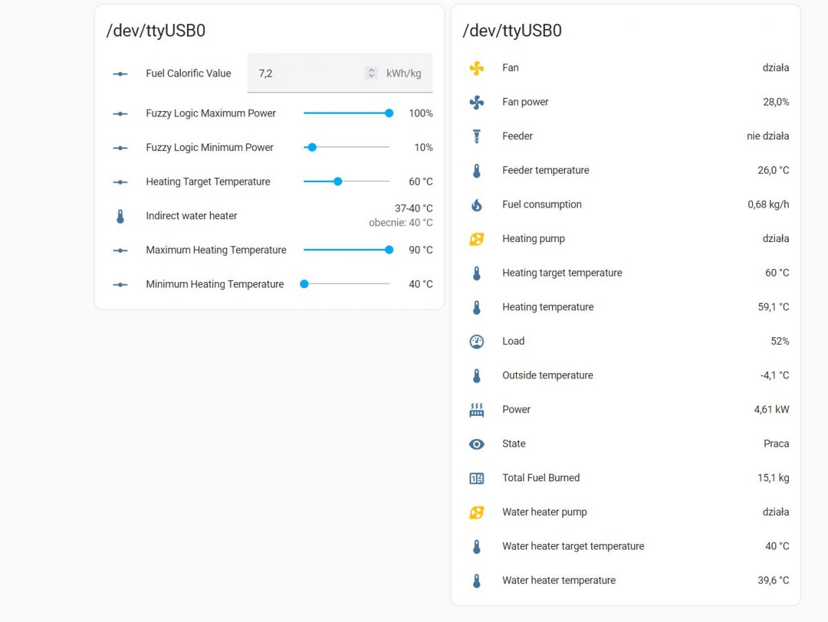

  • #440 20347855
    damianpiechocki
    Level 4  
    I ordered RS485, let's see what will show on ecomax 860-P3.
    RS485 with all...... link
    Connected to module A port G4 (not G1 - there is a display in the oven on it)
    Update 26.12.2022 - these are the parameters, part is from the menu, I hope it will come :)

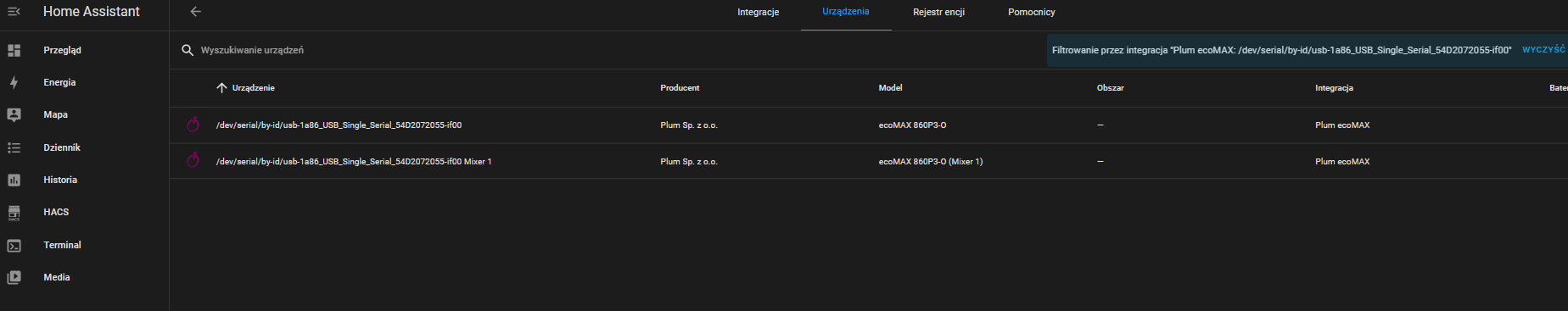

  • #448 20354983
    damianpiechocki
    Level 4  
    funraa wrote:
    Are you sure it's this version? Because in the title of the auction for all .. there is a SKU symbol: 17286 and this is the version with the "fdti" chip.
    I have a cheaper ch343g - yes, at the auction, maybe they gave the wrong description
    Added after 7 [minutes]:
    funraa wrote:
    HA placed on Dell Wyse with linux, specifically on VirtualBox with HAOS and HACS.
    I'm trying to add Plum EcoMax integration and connect via /dev/ttyUSBO (my USB to RS485 converter connected to G4 port on module A)
    and unfortunately I can't establish a connection, I get an alert: "Connection timed out".
    The VPC drivers are in the linux kernel and I can list the converter.
    Previously, I tried with the Elfin EE11 converter, also without success.
    What could I have missed?
    Has anyone managed to integrate in a similar hardware setup?
    I will be grateful for all tips.
    For me it is like this in all hardware and you need to add as in the second line below after your id (for me /dev/serial/by-id/usb-1a86_USB_Single_Serial_54D2072055-if00), not after ttyACM0:
    ttyACM0
    ps. i bought it on FTDI and it works the same, only it sees it as ttyUSB1

  • #450 20360143
    damianpiechocki
    Level 4  
    I confirm the stability of operation on the system FTD232 , on CH343 does not read after turning off and on the stove. You need to restart the hardware.
