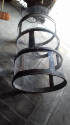

    Due to backyard earthworks and a lot of stone in the ground, the need to build a sifter arose. The inspiration came from youtube videos.
    The frame was made of angle bar 40. The screen proper was made of welded mesh (1x2m) with 12x12mm meshes made of 1mm wire. The mesh was fixed to the bicycle rims (62cm inside). The shaft is a 3/4 inch tube mounted on 2 bearings, ''spokes'' made of 6mm wire. Motor from an old concrete mixer of about 500W 1420rpm.
    The sieve rotates at approximately 50 rpm. At higher speeds, the centrifugal force is too great and the soil 'sticks' to the screen.
    The whole thing may not look like much, but it meets 100% of the design requirements. The cost of construction, due to some elements, did not exceed 200zł.

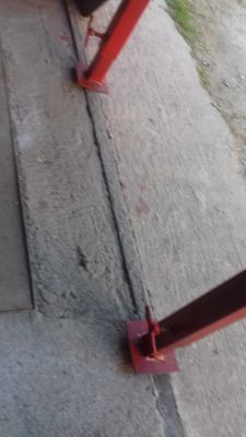

    It took me a while but finally I assembled my drum screen. The assumptions were similar except that I did not want to have an axis throughout the entire length of the drum.
    Short description:
    The motor from the washing machine, old holey barrel with cut out holes, welded mesh, wheels from a baby stroller, scraper from an old bicycle, some V-belts, a reduction roller, some steel profiles partly bought (for legs).
    The most important thing the author mentioned is the final drum revolutions. In the Master's movie I calculated some 55-56 rpm and I initially got 71 and it would be ok for the clinker but for screening composted soil it was too much. At the end I got 49-50 rev / min and that's ok.
    Rotary sieve for DIY soil. Rotary sieve for DIY soil. Rotary sieve for DIY soil. Rotary sieve for DIY soil. Rotary sieve for DIY soil. Rotary sieve for DIY soil. Rotary sieve for DIY soil. Rotary sieve for DIY soil. Rotary sieve for DIY soil.
    I added a few more amenities - adjustable feet to set the drum angle and transport wheels. The cost of materials that I had to buy was about PLN 350, the rest was around the house.
