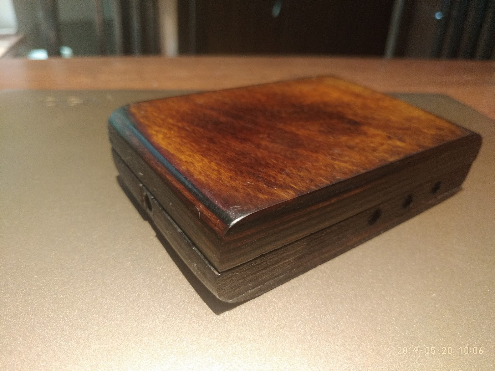

    I had a problem with the drivers, the arduino IDE requires other than avrdude - and here I had a zon. the ZADIG application to replace drivers helped - otherwise windows 10 defends those installed as independence.
    I installed Atmel (I had little space for ssd but cleaned a bit) - I'm struggling with compiling sources from the German site now, wanting to burn the latest version, probably 1.35 (component tester)? for logic it should be compileable - but I know atmel studio .. 10 minutes in total. and I'm struggling with some stupid "warnings" about the lack of access to files, which by the way, I added manually - but don't worry .. I'll pick it up in my free time. But AVRDude had no trouble making a copy of the software I had before - possibly going back to the previous version. Here I wanted to strengthen the transistors / I have to pair a pair with 20 ... and with zener diodes - because you can not buy 1% 5.1V 0.5W - I ordered 50 pcs. 5% and I will look for raisins. However, this Soviet soft Khazama AVR - helped a lot, confirmed the correctness of reading atmega 328p from the LCR T4 board - I knew that I had communication compliance.
    after analyzing "component tester 1.35m" config / make - I'm too thin to try to configure these files for LCR-T4
    it has its own hardware platform, rotarry button's although a skilled person would be able to do it.
    UP this soft is 1.12k - 1.13k electrodes - and after loading it works great / there were no problems with uploading.
    - sometimes / sporadically USB AVR may hang after uploading one file - this is signaled by both LEDs lit (as if the session has not ended - while AVR Dude writes that "done". Just turn it on and off, from the usb port and upload the second file.
    after the photos of my LCR-T4 below - I don't know if yours often "flies" to the floor.
    modifications :
    box - sits deep enough that the lever from closing the pins does not fall out.
    regulator 7809 in the box - gives a stable 9V from the power supply because it consumes the battery quite quickly
    3x 4mm banana pins on the front panel
    I'm just waiting for the hinges or considering closing with a neodymium magnet.
