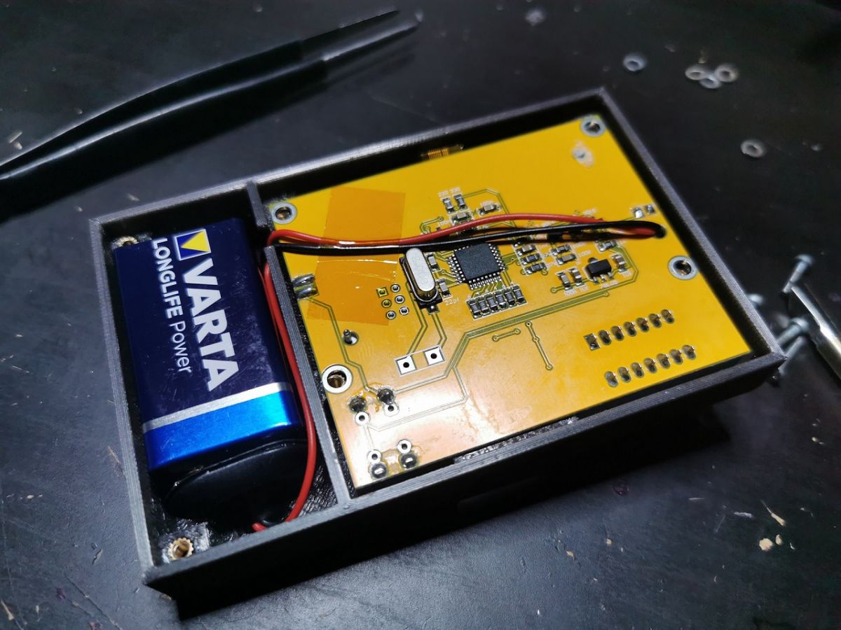

  • Compact 3D-printed enclosure for LCR-T4 M328 tester
    #72 19893731
    moon09
    Posts: 287
    Rate: 54
    If anyone would like to, I provide a housing model for the above-mentioned meter by me. A little more compact and according to me more comfortable than the original. Inside there is space for 2.5mm threaded brass inserts. Screw length 10mm. Models (housing and lid) in STL format, packed in a zip. I don't know if it's a good place, but I'm not going to start a whole new DIY topic for that kind of crap. Maybe it will be useful to someone.
    Change of the firmware of the LCR T4 M328 element tester from the elektroda.pl g Change of the firmware of the LCR T4 M328 element tester from the elektroda.pl g Change of the firmware of the LCR T4 M328 element tester from the elektroda.pl g
    • LCR-T4_Obudowa.zip (72.41 KB) You must be logged in to download this attachment.
