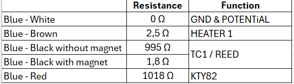

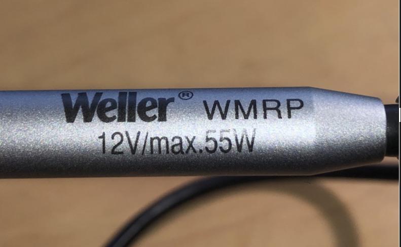

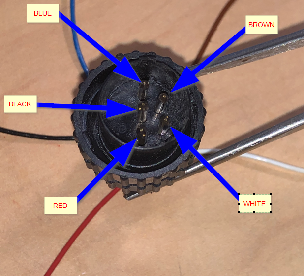

    My problem: I got a new WMRP and I made the subject board. When I connect the WMRP to the PCB it is not recognised: "nc" on the display. However, it heats up non-stop (I limit the current for tests by using a laboratory power supply).
    Strangely enough, my connector doesn't match, but multimeter measurements have enabled me to validate the layout.
    Here's what I found:
    Weller WMRP soldering iron tip labeled 12V/max. 55W
    Close-up of a connector with five pins and attached wires of different colors: blue, brown, black, red, and white.
    Table showing resistance values and functions for different wire color combinations.
    So it looks like there are different pin-outs?
    I've also noticed that at the TP1 test point I'm not getting the 2.048V I was expecting but 0.75V.
    Can you help me understand why the tool is not detected and why the reference voltage is not present because the programme is a complex one for me, especially as I don't know the CCS environment at all.
    The +5 at the output of the regulator is OK, the components come from RS or FARNELL (no Chinese fakes), PCB manufactured by JLCPCB.
