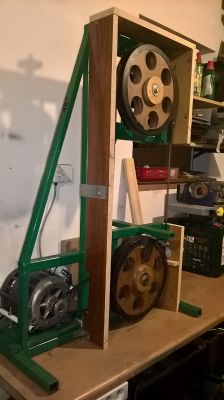

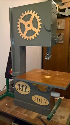

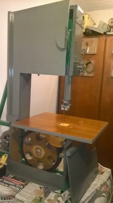

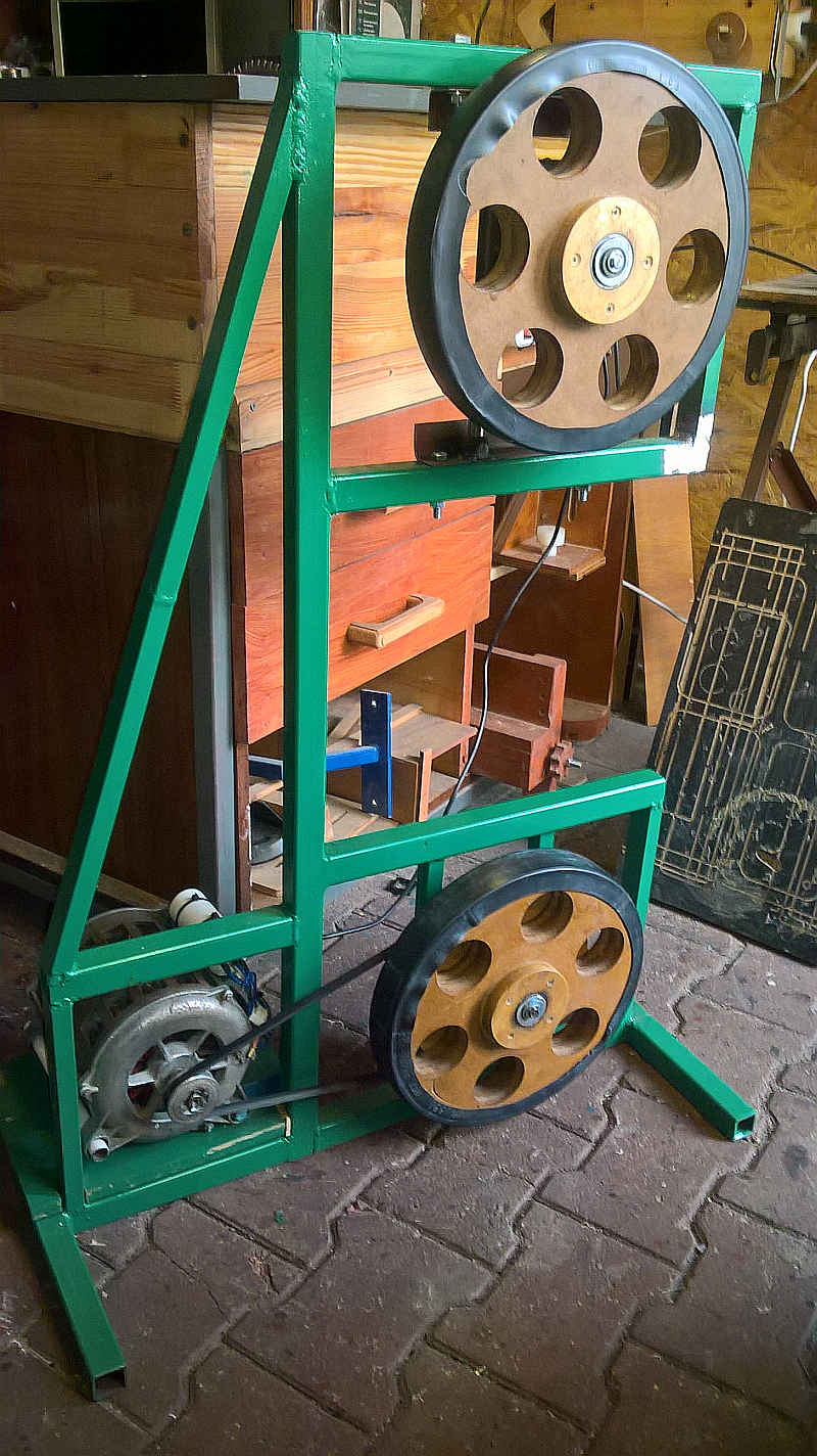

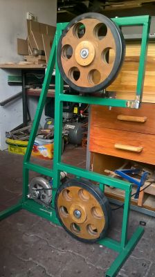

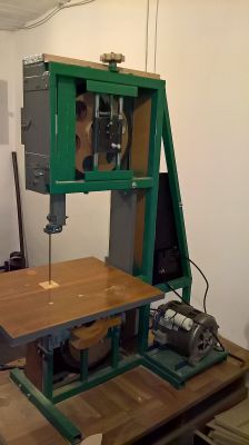

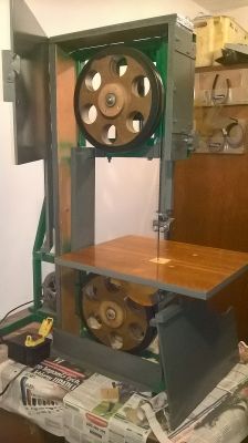

    I would like to present a self-made band saw. The assumption was to use the material that was already in the workshop, left over from various other works. This assumption was almost fully met, except for the saw band and inner tubes for a small bicycle. I will not describe too much, because the photos probably best reflect the entire construction and execution of the saw. Personally, I am very pleased with the effect and usability of the saw itself, as well as the fact that I used a lot of different things that were left in the workshop
    I invite you to watch and comment.

    I gave a plus because I like the design very much. Does the saw fall off the drive wheels?

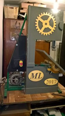

    I have repaired similar meat cutting machines. You have almost perfectly transferred the solutions to your workshop. I'm impressed. You can see that the saw has quite high teeth, so you don't cut the metal?
    I do not see an emergency "mushroom". There is also a lack of a brake on the motor, but you don't need it that much.
    The disadvantage of such solutions is quite a large ratio of the diameter of the pulleys to the diameter of their bearings as well as the abrasion of the pulleys themselves at the point where the saw is supported.
    I give you a plus!

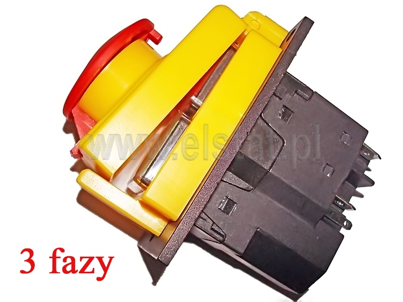

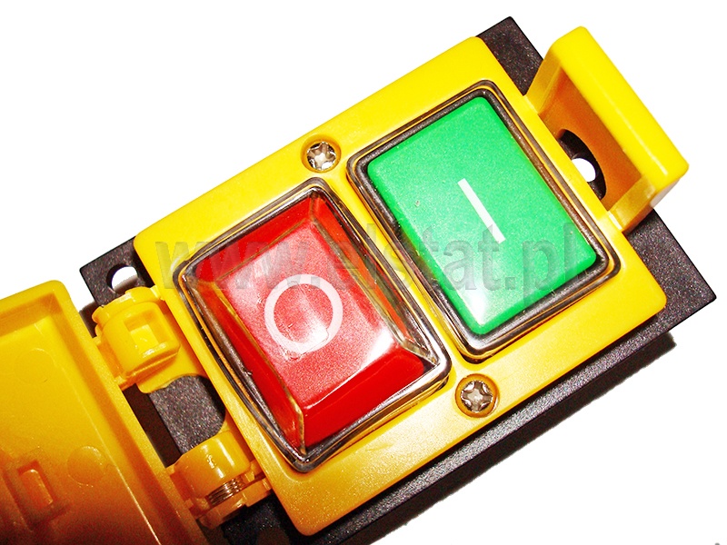

    The only thing I miss in the construction is the safety button to turn off the saw or, if necessary, turn off the saw + actuation of the mechanical brake that will stop the saw blade.
    Unless the button visible above the engine makes it, but this one is probably normally on / off.

    mr_grabarz wrote:
    The only thing I miss in the design is the safety button .....
    This is an on / off button, but also a safety mushroom. Just a bit far away.
    exactly :)
    the rest as I wrote:
    and the second thing, ok, he will cut the power to the motor, while the stopping time of the saw is another matter :)

    The frame is not too slender by chance? A single section of this length ... plus saw tension and additional cutting loads - no tendency to transverse vibrations?
    Thanks for the plus. The saw has never fallen.
    The main section has a fairly thick wall and ensures sufficient stiffness of the structure. Nothing trembles.

    Thanks for the plus. a saw intended for a tree, but you can always change the saw band itself and cut metal. As for the rest, time will show what will be the durability of the individual elements of the saw.
    The safety button is, it's that red mushroom on the left. There is an integrated switch with an emergency stop in the form of a mushroom.

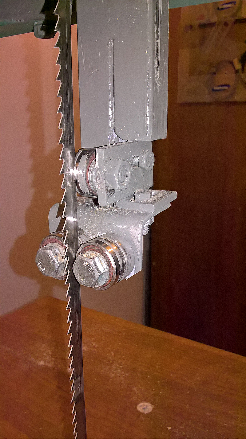

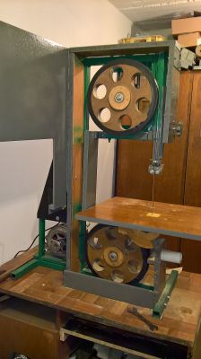

    When it comes to a cutting band, a large tooth does not mean that it is not suitable for cutting metal - a "large tooth" is used for cutting solid material, aluminum, wood.
    Smaller for cutting thin-walled profiles.

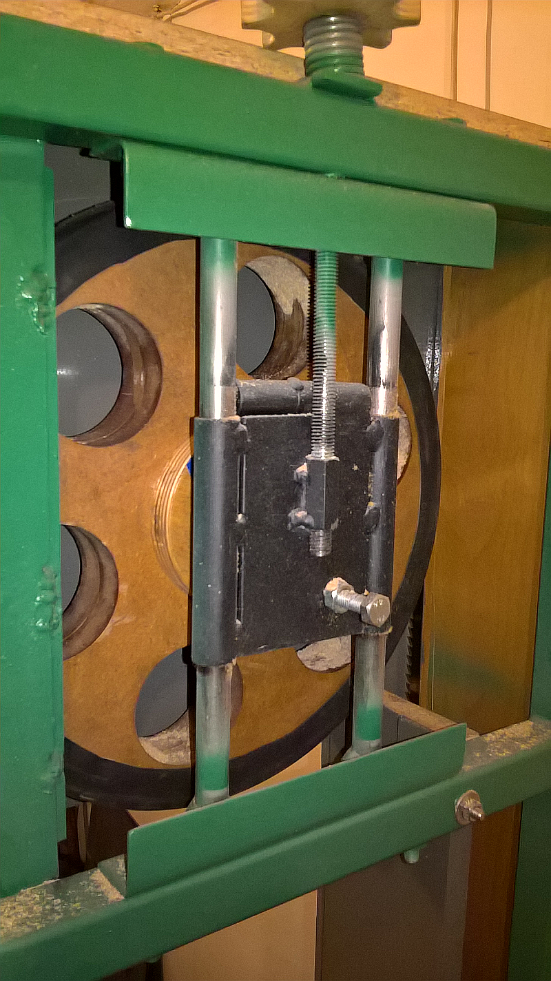

    I am attaching two photos of steel cutting saw solutions: a band guide (adjustable with widia plates) and a wheel.
    Bandsaw from what was in the workshop Bandsaw from what was in the workshop
    If there is a need to choose the right tape or part, I am here to help.

    Hi
    Cool design, I like it.
    However, I would make a cover for the engine, because in some time it will be full of sawdust or shavings, and he will not like it :)
    greetings

    As I wrote earlier, the motor will soon be replaced with a stronger one and in a full housing, because this one is a bit too weak.

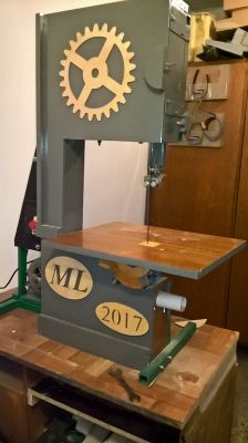

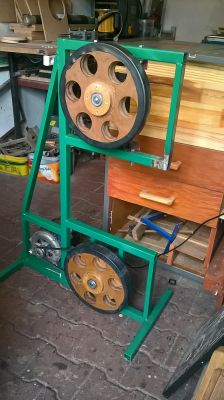

    Please tell me what power this engine is (to know how much it is not enough) and what power you plan to change to.
    What revolutions do you have and what you will have, plus more or less the gear you used. I really like your design and I would like to do something similar, I would like to know what engine I need to look for and what speed and gear ratio to use.
  • #14 17007109
    misiek1962
    Posts: 44
    Rate: 194
    This motor visible in the pictures is about 300 W, I plan a 1 kw motor. Typical engine speed, i.e. about 1440 revolutions.

    OKAY. In that case - a plus. However, I would transfer this "mushroom" to the front wall above the cutting field. Easier accessible - and if it is to be a safety switch, it should be within reach.

    I gave + for commitment, but what happens when (don't give "Mr.") the cutting tape breaks?
  • #18 17007601
    jalop
    Posts: 771
    Help: 40
    Rate: 204
    Breaking a saw is nothing like that. It will just stop cutting.

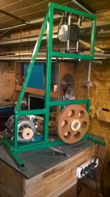

    I dare say that this saw only cuts cardboard. A two-speed motor from an automatic washing machine was used - probably not even 200W, at a rotational speed of 2800 rpm - the saw can at most speed up empty and also quite reluctantly. This one. The second - the saw drive wheels themselves - with any tighter tension, chips will fly out of the rubber. So I would love to see this machine in motion

    You can cut everything that is wooden, plastic, I think that soft metals such as aluminum and brass will not be a problem either. For steel, it is probably not due to the lack of cooling, although small details would probably also be fine to cut. Of course, you would need a different tape for metals.

    As I wrote earlier in the days the engine will be replaced, this one was only for the test how it all turns. The test is passed so the machine will get a bigger engine and it will be ok. This one is actually a bit weak. as for this rubber, contrary to appearances, it is very durable. I watched a lot of DIY constructions of such saws on the Internet and in most cases this is the solution. Simple, cheap and effective.

    A great machine, if you want to improve it, look for 'sawmill wheels' on the Allegro - cast iron, milled for a poly V belt.
    The belt is hard to stop suddenly without damaging it (wheel inertia), in machines of good companies, an electric brake is used, but also before it works, a cut finger.
    To cut steel, you need a bimetallic strip and significantly slow down the speed, plus coolant.

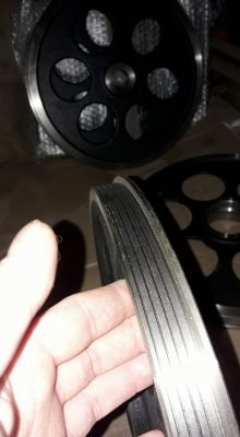

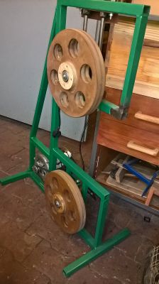

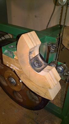

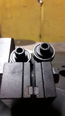

    Buddy, what did you make the bearing seats from? How did you "align" the wheels? Are they balanced?

    The bearing seats are made of plywood, the wheels were cut on a cnc machine. After gluing, everything was turned on an improvised lathe.

    I thought so, I think we watched the same videos on youtube ... :-) And did you balance the wheels? Have you counted the revolutions to the speed of the belt? Wheels from what I can see, mdf?

    I didn't count the wheels, I used the dimensions found on the net. The wheels are made so precisely that any beating is very small. The whole saw works very evenly and quietly. Wheels made of mdf.
