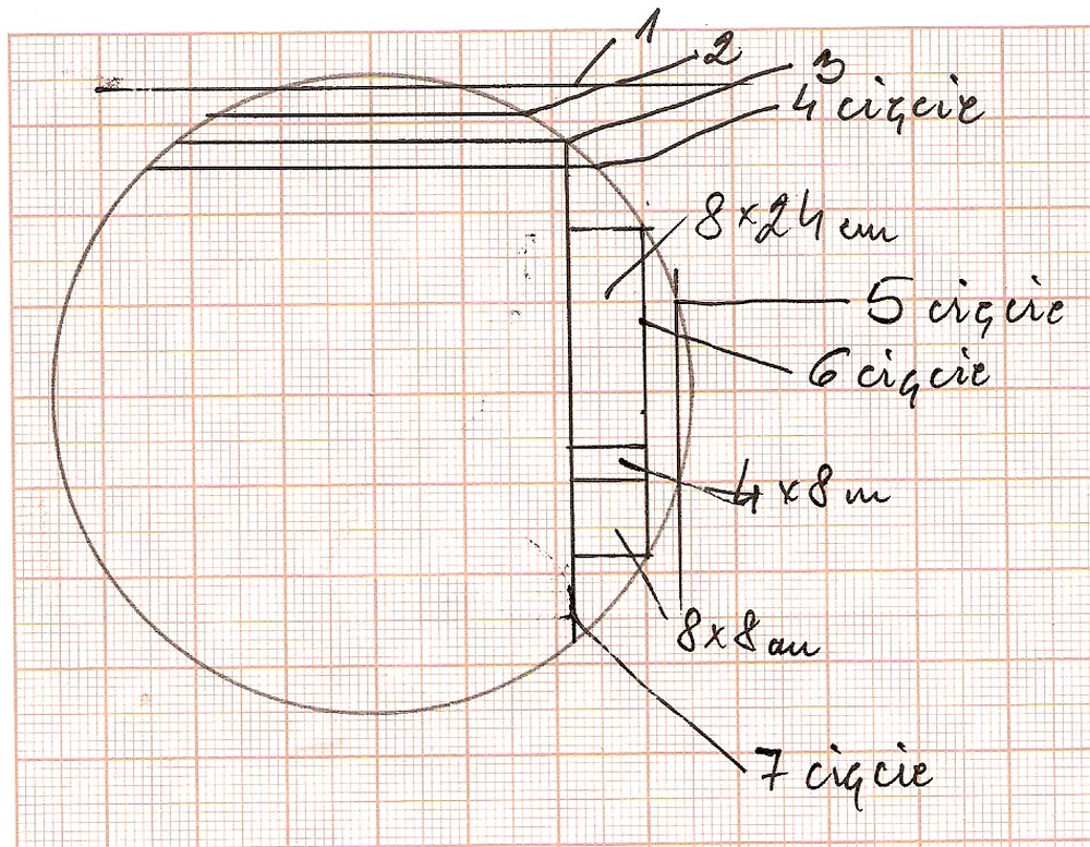

    #22 7953260
    marcingeneral
    Posts: 37
    Rate: 126
    You are right with the cutting height. For me, there is 22cm clearance above the tape. However, I think that I can edge the round timber and cut the rafters, e.g. in thickness.
    I know, I know, and what if the tree's cross-section is greater than twice the value of the light between the beam and the strip? Chmmm ... It remains to remake the sawmill to increase the ground clearance or:
    Suppose I have a 70cm tree and I need 8x24cm rafters. As you already know, even if I cut a log into 8 cm slices, to get the size of 24 cm I will make a lot of waste or if you prefer material for other things such as patches.
    Honestly, I am not worried in advance because I think that I will not get such large logs for my needs and I am not going to make material for roof trusses. The sawmill is to be used for rubbing small-size round logs into boards and logs. It will not be used for commercial purposes only for personal use.
    In a way, your attention is most accurate and the workmanship of your machine is excellent. If there is a need for some arrangements, I will contact you.

    Cutting a thick log is not a problem.
    In the attached drawing I have scribbled an example of how to cut a ?70cm log. Band sawmill, horizontal. 4kW belt drive.
    After making cuts 1, 2, 3 and 4, you turn the log by 90 ° and further cut it on the board. You can also cut it to a thickness of 8 cm and then cut out a size of 24 cm.
    Then you turn the log again and further cut the boards or patches. Then one more turn and you get the intended square or rectangular section.
    At the end, you are left with a beam, e.g. 40 / 50cm, and you cut whatever you want from it, and you also have use from previously cut boards.
    I don't know what detail of the track you are interested in.
    In the photo with the head, you can clearly see how I solved them and I recommend this track solution with a clear conscience. Well, maybe it is still worth cutting the bed beam to make it easier to roll the log onto the bed.
    On the other hand, the fastening of the log is completely primitive and prototype. It did a good job, but they still need to be tweaked and maybe even changed.
    Maybe tomorrow I will show how I made this makeshift, but I would like to point out that this is not the final patent.
