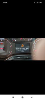

    Hello. The patient opel combo e 1.5 bluehdi Peugeot Citroen - Supplement AdBlue in the PSA group control UREA Peugeot Citroen - Supplement AdBlue in the PSA group control UREA Peugeot Citroen - Supplement AdBlue in the PSA group control UREA
  • Adblue additive cleared P20E8 after repeated dosing

    #139 19645199
    Luck_as
    Posts: 38
    a year ago my combo e crashed this message, aso adblue sensor replacement under warranty, after 3 months. the same - erase the error under warranty
    the next 3 months the same - erasing the error under the warranty, after half a year the same - erasing the error adding 3l adblue - aso after the warranty PLN 183 gross ....
    when asked if I would happily drive to ASO for half a year for less than PLN 200, they could not answer ...
    I refuel with adblue from the distributor at the station besieged by trucks
    weekly about 1000km mileage, the message that further start-up after 1100km is impossible slightly "annoying" sometimes I may not return to the cottage :(
    after reading this thread, I start in ...

    #149 19817226
    JacekMatuszak
    unfortunately, like most PSA users, I have a problem with the SCR system.
    First symptoms:
    after buying the car this year, after driving about 1500 km, the UREA message, add urea (the car will be blocked after 3000 km). I think OK, I'm going to add AdBlue ... Unfortunately, after opening the cap, I saw a mirror of the liquid (I tried to pour AdBlue, I ended up refilling 0.3 liters.
    Of course, the bug did not go away, so I did the procedure from the first thread.
    Being aware that this is not the solution, but the messages are gone and everything worked fine.
    Unfortunately, recently UREA + SERVICE errors (damage to the exhaust gas treatment system) appeared after a while ENGINE (engine failure ...).
    And countdown of the counter (the car will be blocked in 1100 km)
    After connecting the diagbox, errors appeared ... P20E8 00 (urea fluid pressure) and U059F 81 (Communication fault with the NOx system).
    Currently, errors have been deleted and messages have disappeared, but nevertheless the problem is bothering me.
    I have carried out all the available tests in diagbox regarding the DENOX system. what i found:
    - after the engine is warmed up - the pressure in the NOx system is about 5.6 bar
    - Bleeding - error too fast bleeding
    - unfortunately, I did not have the opportunity (yet) to disconnect the injector and verify that it actually injects urea during the test, but I ran this test and you can hear both the pump (it builds pressure) and the injector can be heard.
    Unfortunately, the error I encountered is the lack of information about the amount of AdBlue (as if the level sensor did not work).
    Has anyone had a similar case ??
    Additional and very important question ...
    If this error (UREA + SERVICE + ENGINE) reappears, then the number of kilometers to be blocked will be 1100 km, or is the clock somewhere in the memory still counting these kilometers? and it may happen that another error will tell me that there are 200 km left to block ???
    Thank you in advance for the hint.
  • Counter resets to 1100 km after clearing fault
    #150 19826171
    baczynskim6
    If this error (UREA SERVICE ENGINE) reappears, then the number of kilometers to be blocked will be 1100 km, or is the clock somewhere in the memory still counting these kilometers? and it may happen that another error will tell me that there are 200 km left to block ???
    If the car "catches" an error, e.g. P20E8, the counter starts to tick from 1100 km. In my case, I drove up to 30 km and warned against engine immobilization, after deleting the error and possibly catching another error, the car starts counting again from 1100 km. So cool.
