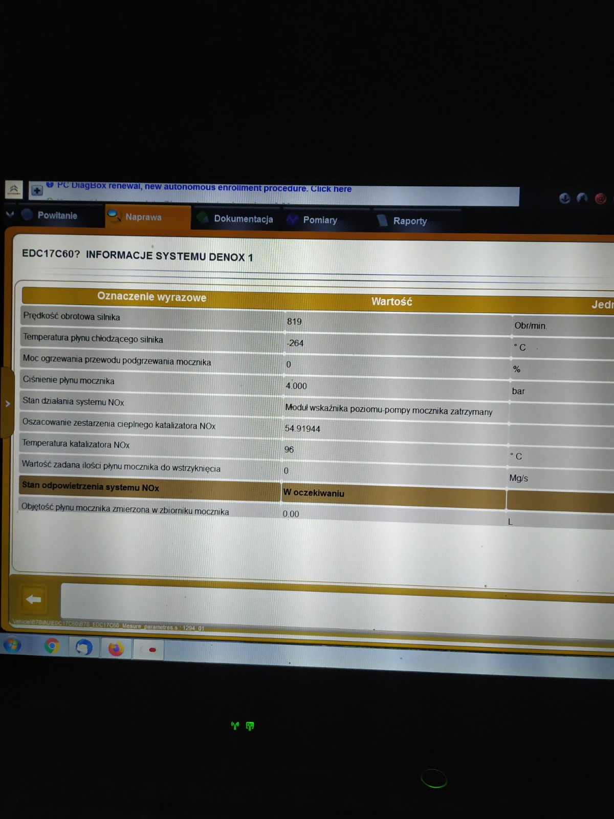

    lucas-007
    Posts: 8
    Rate: 7
    Hmm ....
    tomorrow I will come over to him and ask him to check.
    Ps.
    Can error P20f6 indicate a problem with the adblue injector?
    Update 20.11.
    below I paste photos from the diagnostic program. Pump pressure 4 bar. We did some system tests, here are what errors it crashed. Please comment.
    • Peugeot Citroen - Supplement AdBlue in the PSA group control UREA IMG_20201119_181158.jpg (304.44 KB) You must be logged in to download this attachment.
    • Peugeot Citroen - Supplement AdBlue in the PSA group control UREA IMG_20201119_175117.jpg (273.59 KB) You must be logged in to download this attachment.
    • Peugeot Citroen - Supplement AdBlue in the PSA group control UREA IMG_20201119_175304.jpg (170.13 KB) You must be logged in to download this attachment.
    • Peugeot Citroen - Supplement AdBlue in the PSA group control UREA IMG_20201119_173713.jpg (215.92 KB) You must be logged in to download this attachment.
    • Peugeot Citroen - Supplement AdBlue in the PSA group control UREA IMG_20201119_172928.jpg (312.14 KB) You must be logged in to download this attachment.
    • Peugeot Citroen - Supplement AdBlue in the PSA group control UREA IMG_20201119_173146.jpg (257.29 KB) You must be logged in to download this attachment.
    • Peugeot Citroen - Supplement AdBlue in the PSA group control UREA IMG_20201119_173042.jpg (266.87 KB) You must be logged in to download this attachment.
  • #86 19056816
    melas
    Posts: 1552
    Help: 138
    Rate: 685
    The temperature of an engine from space shows you well
  • #87 19056844
    lucas-007
    Posts: 8
    Rate: 7
    As I understand it shows the pressure well. (engine temperature is a different story :)
    What about the rest of the tests? Various errors popped up there. What is the starting point? Where to find the fault?
    If the pressure is ok then I understand that the pump itself in the tank is not a problem, but something else.
    Best regards,
  • #88 19065024
    lucas-007
    Posts: 8
    Rate: 7
    Gentlemen, any ideas where to look for a fault based on the above screenshots?
    Thanks and regards
  • #89 19065302
    melas
    Posts: 1552
    Help: 138
    Rate: 685
    I take the whole system apart, I disassemble all the elements, check them on the table, they are actuated, I blow, I will travel. And car tests.

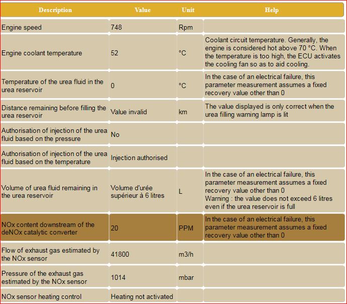

  • #90 19076975
    GLisie
    Hi,
    I connect to the topic of adblue.
    The car is citroen C5 2015 and P20E8 error
    I already have a diagnosis with the ASO - to replace the tank, the cost is known to be high.
    Maybe colleagues will advise something else ..
    I enclose diagbox reports. Some in English because I changed the language later.
    Thanks in advance for any suggestions.
    best regards
    Grzesiek
