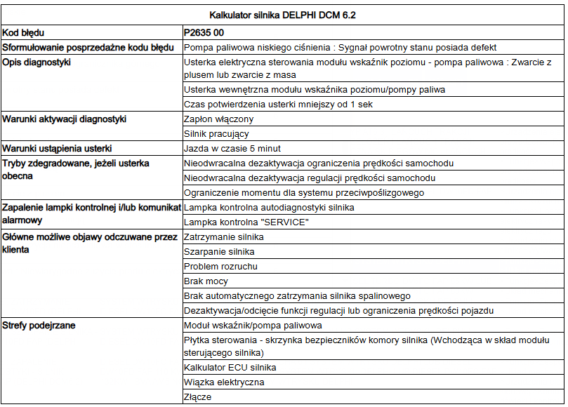

    Hi. Could the P2635 error be related to the AdBlue pump? Thank you.

    robert_m wrote:
    Hello.Could the P2635 error be related to the adblue pump? Thank you.
    Not likely, it's not the pump.
    A table with information about error code P2635 00 in the DELPHI DCM 6.2 engine controller, related to the fuel pump and possible malfunctions.
