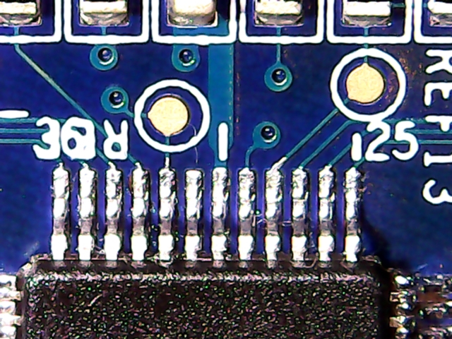

    Just arrived and rather 0.3Mpi, not 3.6Mpi, but you can see well. After connecting to Win10> Camera on 27 "you can see the imperfection of these Mpi and some distortions, but practically no delay. Expensive to work on the 4mm * 2 field of work, you only have to wave" 50 "before. it is better to add bent lamps to the eyes.

    You can completely turn off the backlight with this potentiometer from the side, as in old walkmans, only then you can not see anything ??
    It looks much better to use additional lighting on the sides like this
    PACHMET G600 Microscope with 4,3 "LCD - made in china - Test / Review / Des
    This is from mine without brightness adjustment etc.
    PACHMET G600 Microscope with 4,3 "LCD - made in china - Test / Review / Des PACHMET G600 Microscope with 4,3 "LCD - made in china - Test / Review / Des PACHMET G600 Microscope with 4,3 "LCD - made in china - Test / Review / Des

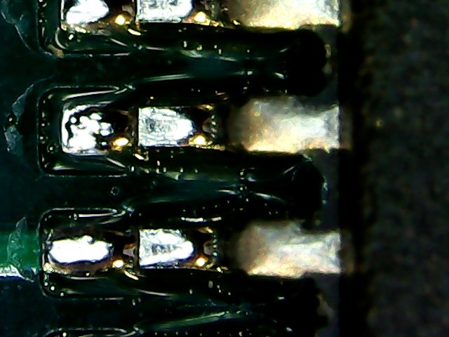

    The photo I promised, how I got it (tripod)
    All in all, this microscope is not that stupid. In any case, a photo can be taken better than with a cell phone because it is magnified.
    And simpler things can be done where stereoscopy is not required.

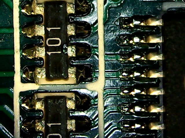

    So yeah. I can say something more because I have tested both. On the occasion of the exchange of Ace on the 15th (Ala ma Asa Asa has Ala - this is an association with a primer from old times :ok: )
    But to the point - to take photos as much as possible. But not with the tripod I got. Here, it is necessary to set the height to a large extent in order to obtain an image with different fields of view. Somehow I managed to put the washers. But that's not the point ...
    For comparison, a photo with a Samsung 5610 in macro mode
