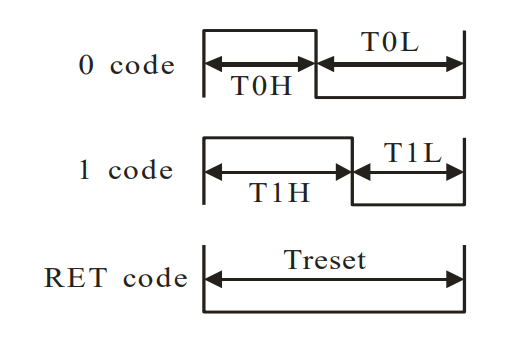

    All control is done via a single digital signal which we feed to the DIN pin of the first LED. The signal sends the colour bits (appropriately coded) sequentially. There are 24 bits per LED (3 bytes - Red byte, Green byte, Blue byte). This means that we can display a wide range of colours, theoretically as many as 2^24 i.e. 16777216 different shades! The specified bits respectively go on until we freeze the output signal in the low state for at least 50us.
    The bits themselves are encoded with the help of applying a high and low state on the pin through the appropriate time.
    In summary, according to the image (from the WS2812 datasheet note):
    PIC18F45K50 as WS2812 LED strip driver (theory+library) .
    - if we want to transfer a bit 0, we set the communication pin to high state at time T0H and then to low state at time T0L
    - if we want to transmit a bit 1, we set the communication pin high at time T1H and then low at time T1L
    - if we want to communicate that we terminate the data transfer (i.e. after this break we can control the LEDs again from the beginning), we set the pin to low state at least for the time Treset
    The times are given in the table:

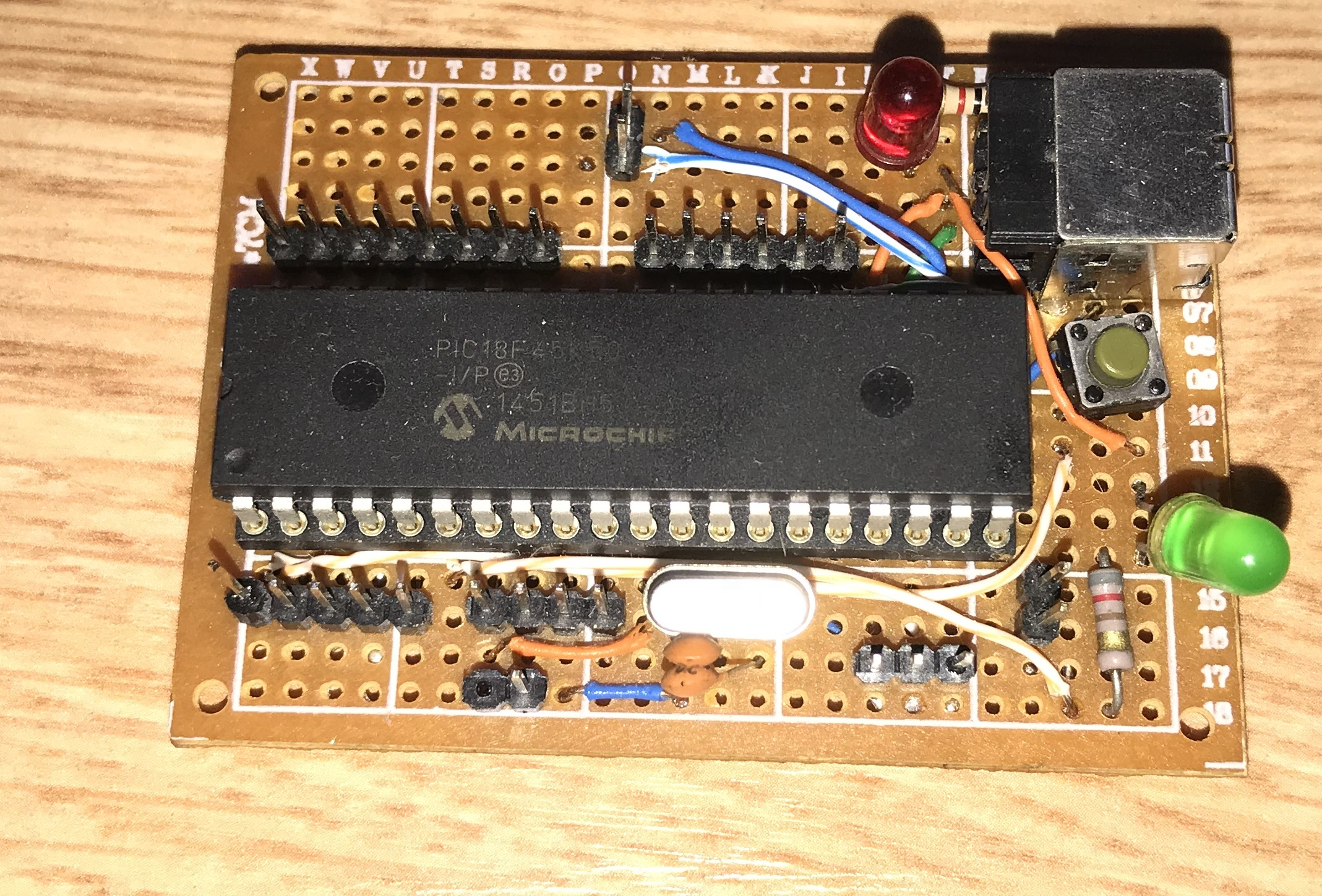

    Used board from PIC .
    For the project I used one of my older boards with the PIC18F45K50 (the PIC18F4550 would also fit here, as the two microcontrollers are almost identical, although the 45K50 version, for example, has a better precision internal oscillator than the 4550). This board has a 20MHz quartz oscillator. Apart from that, it contains only fairly basic components such as a resistor from RESET, capacitors, a USB connector (here only used for power supply), etc.
    PIC18F45K50 as WS2812 LED strip driver (theory+library) PIC18F45K50 as WS2812 LED strip driver (theory+library) .
    I know this board looks the way it does, but it was one of my first designs a few years back. The others were already taken. I've been using so many PICs lately that I think I'll soon make some good PIC18F4550 board for myself, but fully in SMD.

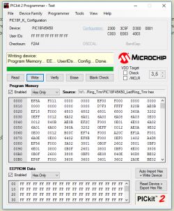

    Screenshot from PICKIT2 during programming:
