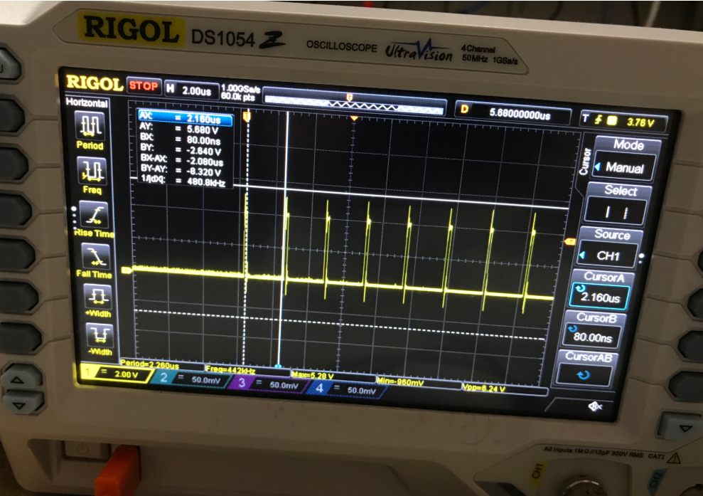

    I fired it up, and:
    Screenshot of an oscilloscope with a signal waveform. .

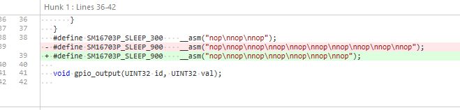

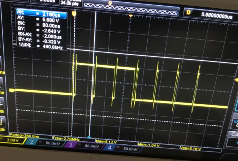

    Everything looked fine, there are 8 pulses, but when I changed the number of commands "nop":
    Code snippet in a text editor with asm macros for SLEEP functions. .

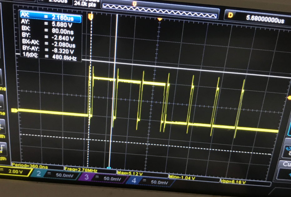

    There was an unexpected, even (apparently) non-deterministic delay and only in part of the pulses? But why? After all, is it eight times WS2812_SEND_T0?
    Oscilloscope graph showing signal pulses for WS2812 LED control. .
    I was a bit puzzled by this, but eventually I began to suspect that the problem was the cache and the way the instructions were being read from flash memory. Probably executing instructions from RAM (called "ramfunc") would also help, but there were difficulties with that too and we eventually decided on the method with SPI....

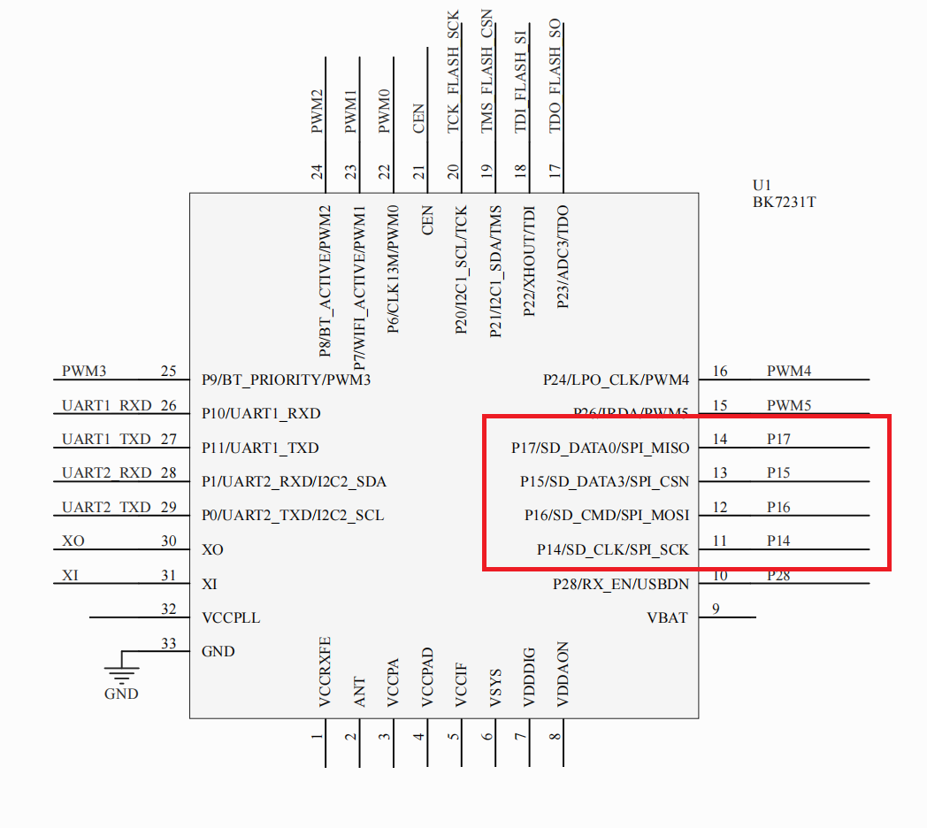

    The platform used here, the BK7231, has one hardware SPI port:
    Details of the BK7231T schematic with marked SPI pins. .
    Using it, the display can be efficiently controlled, for example. But that leaves us with the DMA - what does it give us?

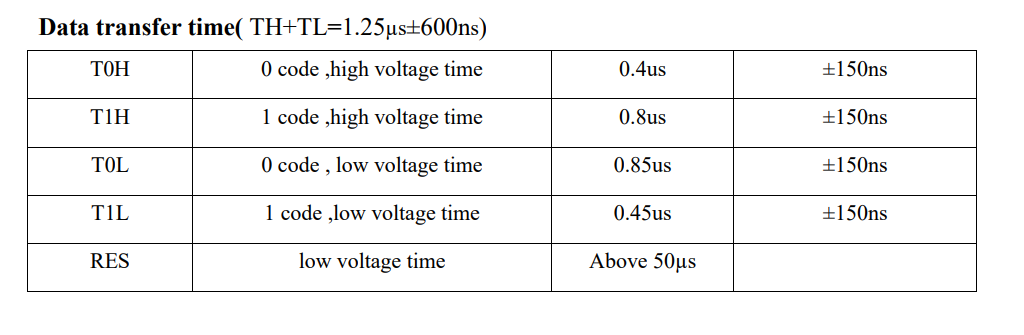

    Let's recall the requirements:
    Table showing data transfer times for the WS2812 protocol. .
    We want to be able to generate each of these signals. So I guess the finest unit of time it needs to have is 0.4us, then simply to generate 0.8us we would use it twice. Alternatively you could also try with 0.3us or similar.

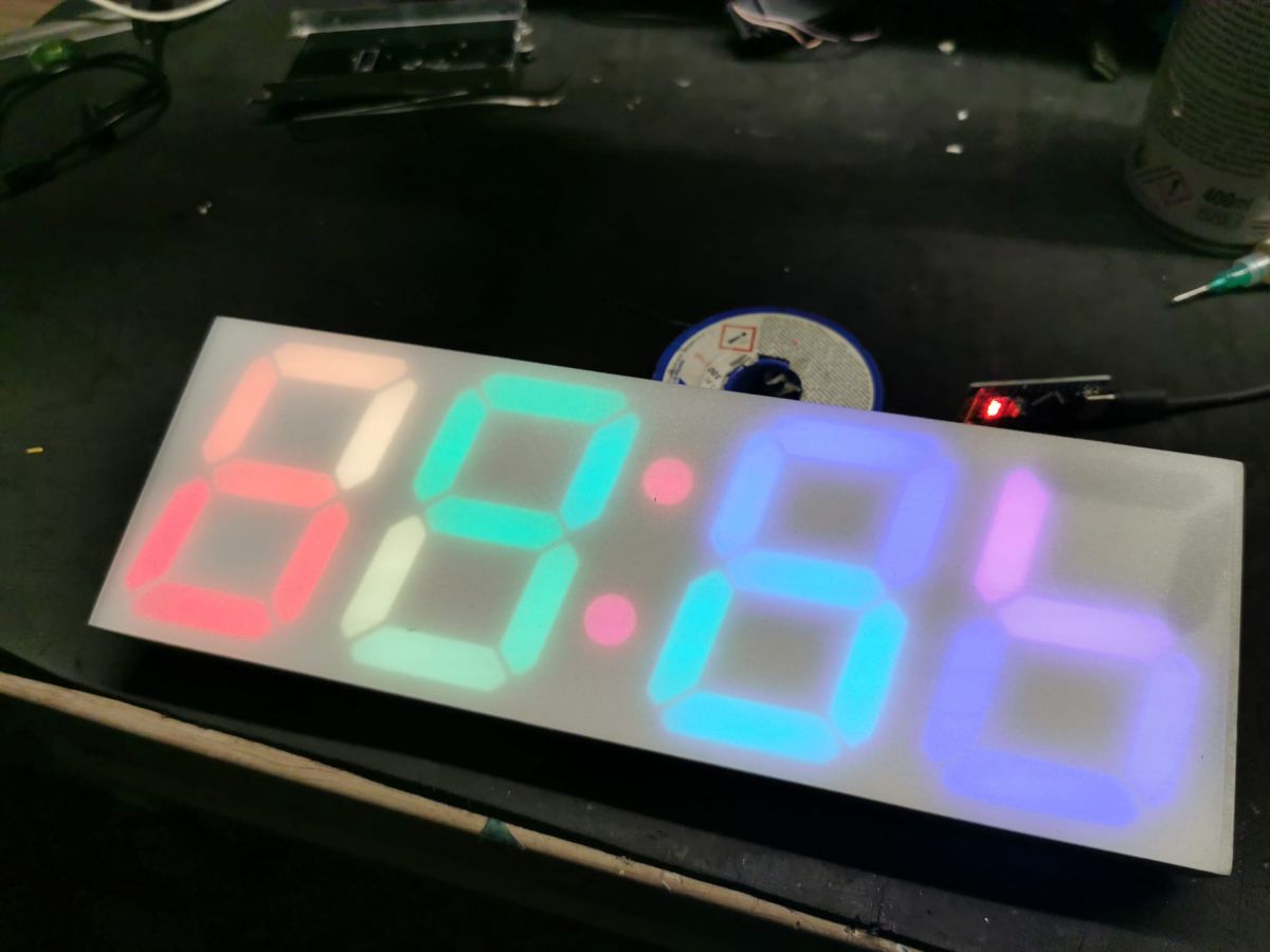

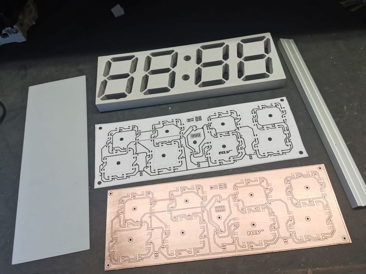

    A nice coincidence as I am currently sitting on a clock on led ws2812:) .
    I can make the project available if anyone would like. I cut the aperture from milky plexiglass obtained from an old TV, the 7th segment was milled from styrodur, and the PCB too. I am in the process of writing the code for the Atmega8.
    Colorful LED clock with 7-segment displays made from frosted acrylic. .
    LED clock construction elements with segments and PCB. .
    Panel with WS2812 LEDs arranged in a seven-segment display shape on a PCB.

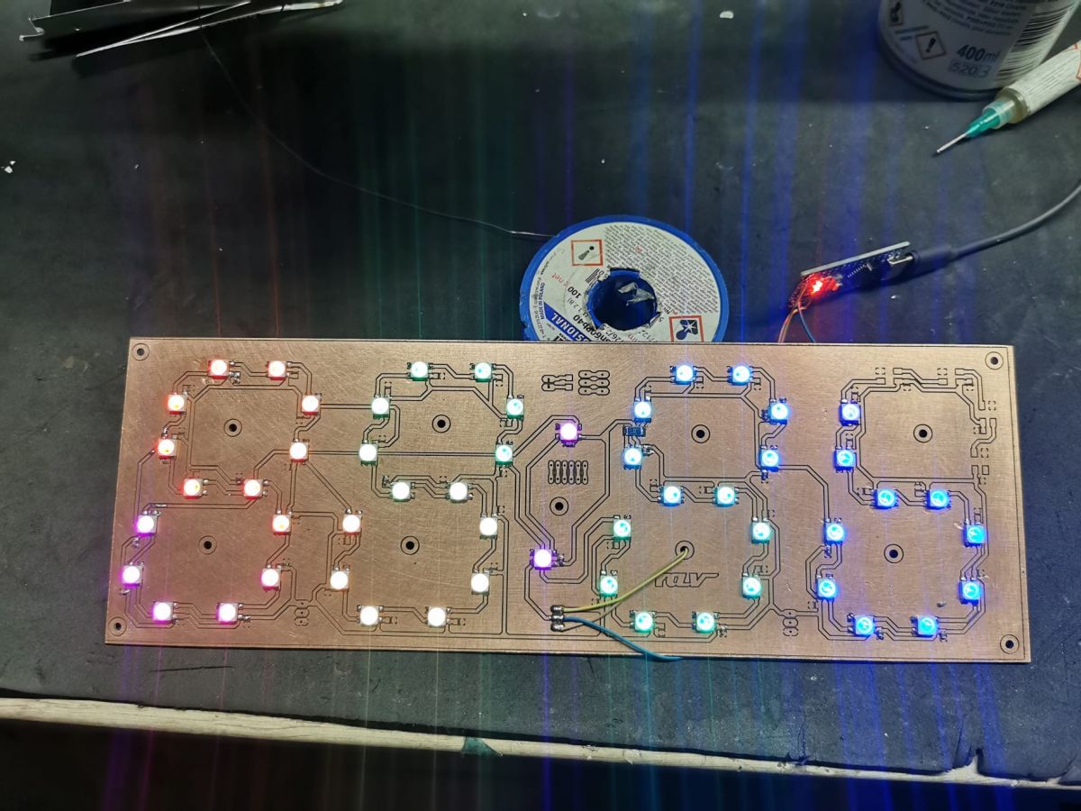

  • #5 21480807
    Posts: 14767
    Rate: 12906
    A familiar sight, I've been through this too, cool project.
    Self-built 7-segment colour display based on WS2812B .
    What are you going to drive it with? If you do, consider posting the whole thing with us in the DIY section on Elekrtoda.
