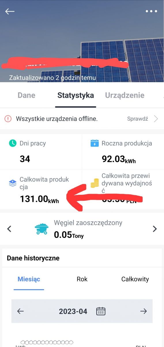

    Rybus85
    Posts: 870

    galica01
    Posts: 220
    Help: 10
    Rate: 47
    Everything indicates that you have already done 131kWh and these 92kWh have been since the application was launched, this is how it works in the sofar. It is always worth while starting the installation to make the app right away so that there are no such flowers. Show the monthly chart for this month where you can see the individual days.
  • #1465 20539282
    Rybus85
    Posts: 870
    Help: 31
    Rate: 65
    And it is impossible. Established at the end of July and has not been launched. Nothing on the charts. The inverter was new. They opened a cardboard box for me. And in fact, it was turned on only for the time of testing by the fitters if everything is ok and that's it. Until the meter was replaced, it was not turned on later, i.e. until the beginning of April. That's why I asked why such strange indications.
  • #1466 20539352
    wddd
    Posts: 46
    When I fired the whole set at the end of March last year, the Sofar 3.3 1f and enjoying the fact that it all worked so beautifully, I checked several times a day how much it produced for me. After a few weeks, when something did not agree, I wrote down how much it produced on that day and the total it turned out that several kWh arrived after the night 😃 (not always and these values were different).
    So I reported this problem to the service, they said that something is wrong with time and uploaded new software. For some time it was ok, and then (as I wrote an earlier post) the inverter did not want to turn on in the morning. When I turned the power off and on, whether AC or DC, the inverter worked properly. Regards
